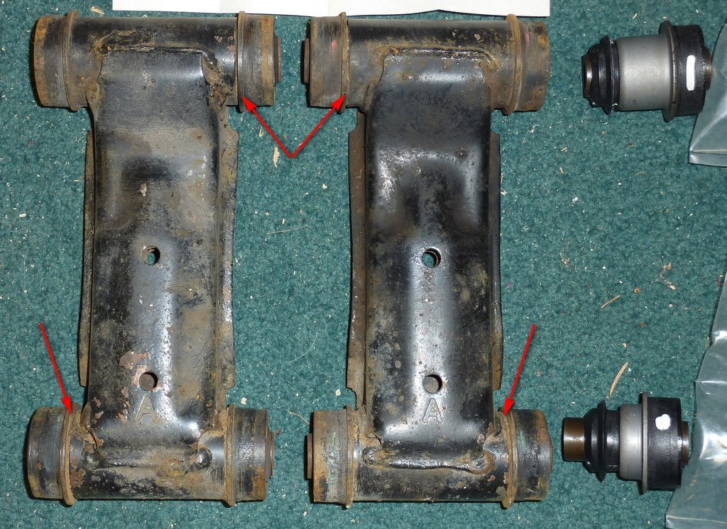

AFAIK the main differences are the placement of the bushes in the arms. There is a small 1mm gap (arrowed) between the bush and the arm. There is also
an offset in the arm to the tube. Side by side you can see this at the top of the picture.

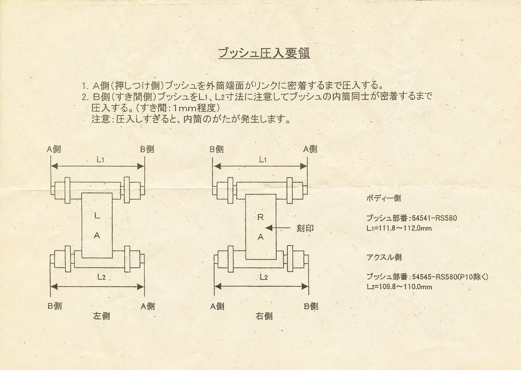

This is also shown in the in the leaflet that comes with the Nismo replacement bushes.
