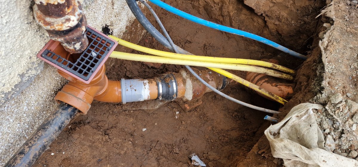

So this is the drainage situation which i dug up last weekend :
As you can see loads of issues that we discovered but who can spot the various types of pipes used.

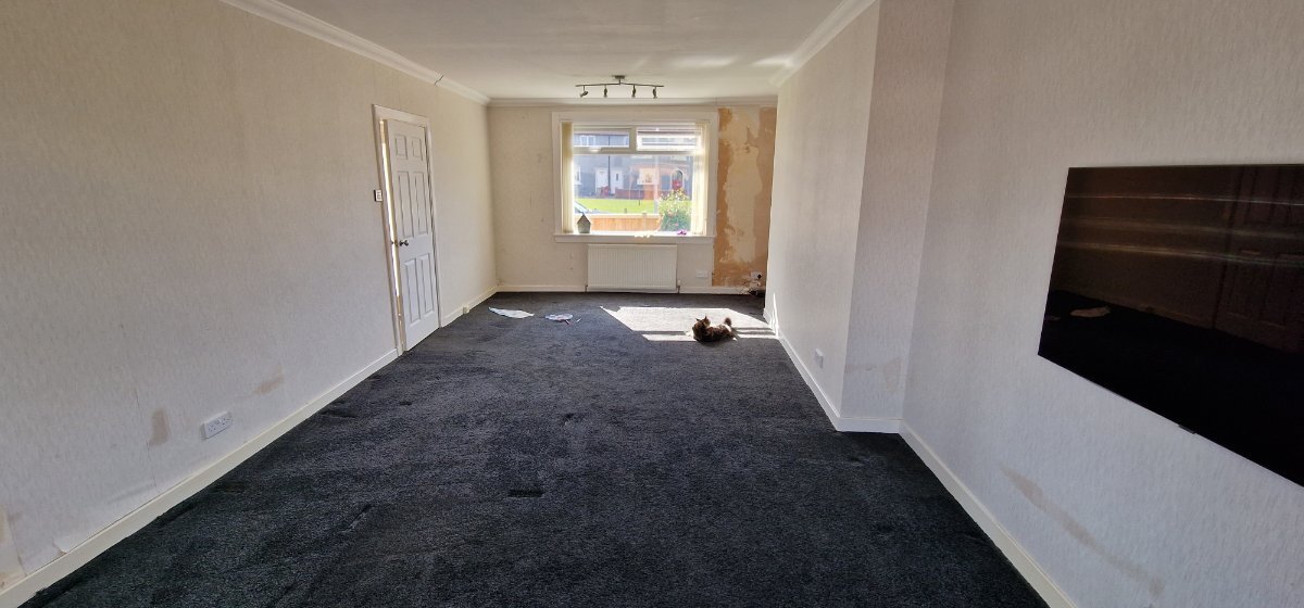

So this was my living room yesterday morning :

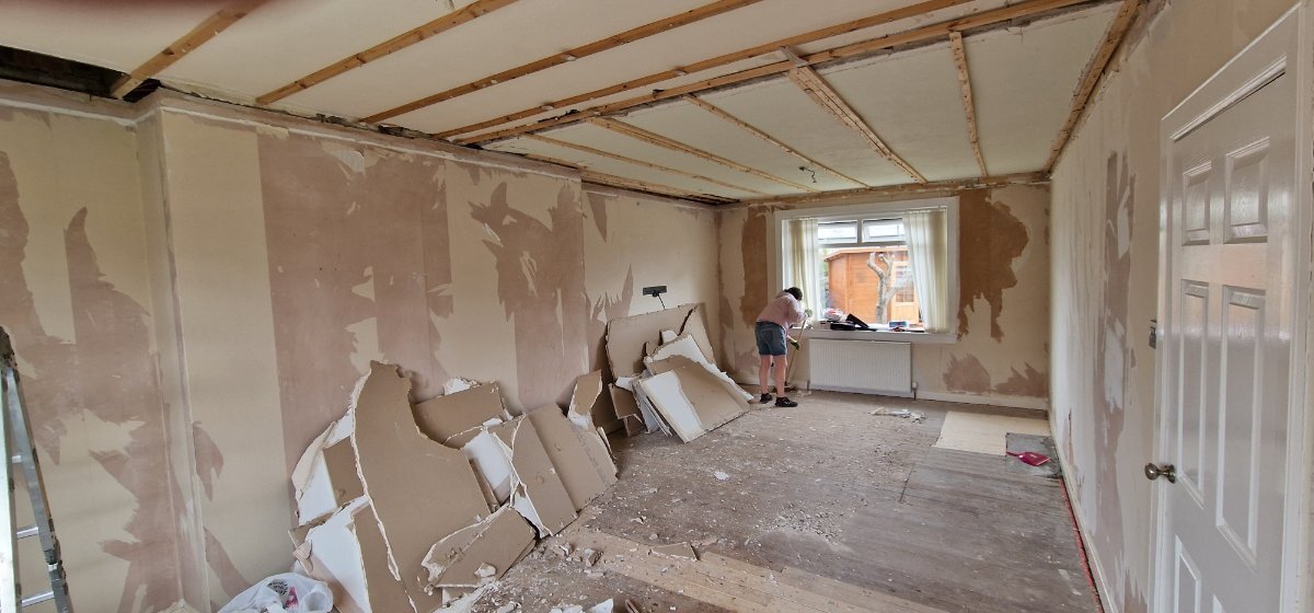

And this is how is looked after the first ceiling came down :

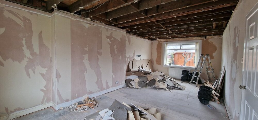

Then a few hours later the second and original ceiling was off too.

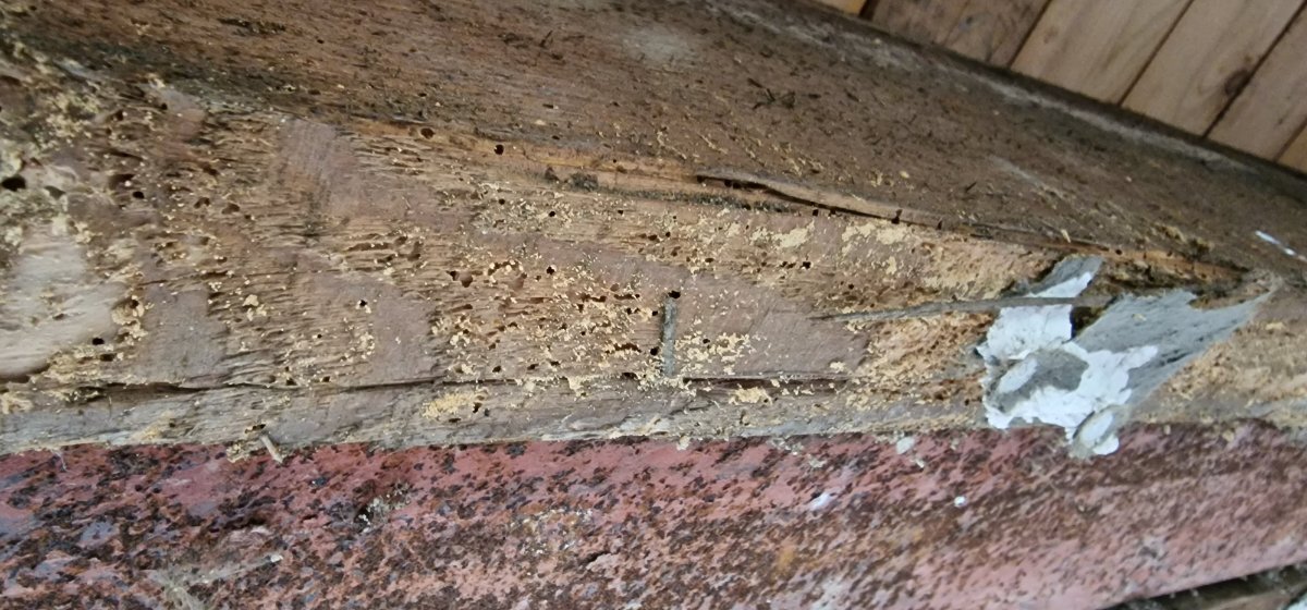

I'm doing most of the building work myself until this morning when i was cleaning and removing the old nails from the timbers i find this :
We have literally opened a can of worms. ?
Seems many of the structural beams have wood worm and although it all looks old and likely dead many of the beams will now need replaced.
And this was not even part of the insurance so bad luck to us i suppose.
Anyone had to deal with woodworm in floor joists and whats the best way to deal with it ?
That drain looks like my last extension builders did it. We're starting a 2nd extension later this year and I'm having to get a significant portion of the ground works from the extension 6 years ago re done due to pure incompetence on the builders behalf.
For woodworm best to get a specialist in to make an assessment and he'll be able to say which timbers can be saved and which need replacing.

Chop it out and put in an RSJ that shouldn't be too expensive
