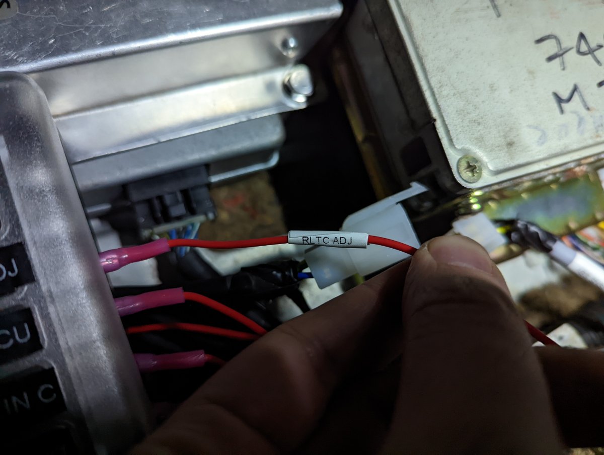

Yes! That caught me out when trying to work out why another RLTC install didn't work. My curiosity was piqued because you had
used 4 core red from the ABS sensor wires to your filter box. That got me thinking...
Anyway, there are 2 variants of Racelogic Traction Control - The ABS version and the self installed sensor version.
"The ABS system is looking for a sine wave from the vehicle's OEM ABS sensors.
The ABS loom has 4 wires which have to be 'spliced' in to the corresponding ABS sensor signal wires.
The wheel speed system is looking for square wave from self installed wheel speed sensors.
The wheel speed loom has 2 wires for each wheel speed sensor, and are clearly labelled FR, FL, RR, RL."

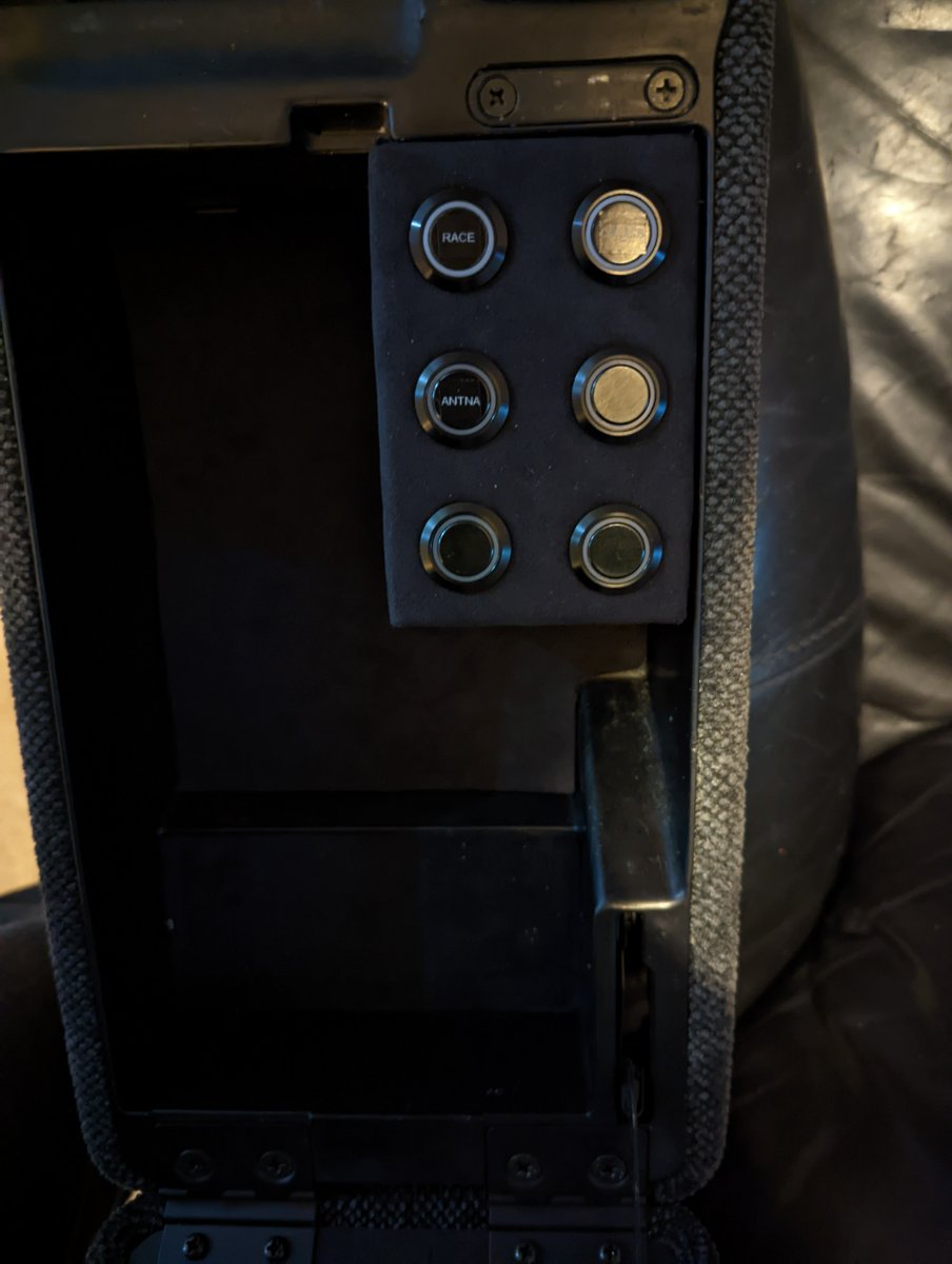

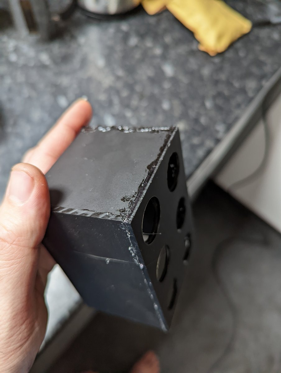

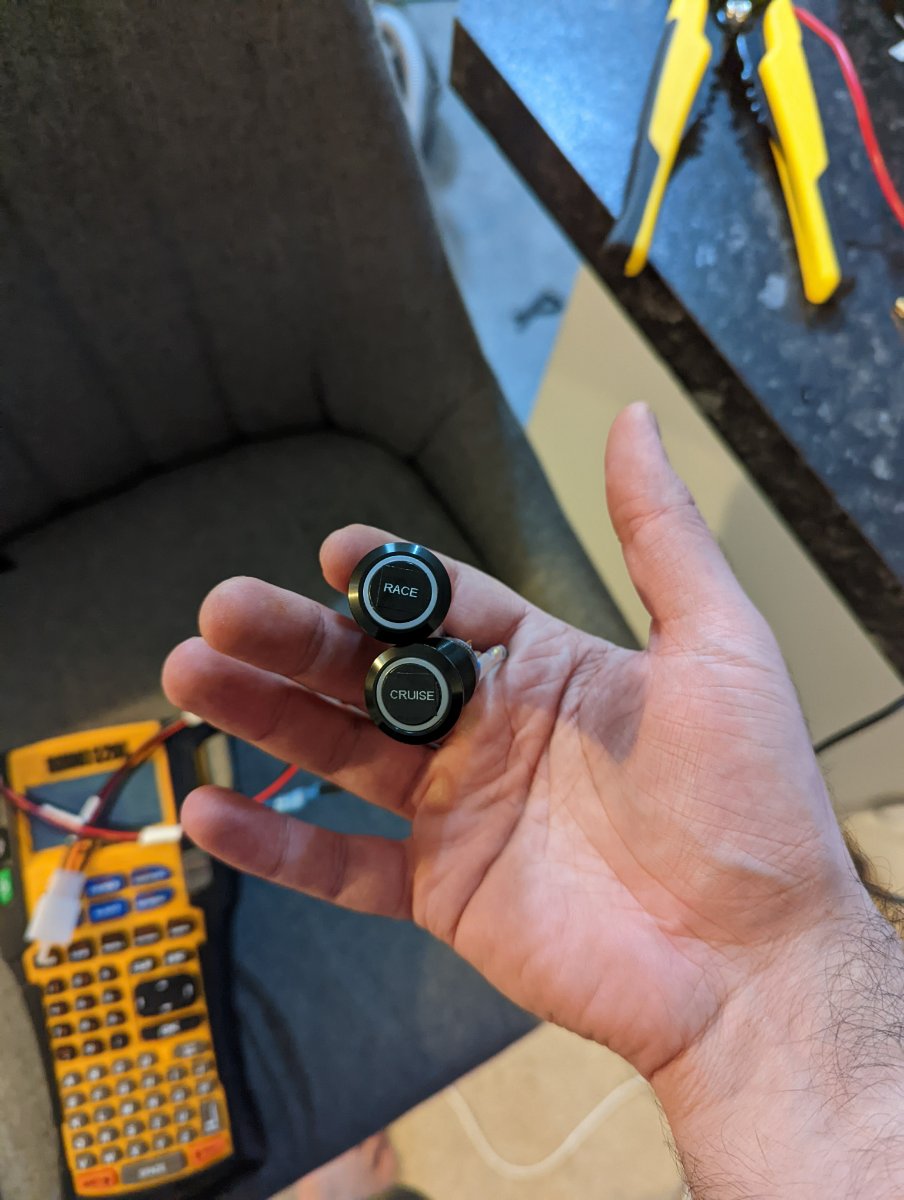

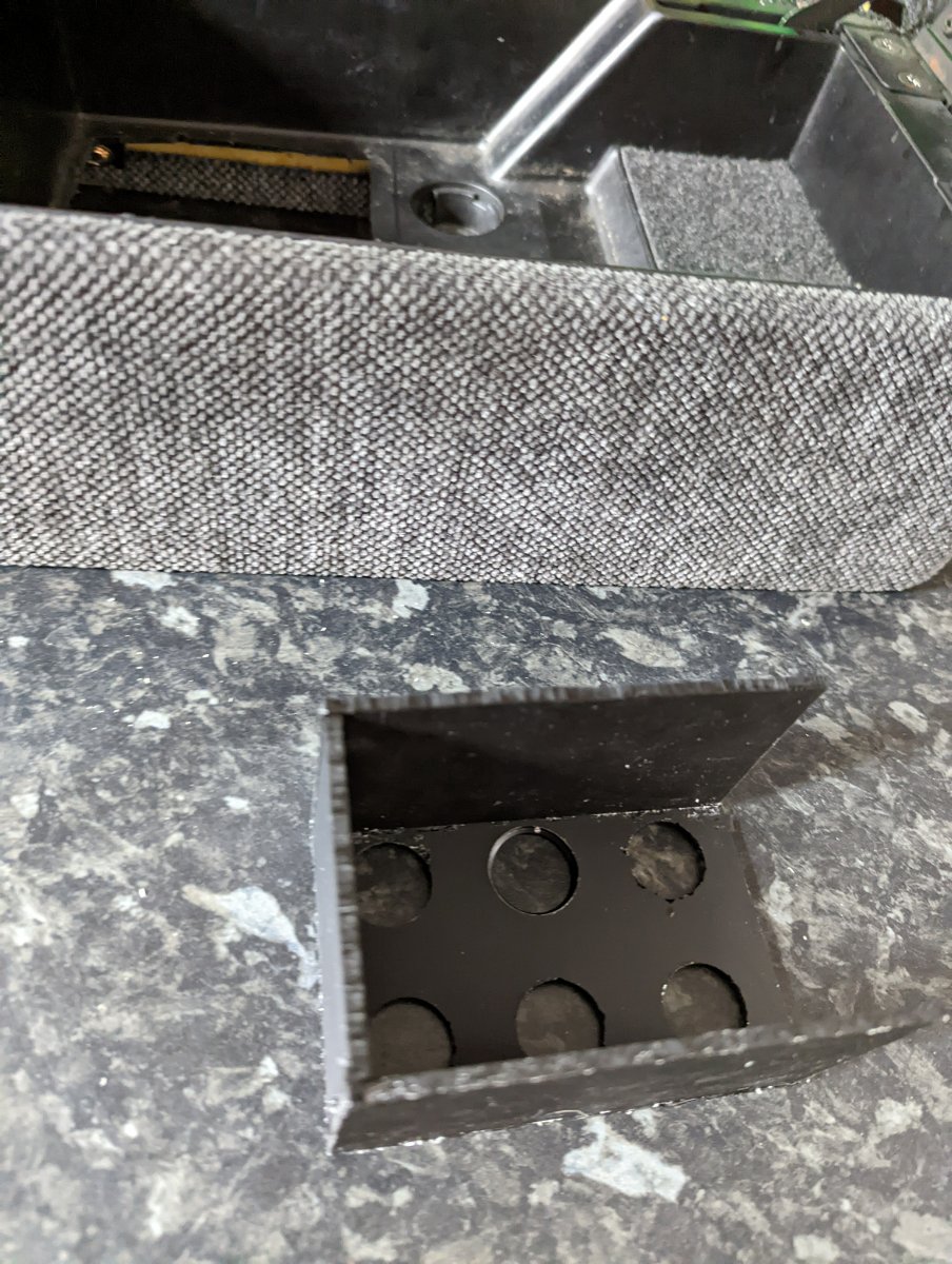

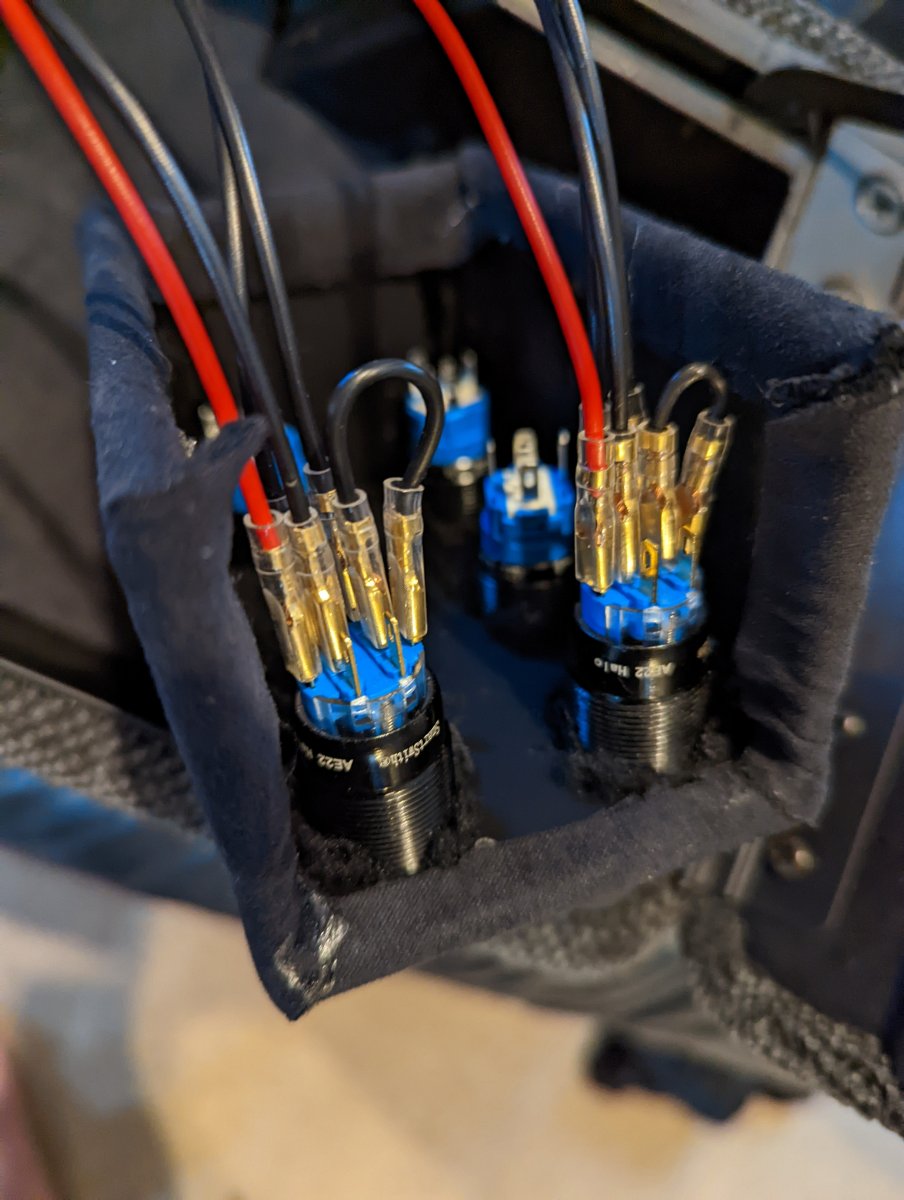

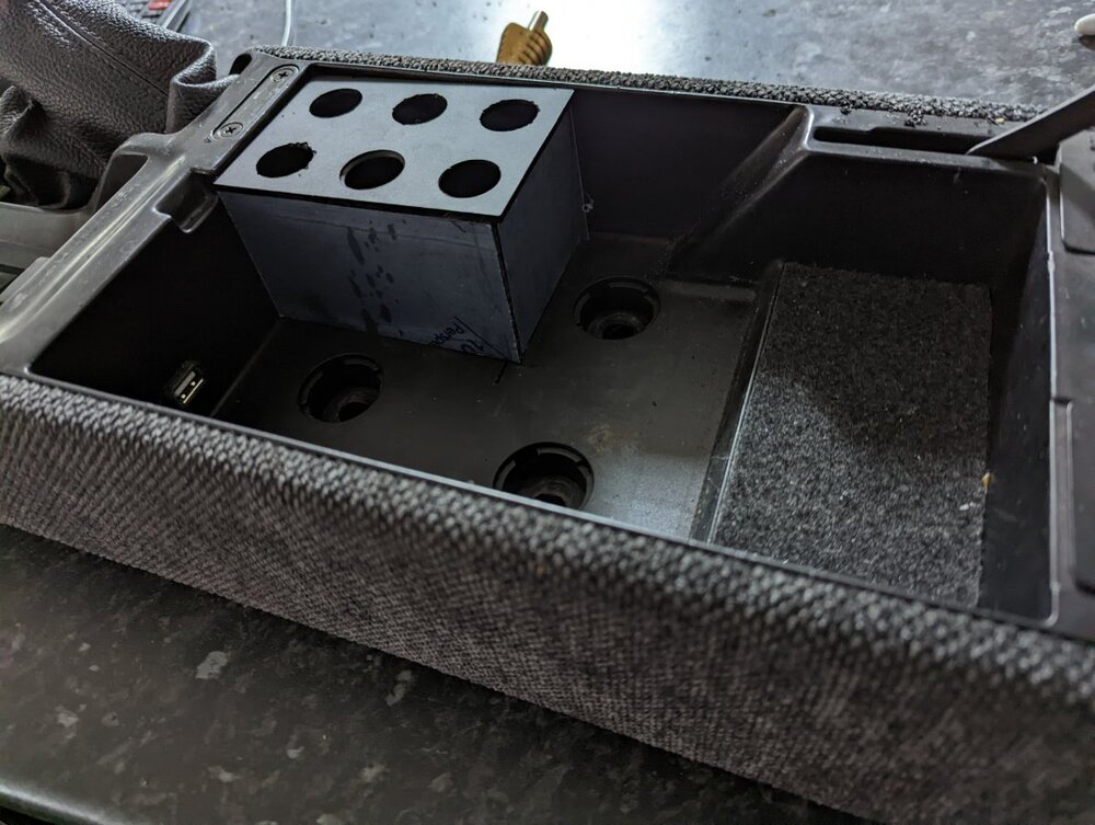

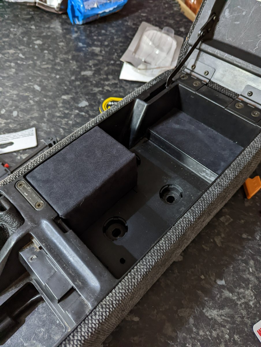

Moving on from Racelogic woes for now, something else I have been working on is adding some buttons into the centre arm rest. My Tein EDFC active suspension system accepts 2 external inputs to make instant custom adjustments to the damping settings of the car which I wanted to take advantage of. I figured, while I am adding buttons I may as well make a box for any future needs (I have some late UK spec seat heaters which someday will end up in the car that I will likely control from here) but also to move my power antenna control into this unit too. Previously I had bought a folding mirror type mirror controller and wired the power antenna to what should have been the mirror fold switch. I have now reverted that back to my standard unit.

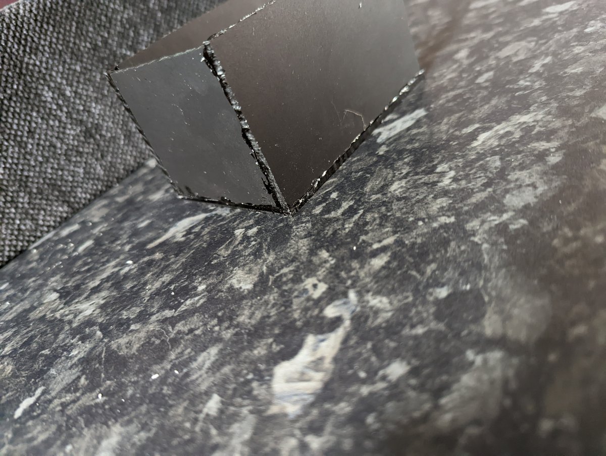

Just decided to make the box from some black perspex. A quick mock up highlighted that I needed to make account for the sloping bottom of the console:
Once I was happy with the fitment, time to piece it together:
Decided to wrap it in black suede like material and would be swapping out the factory console carpet for the same material too. It was only at this point that I realised it would have been ideal to match the width of the box to the cutout in the lip of the centre console, it was somewhat close by accident. Ultimately, I did not want to start again and this did not bother me too much.
Made up the wiring for the buttons, with some connectors so removing the centre console in the future is straightforward. The buttons for the Tein system are over-complex because I wanted light up switches but the Tein external inputs are asking for a switched ground, so what you see there is the solution. I also labelled the buttons as I saw fit.
And the final result below. Note the centre console carpet was just placed in there for now to give an idea of the final look, hence it being curled up a bit. I have also since re-cut this anyway as I was not happy with the shape.
And here is a little GIF of a quick test I did in the car. You can also see the reaction of the Tein controller to movement, albeit only the rear struts were setup with the system at the time. It works based on GPS speed of the car and G forces.
Edited by Peage

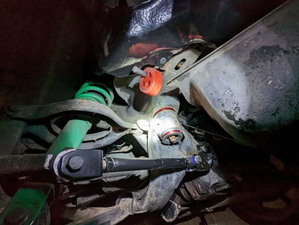

Bit of a suspension update here.

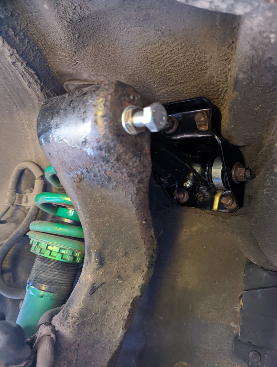

When the car was last on the road, the camber up front was always mismatched between left and right. I purchased the Whiteline camber bushing kit for the FUCAs but when it came to fit I realised a set was already installed! I had previously had these swapped out for what I was told were just regular polybushes at a certain garage in Doncaster. I was thinking they were expensive for bushings at the time but also had total trust in that garage at the time. I was never advised they were camber adjustable and certainly was never advised they would need adjusting after fitment. I did have an alignment done after this change but the person doing it also had no idea about the adjustable bushings and did not touch them... he was just stumped as to how the camber was off between the two sides. Now I know.
One problem I had since the previous install of these bushings was horrendous noise. I complained and took the car back to the garage once but he simply packed the brackets with copper grease and sent me on my way. Suffice to say this only killed the squeaking for a few days. I found the garage did not bother to install the included grease nipples in the arms to provide proper lubrication.... Annoying. I have since redone the install properly and took the opportunity to have the arms powder coated at the same time. Most importantly, we can achieve matching camber up front now - rather than bushings installed at who knows what angles unbeknownst to me like before.
Original Install:
New Install with grease nipples fitted:

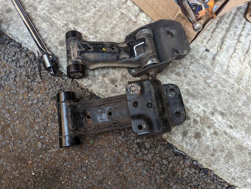

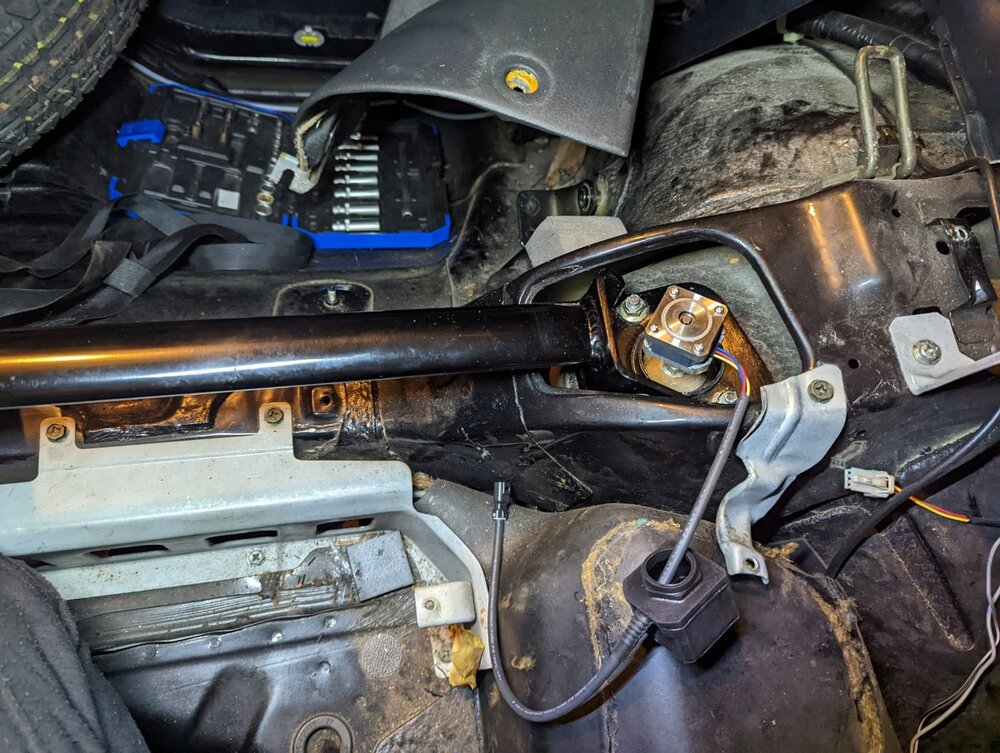

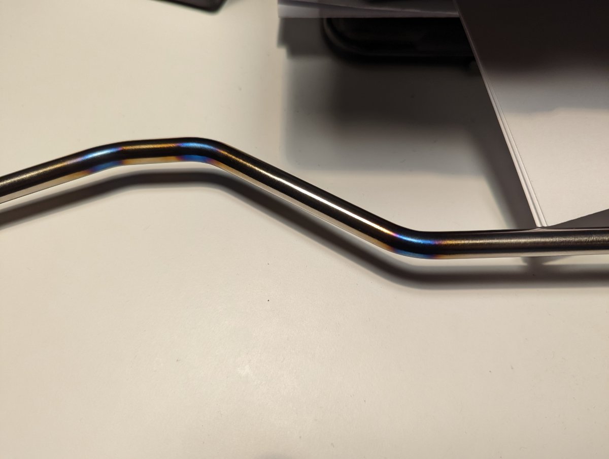

I have also deleted the HICAS at the rear and installed Driftworks arms with polybushes and installed subframe collars at the rear... Not a fun job with the car at minimal height on jackstands. At the time of deleting the HICAS I ran into power steering problems which I will cover in this thread at some point... still waiting to confirm the fix on that.

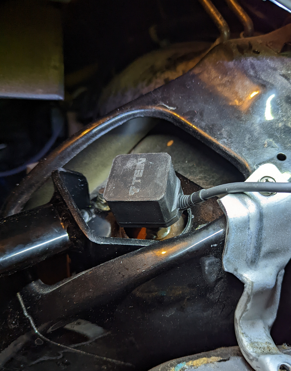

I have also installed the Tein EDFC motors on the strut tops and added a rear strut brace too.

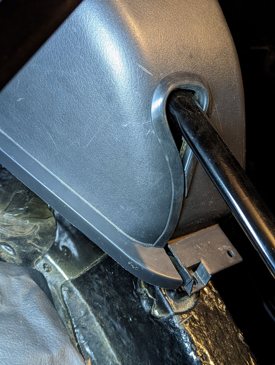

I did not thread the wire along the path shown in the pic below!
Cut into the boot plastics to allow for the strut bar and cut some rubber edging to suit. Not shown here but I also drilled small 2 holes either side of the gap on the bottom lip of the plastic and zip tied the piece together tightly. These zip ties are hidden under the carpet and gives tight fitment.

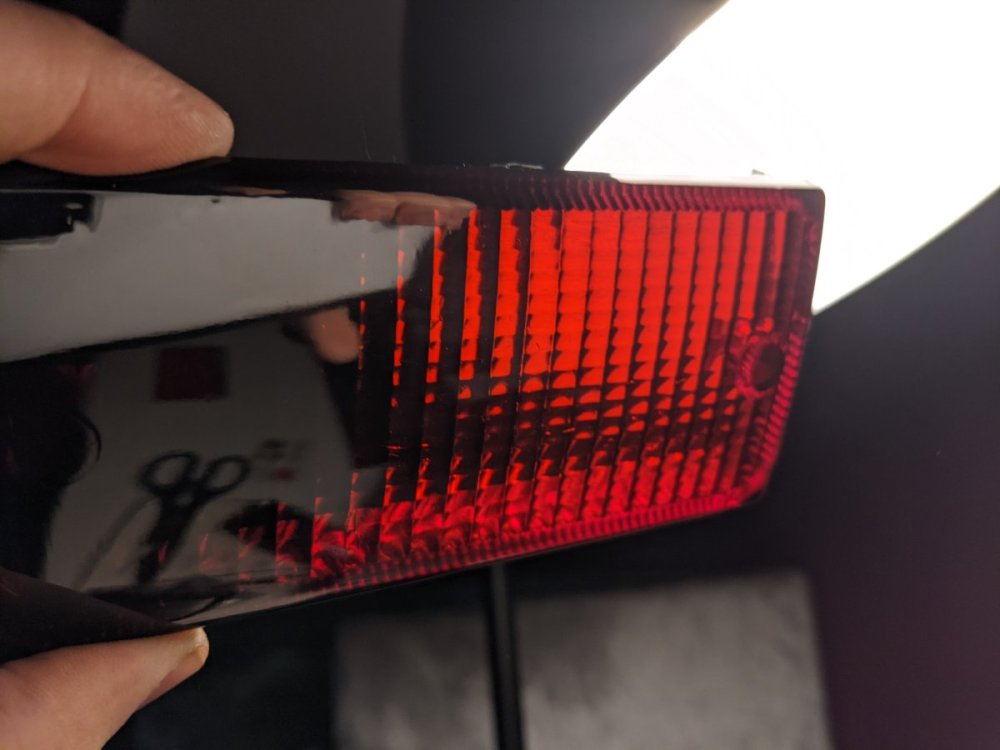

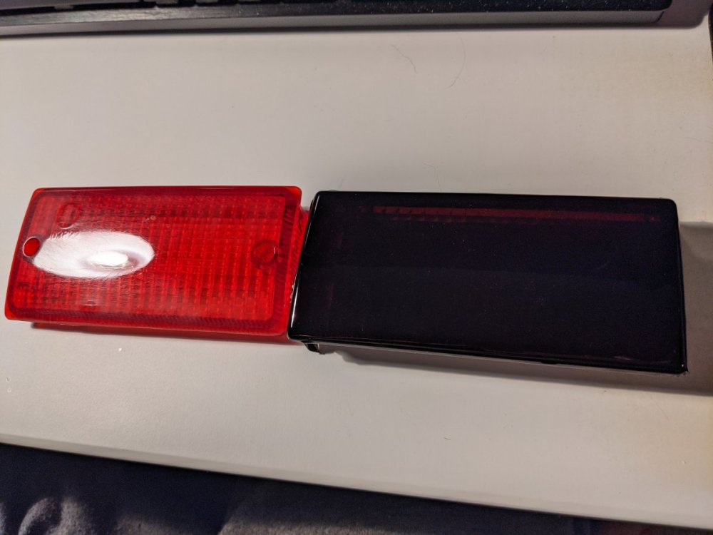

Decided to dark tint out the rear fogs as I was never keen on the UK spec rear bumper because of it.

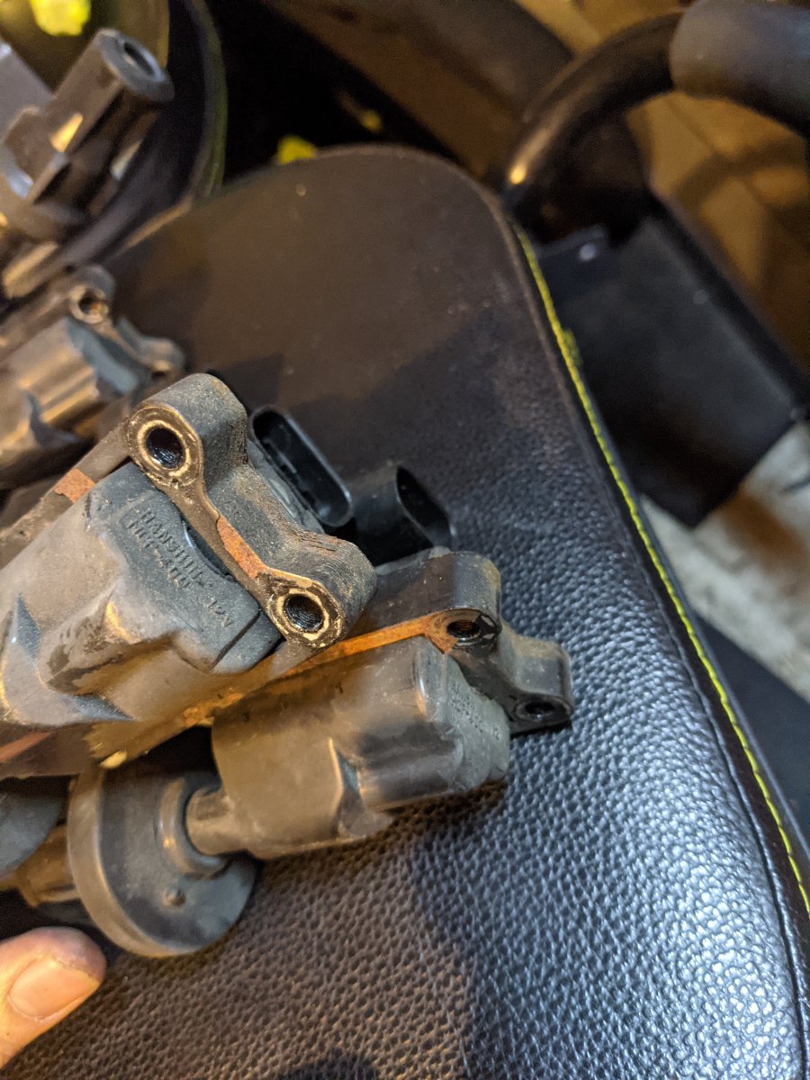

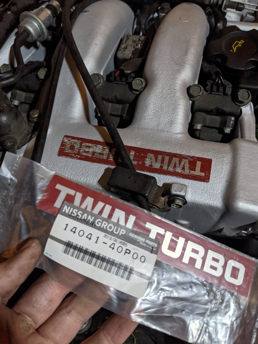

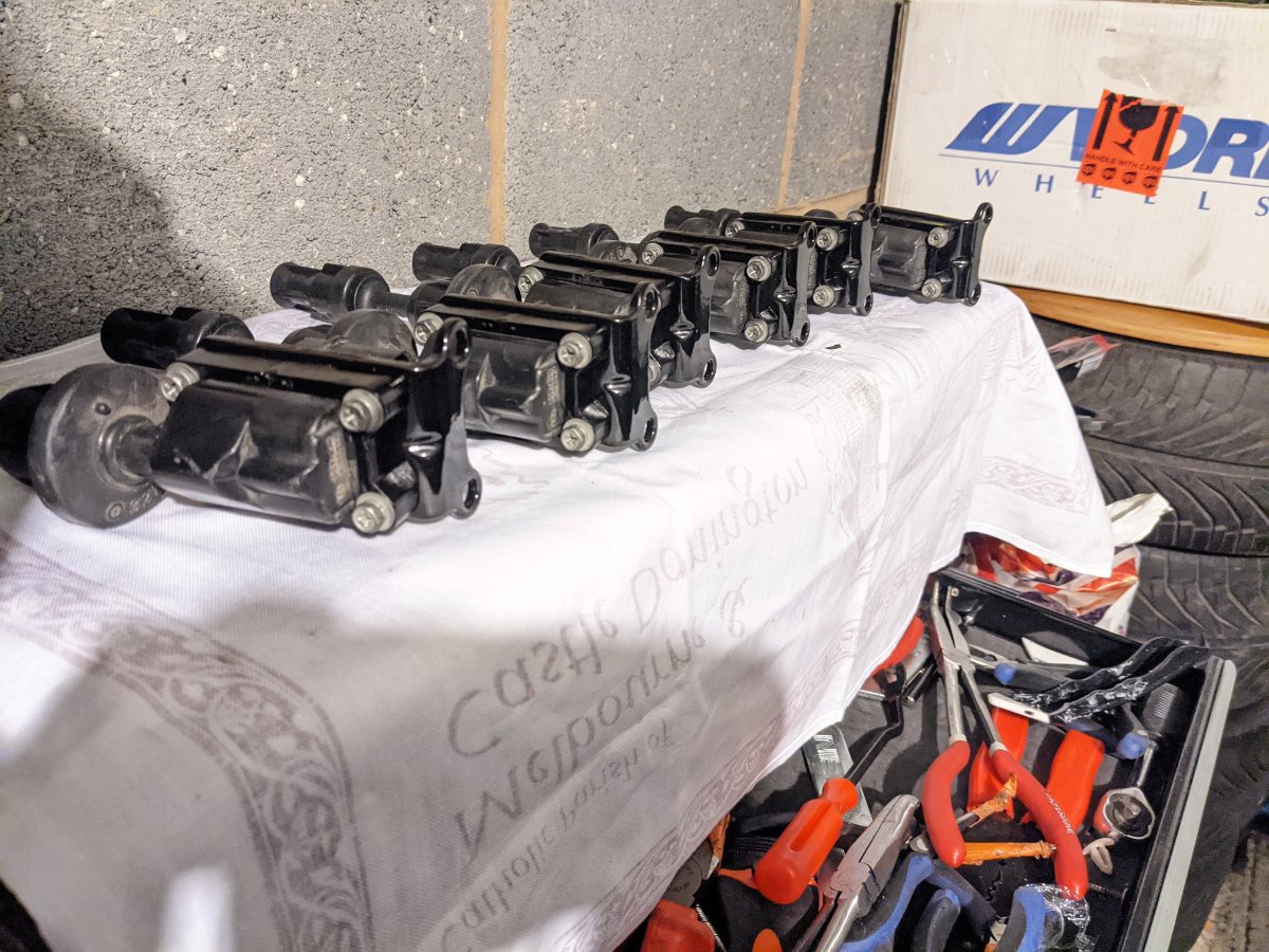

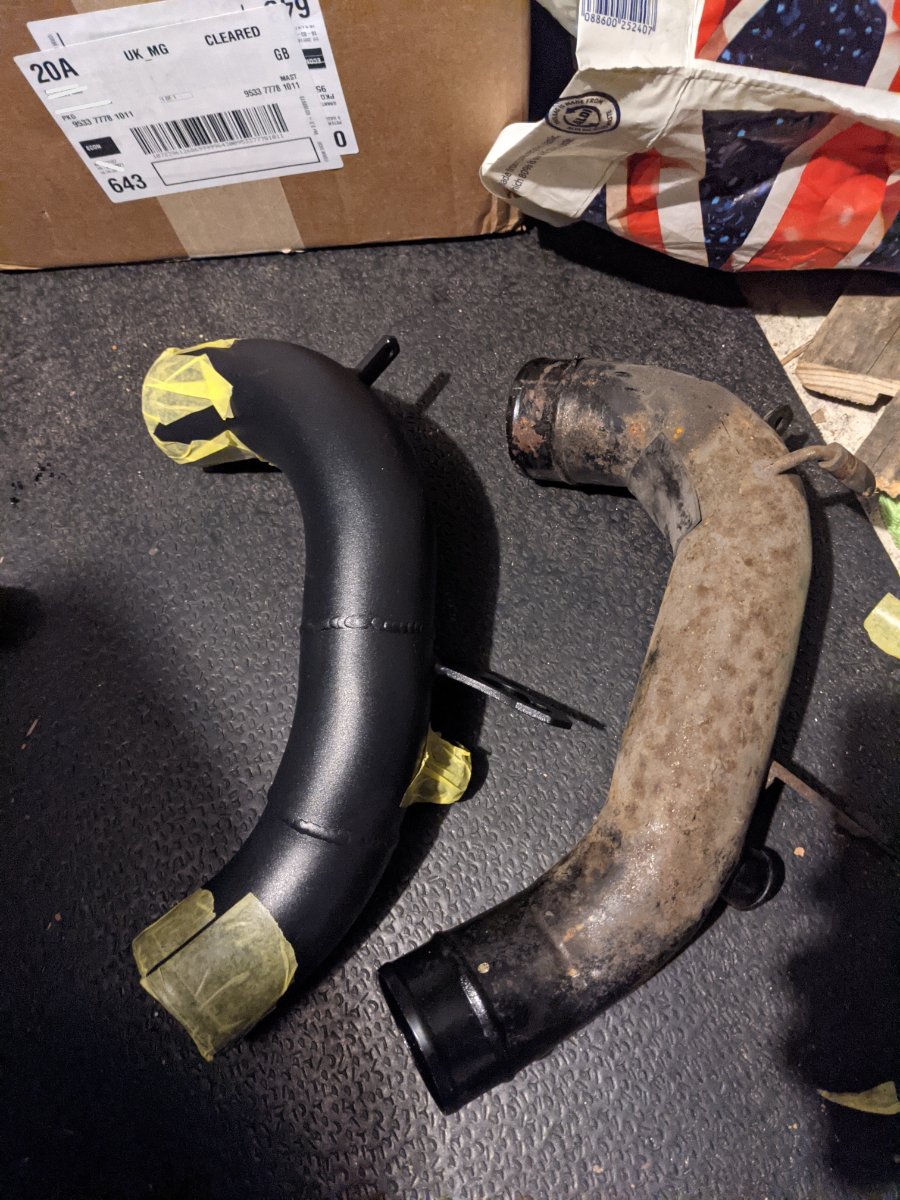

Also did some general refreshing of the engine bay and the car in general, replacing or refinishing crusty parts, aesthetic and functional. Some examples below.
Before:
After:
Before:
After (not perfect but much better):
Before:
After:

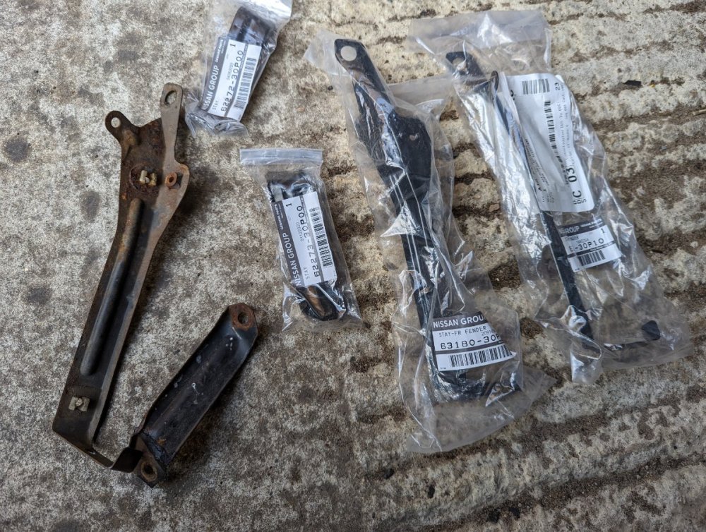

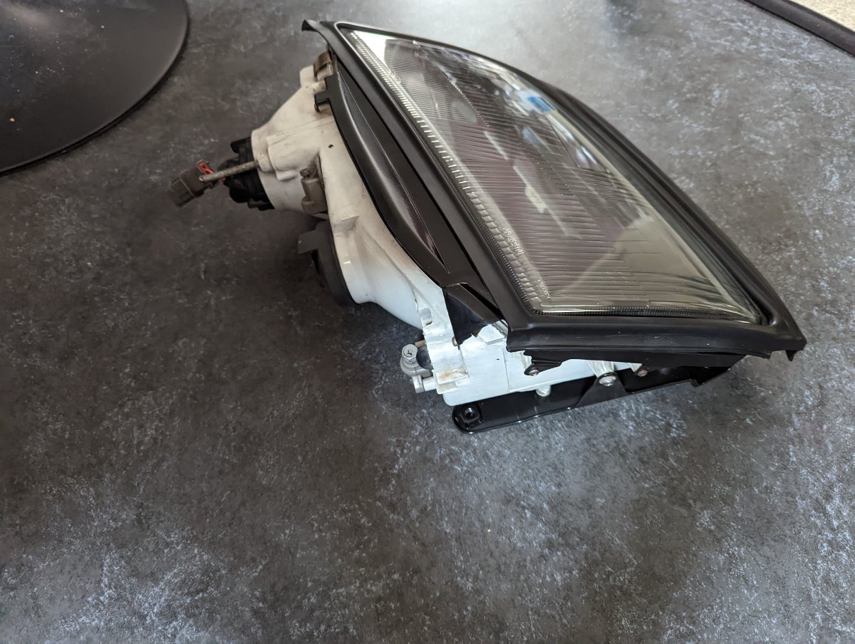

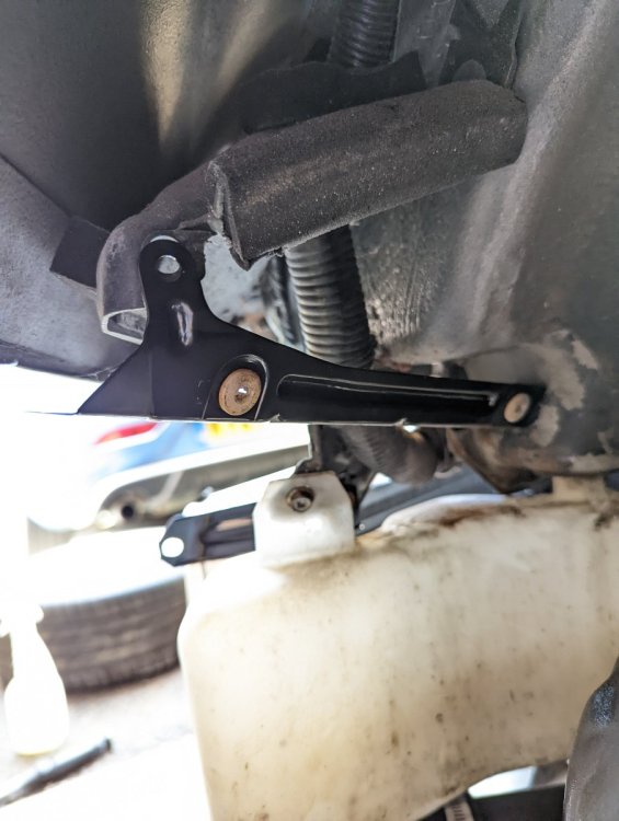

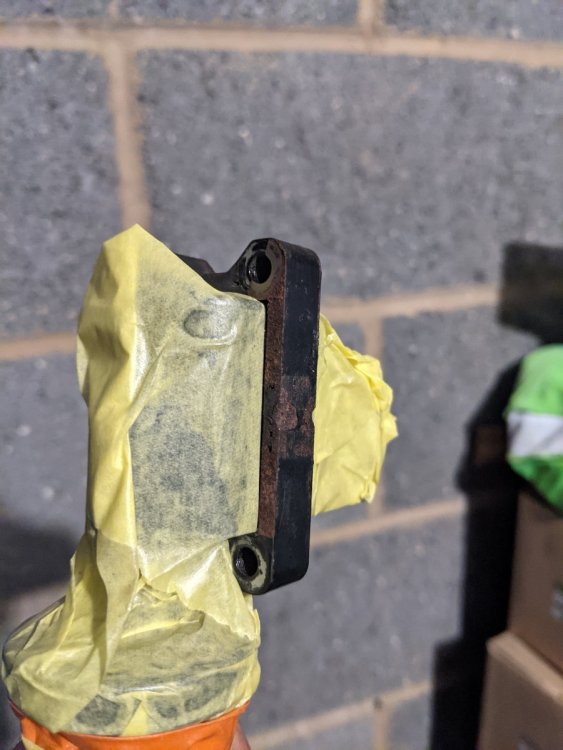

I also had quite rusted headlight brackets, the ones actually part of the headlights. I acquired another set of headlights and has the brackets powdercoated and took the best parts from each set and made the best set I could from them.
Also replaced the washer bottle with a smaller model from other markets to give more flow to my intercooler but retained the UK spec headlight washer functionality.
Before (those rusty brackets were all later replaced, as above!)
After:

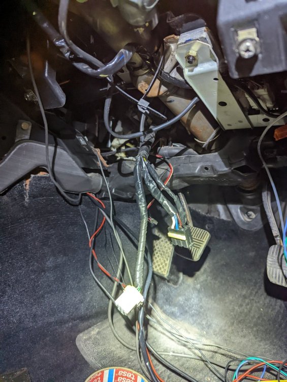

I also came across some horrible wiring in the car from a previous alarm install at some point. I took the opportunity to clean that up as best I could and make the electrical connections sound and recovered with electrical tape (all joints under the tape are now soldered and heatshrinked).
Before:
After:

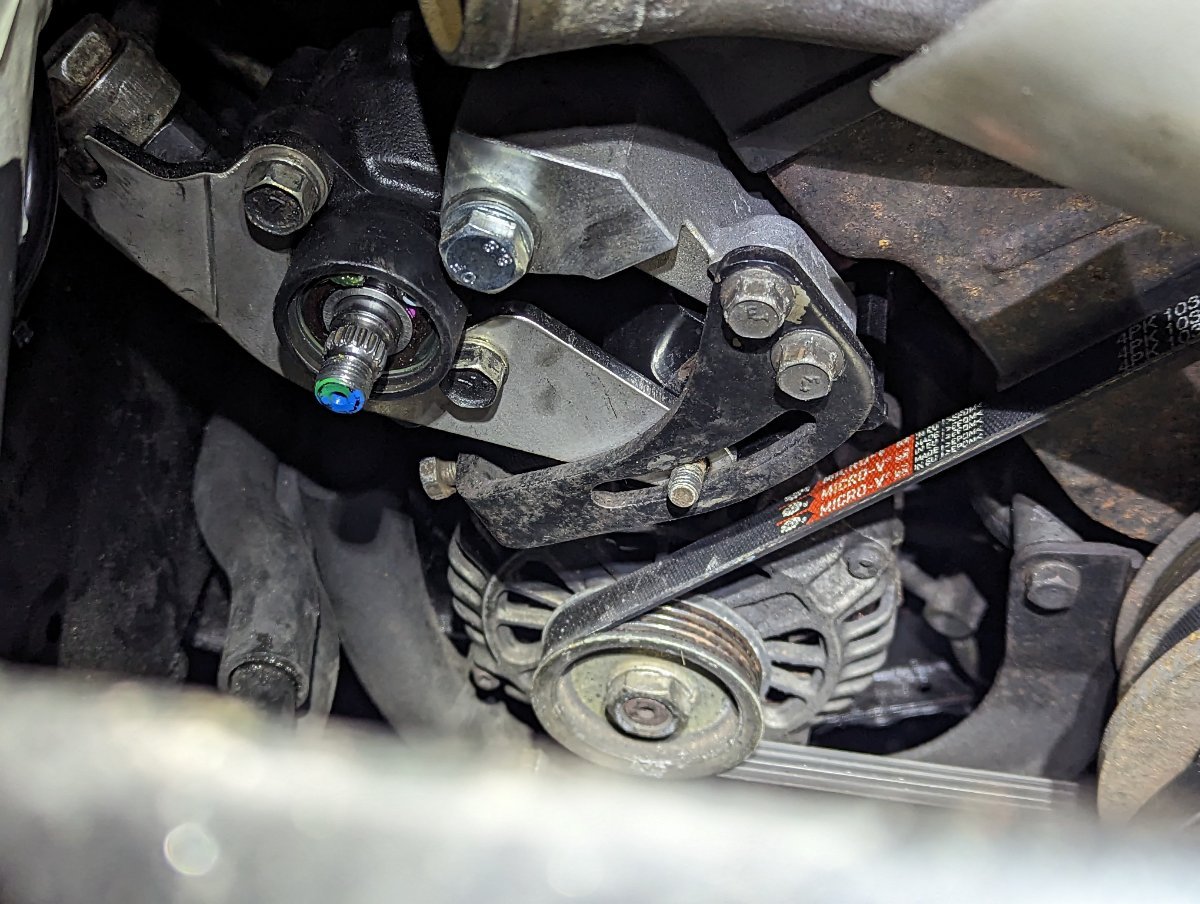

One issue I also had was my failed power steering, tried a few different things like different rack solenoids and diagnosing the various sensors related to power steering before just changing the pump. The TT pump is a bit of a pain as new ones cannot be bought and neither can rebuild kits from the usual places. I ended up having to grab a refurbished one from Japanese auctions.
Looked nice and this actually solved my issue.... for few weeks or so before the same problem returned!! I have since done further diagnosis, including hardwiring the rack solenoid with 12v on recommendation of Powerzed as a test and no joy. Solenoid ticks just fine and have previously used another one so assume now that is fine and it can only be the pump again? I am currently putting off the job but will have to tackle it soon before summer. Currently thinking I will just bite the bullet and swap to the NA pump which at least is more supported.

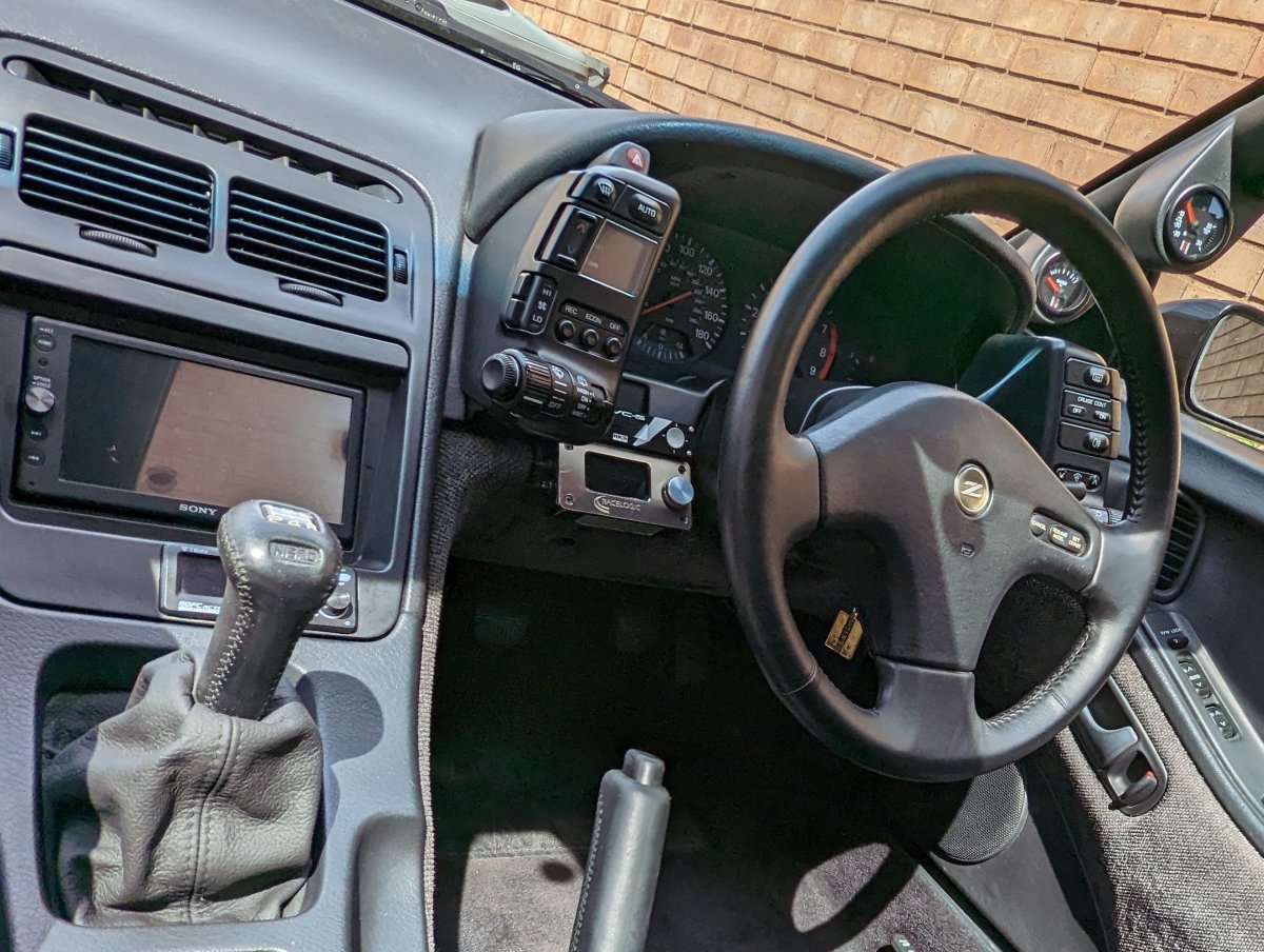

While on the topic of electronics, in the end I had to locate another Racelogic unit to replace my broken one. Works amazingly and love the level of control, not to mention launch control. Will at some point wire in the clutch switch so I can setup flat foot shifting but am putting this off as I told myself I would not launch it too much but ended up buying a Dragy GPS unit and launching many many times, tweaking the Racelogic calibration for the best 0-60 and 0-??? 😉 Not sure flat foot shifting would be the best thing for the drive line, neither are the launches, probably. Oh well.

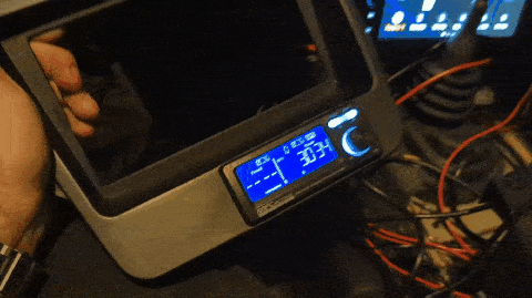

This was installed on the dash next to the boost controller - but has since been removed while I model a means of embedding it under the skin of one of my custom cup holders. You can see it's previous placement below:
Also the Tein EDFC controller in place in the dash, along with a 90's Nismo gear knob.

As for now, the car is back to being worked on in the garage. As mentioned before, my power steering issues came back. I have decided to convert fully to an NA pump and used the Z1 kit for this and would highly recommend it. Some parts are re-used, like most of the belt adjuster, some bolts and nuts, etc but you end up with everything you need. The standard TT fluid pot is retained (thankfully as I only had this powder coated last year) through the use of a unique J hose and a plug.
Whether this cures my issue - Not sure yet as the car won't be turning over for a while yet.

Status: Pump fitted. Needs fluid & bleeding and then fingers crossed when I next strike the car up.

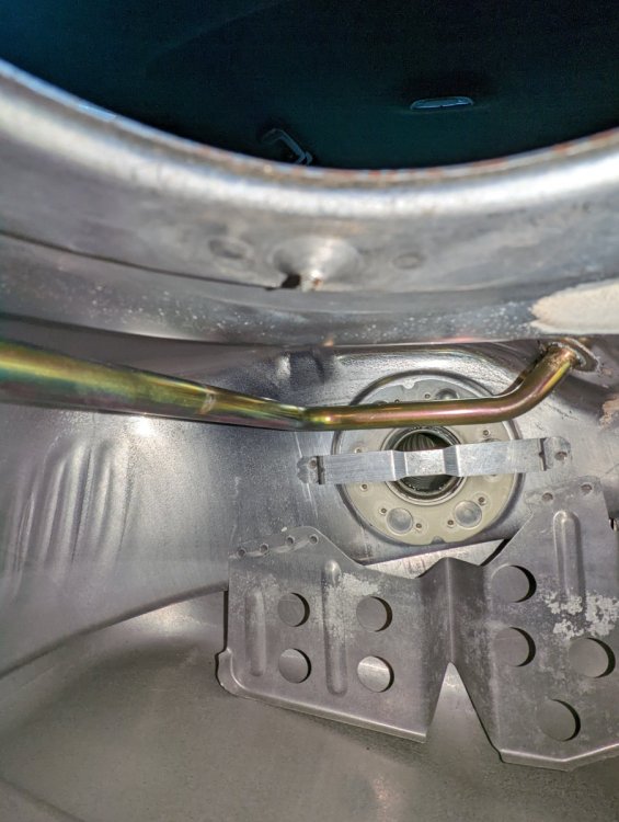

Status: I found this had sprung a leak around where the tank straps are, I guess all the fun with it last year did not help. This has already been removed and is currently with someone who will be brazing to repair. I had hoped to never have to remove that tank again but I really should have taken the time to refurb it last year before refitting. I was was eager to have the car to drive while the weather was still nice though!

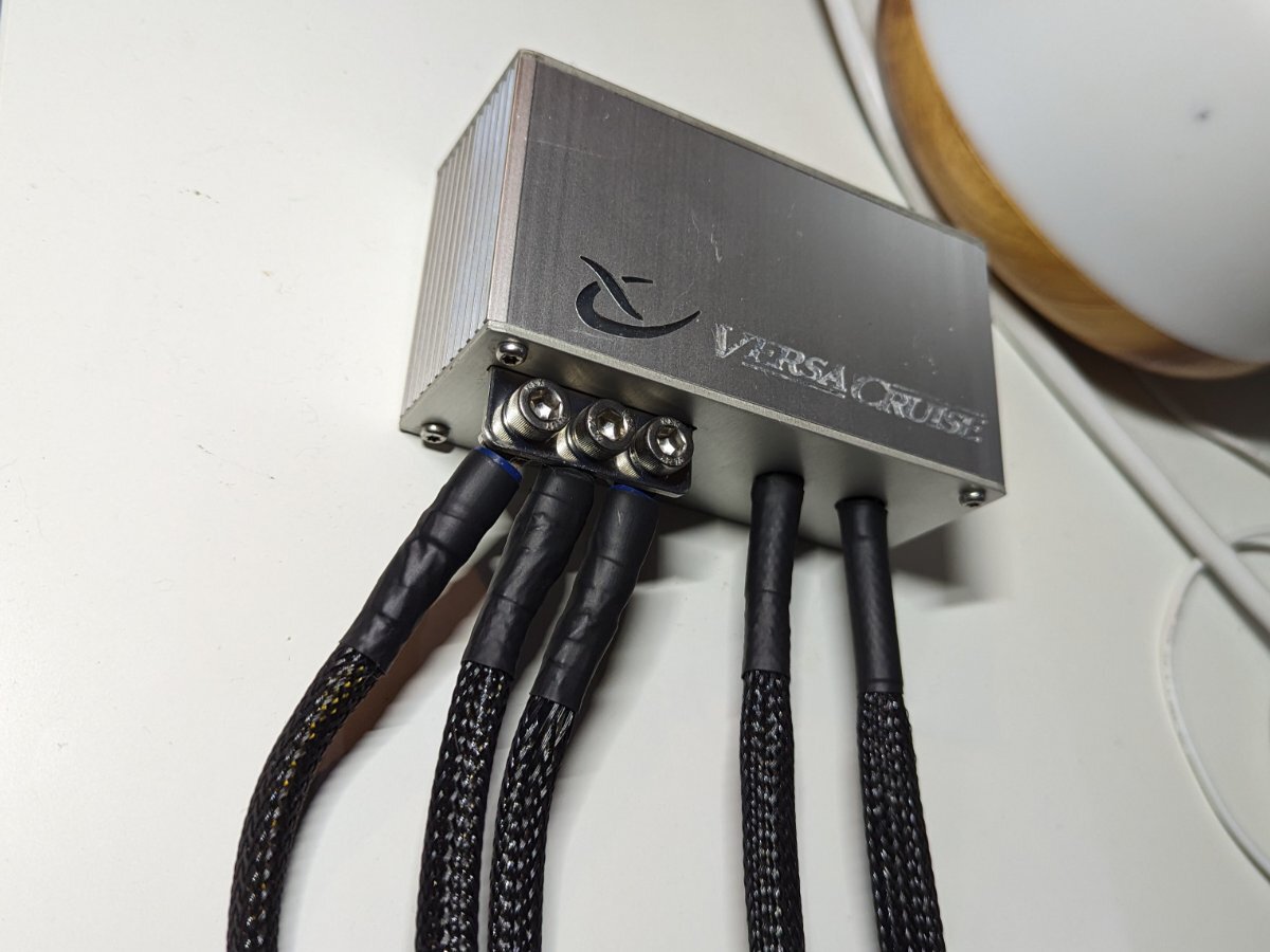

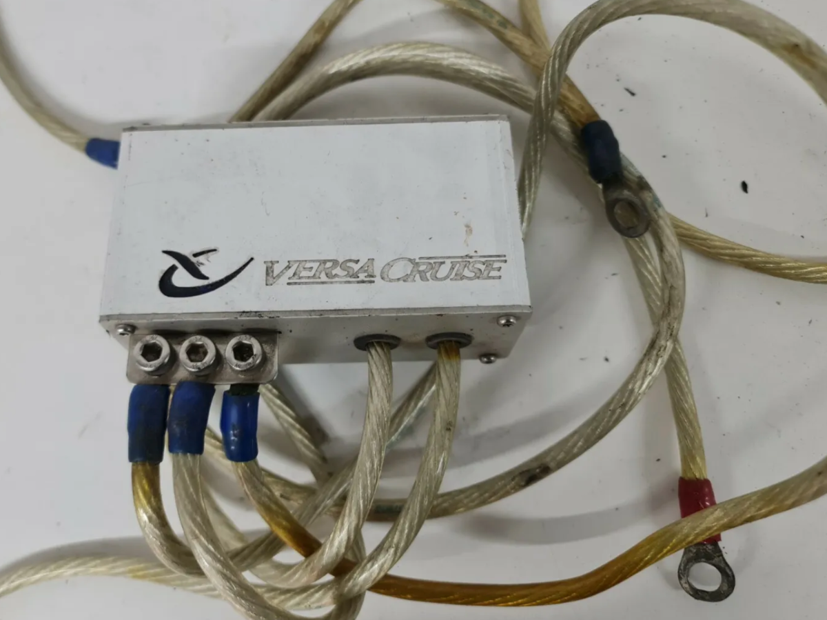

Picked up an old Apexi Versa Cruise grounding kit cheaply on eBay a few months back. Will it do much, I am a little doubtful. Is it a nice engine bay trinket, I think so.
The unit was a grubby as seen below when I bought it:
These also light up blue as standard as seen here:
I gave mine a refurb and swapped out the blue lens so it lights up white as I don't have any blue on the car really.
Also have my tank back from brazing and it has also been internally coated and had a quick spray over for protection.
