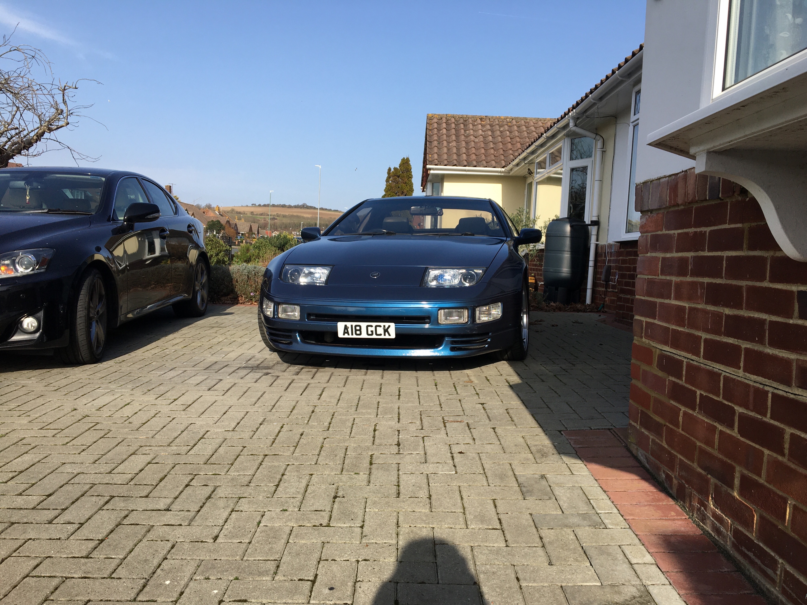

I have the slim size front plate which the website confirmed was Uk Legal: 330x89mm (13x3.5in)
I bought it from a company called Plates For Cars Ltd: https://www.platesforcars.co.uk/designer.php?gclid=EAIaIQobChMImNnm6OO68gIVAe7tCh2RdAleEAAYASAAEgJgw_D_BwE
What makes it legal is the letter spacings, font size and that the plate needs to show the supplier postcode and supplier name I believe.

I forgot to update this post!... so I had the front plate made with 65mm text, not sure about the width... MOT tester didn't even seem to notice or quizz me, even though the number plate looks small (ish)
