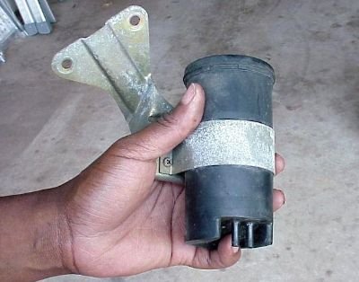

could be AIV solenoids should be one on both sides they feed into the exhaust and would have vac lines into the engine bay.

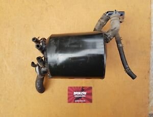

PRVR canister (link below is for LHD car)
http://www.twinturbo.info/63104/138229.html
Good call Andrew, I forgot they are normally in the wheel arch behind the trim... not even sure mine have them...
