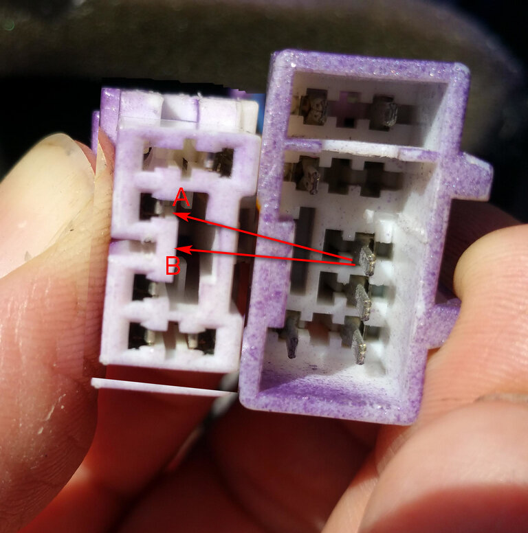

Welcome to the Club Luke. Can you post a photo(s) of what you have done to the mirror connection(s)
spacer.pngOn the larger connector there is a little spline on the right side that blocks a 5 pin from going in. I removed it the plug went in and the mirrors folded

Look at the pin spacings. The the pin arrowed should go to A, but from the marks on the plastic is going into position B with no connection.
Thanks a heap I cut off the connector and wired them together and it works now. I’ll remember to look out for that in future
