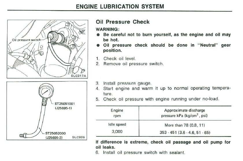

If you look in the manual it gives you the pressure. The senders have a habit of failing, so you may have to check with a mechanical gauge. This would then show if you require a new sender. It’s all there tbh.
9 hours ago, AndrewG said:
These are the figures from the FSM. Low oil pressure reading (on the dash gauge) when mid rpm is typically the oil pressure
sensor/switch failing (assuming the oil level on the dipstick is correct).
Yup - what Andrew said!
The OEM sender unit is a common failure - and not cheap to buy - but if your gauge reads low and there's no obvious engine noise (knocking, rumbling etc.), then it's most likely just the sender that's failed!
