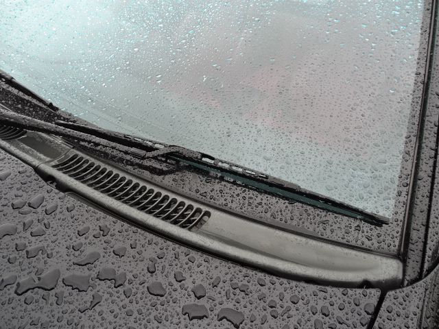

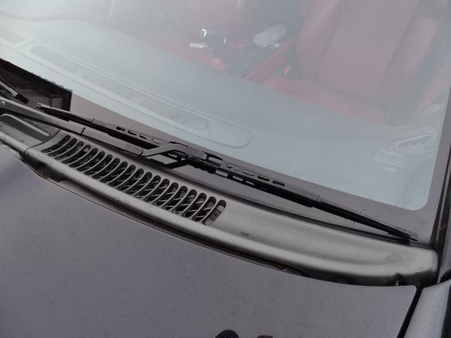

The at rest postion is lower than the lowest sweep position (thats why they do a double sweep when you turn them off) All three of my cars, the wipers when off have sat just touching the trim (unless all of mine are wrong!)

They need to be lower Lee.....

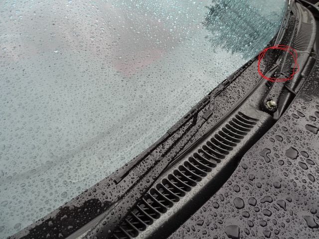

Check out that little indentation in the top of the scuttle panel, pretty much at the tip of your right wiper blade. That's where it should rest!
Here.... :classic_wink:

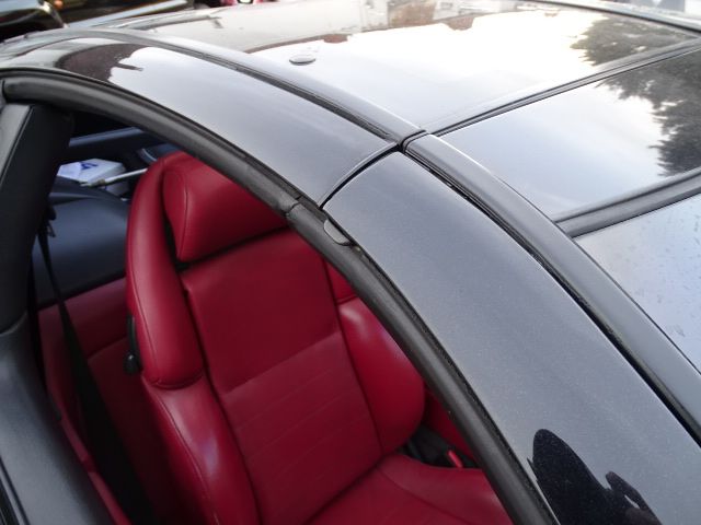

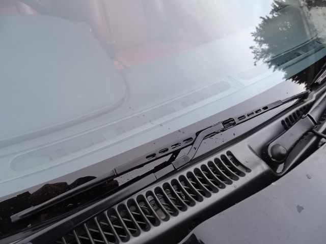

Now looking much better:), also did the windscreen and targa trims in satin black, came out better than I thought!! below pictures look sooo much better....
