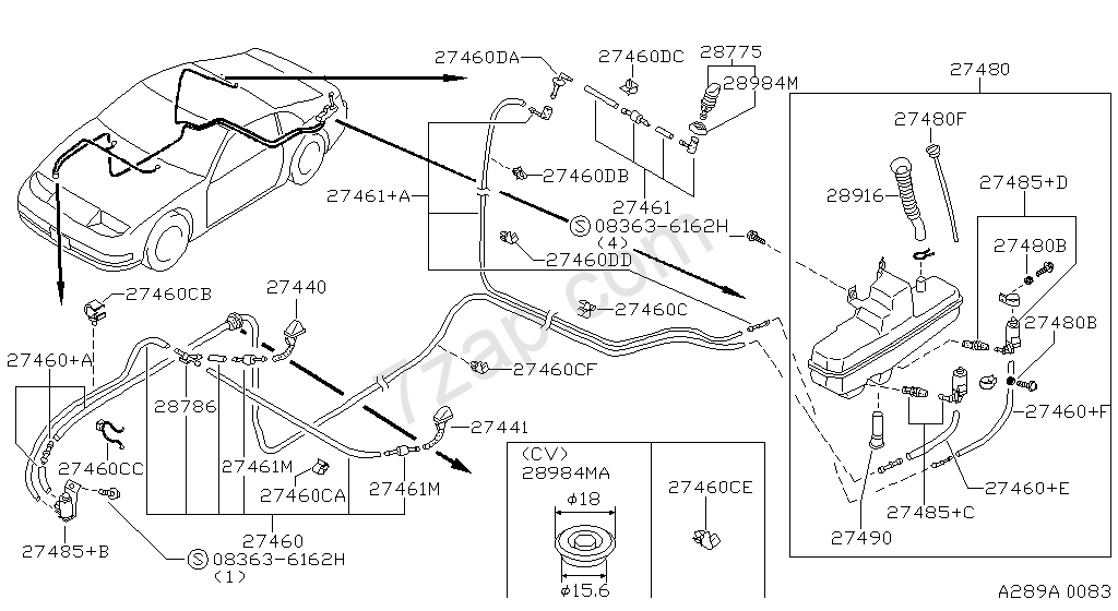

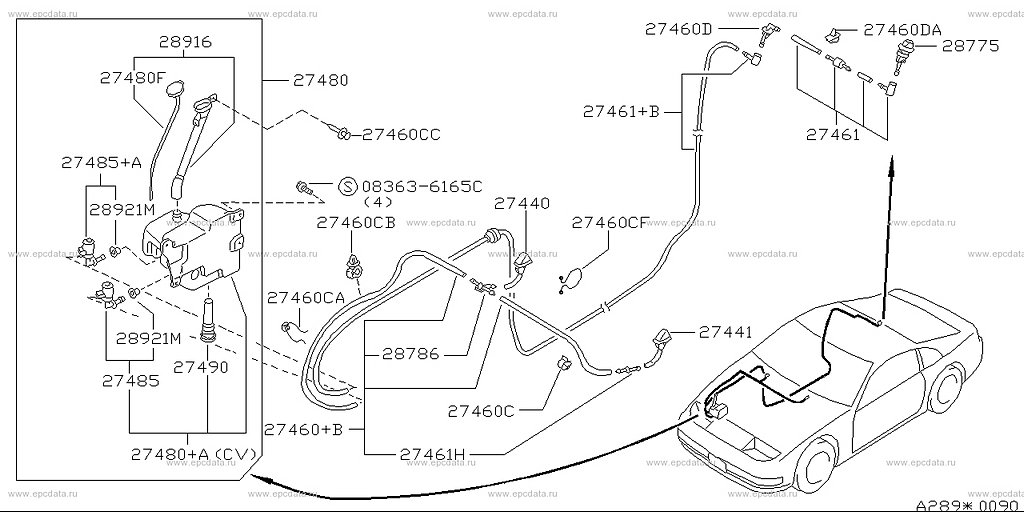

If the bottle is empty this should be indicated by an amber dash light, picture of a windscreen with jets of water.
The washer bottle configuration changes with model specification, so the swb and lwb are different and the U.K/Euro version are different again.
My 2+2 jdm car the bottle is located behind the drivers side intercooler and has two pumps and a level switch.
Uk cars the location is the same but there are 3 pumps and a level switch, the bottle is also a slightly different size.
2+0 cars have a rear a rear mounted washer bottle. I don’t believe there is one located in the front.
If you have a front bottle it will be in the drivers side, if you lift the bonnet there will be a fill cap in the corner below the power steering pot. This will be a clear colour with the standard washer symbol on it.
In my late 94, series 4 slicktop, I do not have the reservoir in the l/h rear, just the one r/h front with sure it's two pumps, wonder if my 95 is the same, I expect so.
I remember seeing earlier SWB's and spotting the rear filler cap and pointed out that I don't have on mine to the unaware owners.
