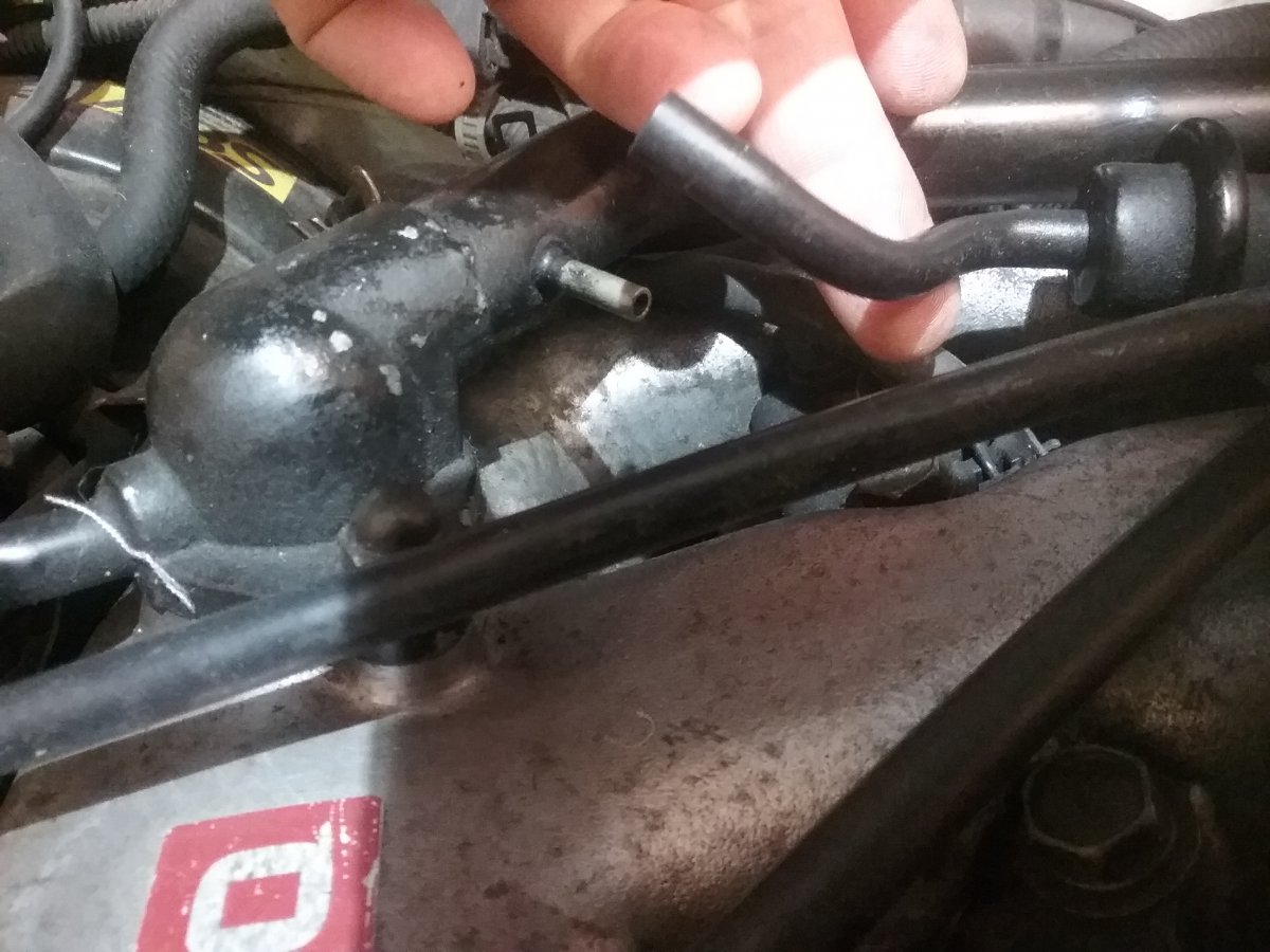

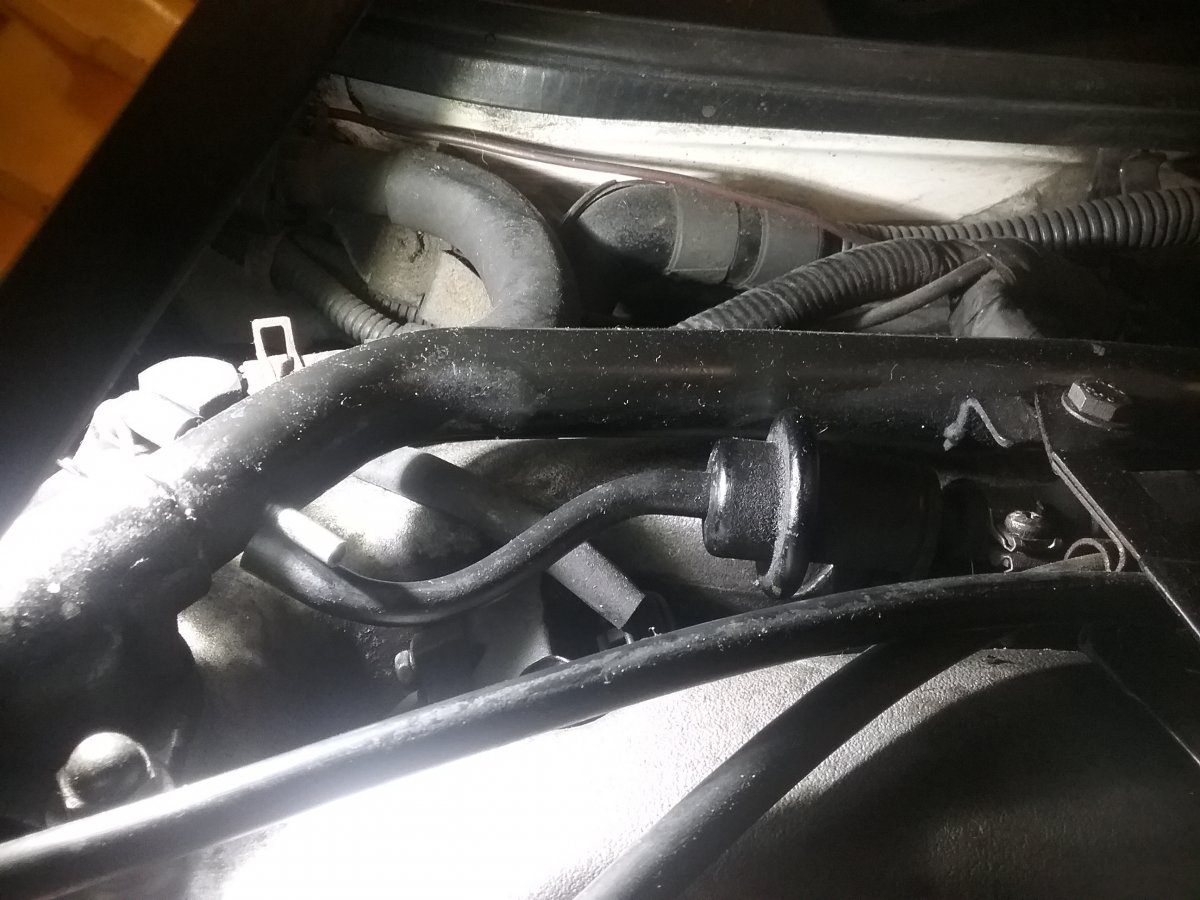

Anybody getting failure on mot for Emissions!
Article o 300zx-twinturbo.com shows dutch guy with meters on car showing high failure rate.
He then disconnects small pipe to fuel damper and emissions were now passable!!
I myself had fail on emissions about fifteen years ago, i removed pipe temporarily and it passed .
I remove every time car goes in for mot and has passed every time! !
Ps don't forget to reconnect after mot.
Even though car will run ok.!!
Hope this is of some help to some one.
I have had it before as I’ve been idling rich which will get you a fail. I crank my idle up a bit and passes no problem [emoji106]
Yeah the pipe to the fuel damper alters hydrocarbons if you detach the pipe close by opposite on balance bar that goes to aid s and this affects the CO levels! Only pull one at a time depending which you need altering.
You can also buy Wynns emission reducer, works quite well, I recently used it with good results, got it from Halfords
