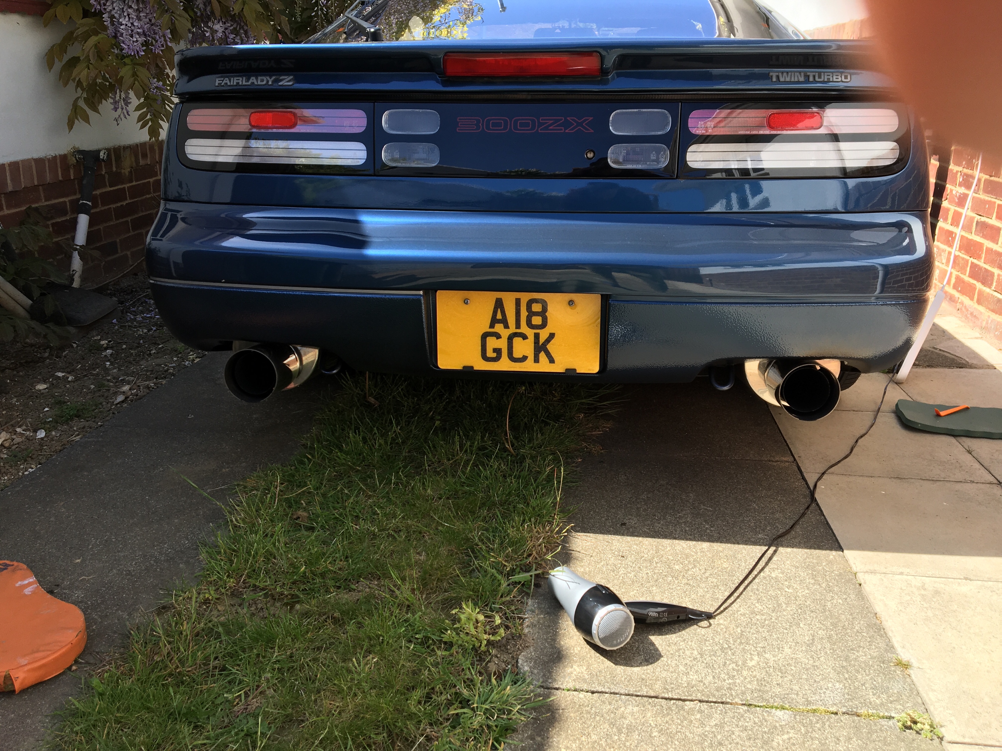

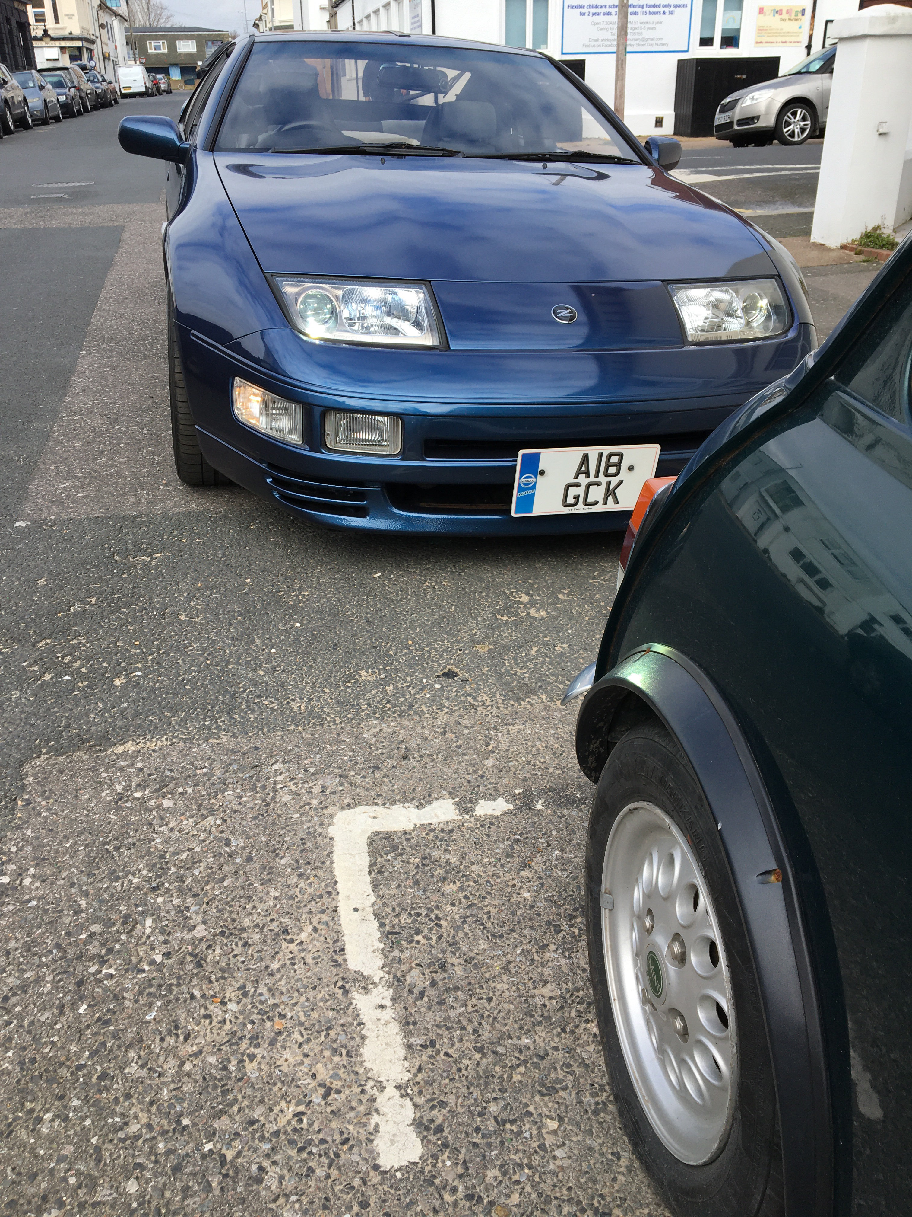

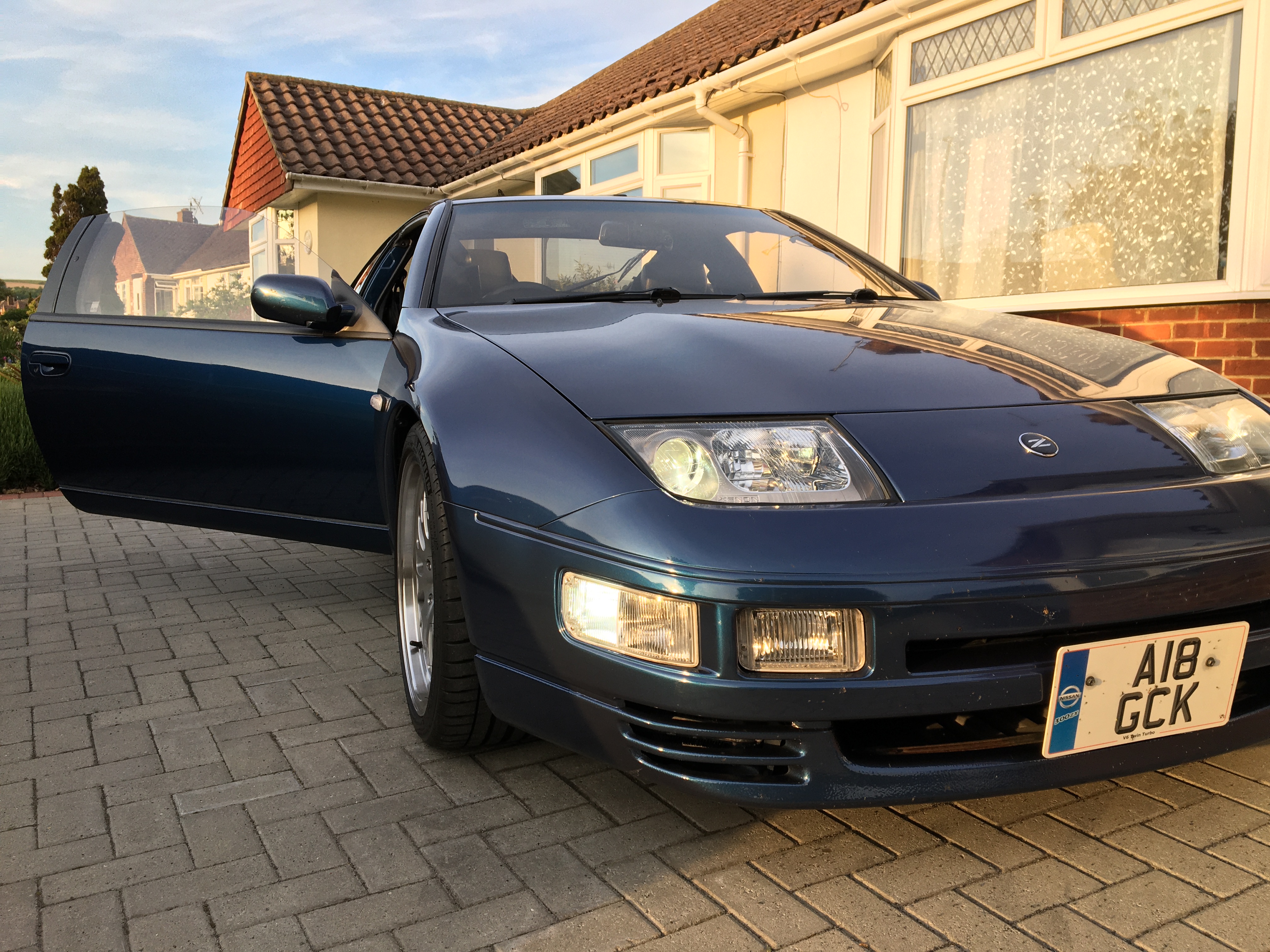

Pics of the car when I bought it;
Sent from my iPhone using TapatalkIMG_4626.jpgIMG_4635.jpg3453b26a-6332-4ff8-8837-4d744e02fddb.jpg045c8711-d8fd-4305-8da7-a9edad229583.jpga8c6aebe-ab4d-4d9b-be7f-b5c36b9f749e.jpgIMG_4863.jpgIMG_4862.jpgd8032910-48c2-48f5-80da-f433adb2a3eb.jpgf650103f-8ffa-4048-888c-5d36c4aac32c.jpg75162c24-2e75-448e-9d21-23c4968383d4.jpgc2507fc3-ab16-413f-8e4b-c2dc5abb0549.jpg4f3d936f-92f1-495c-8e51-43fb3dc71896.jpg

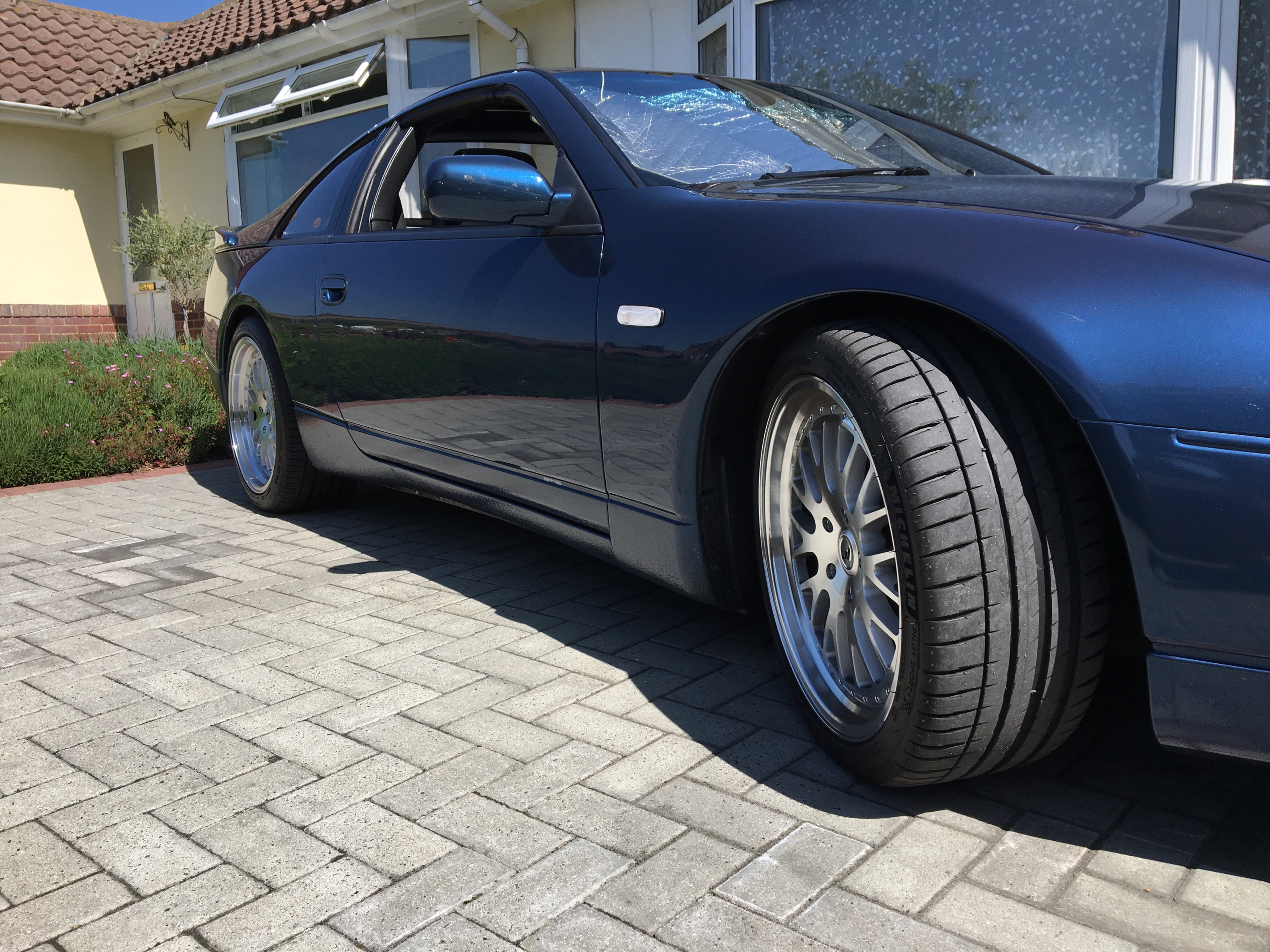

After I fitted the silver wheels, the amount of silver coloured bits; exhaust, wheels, headlights were all nice but the silver pin stripe made the silver theme a bit too overpowering and deterred from the lovely blue paintwork. Today I got out my wife’s hair dryer and got to work on removing the pin stripes. I was expecting it to be messy and painful, but in the end all I had to do was pass the hair dryer over a section say 5-6 times, and it was soft enough to peel right off - happy days.

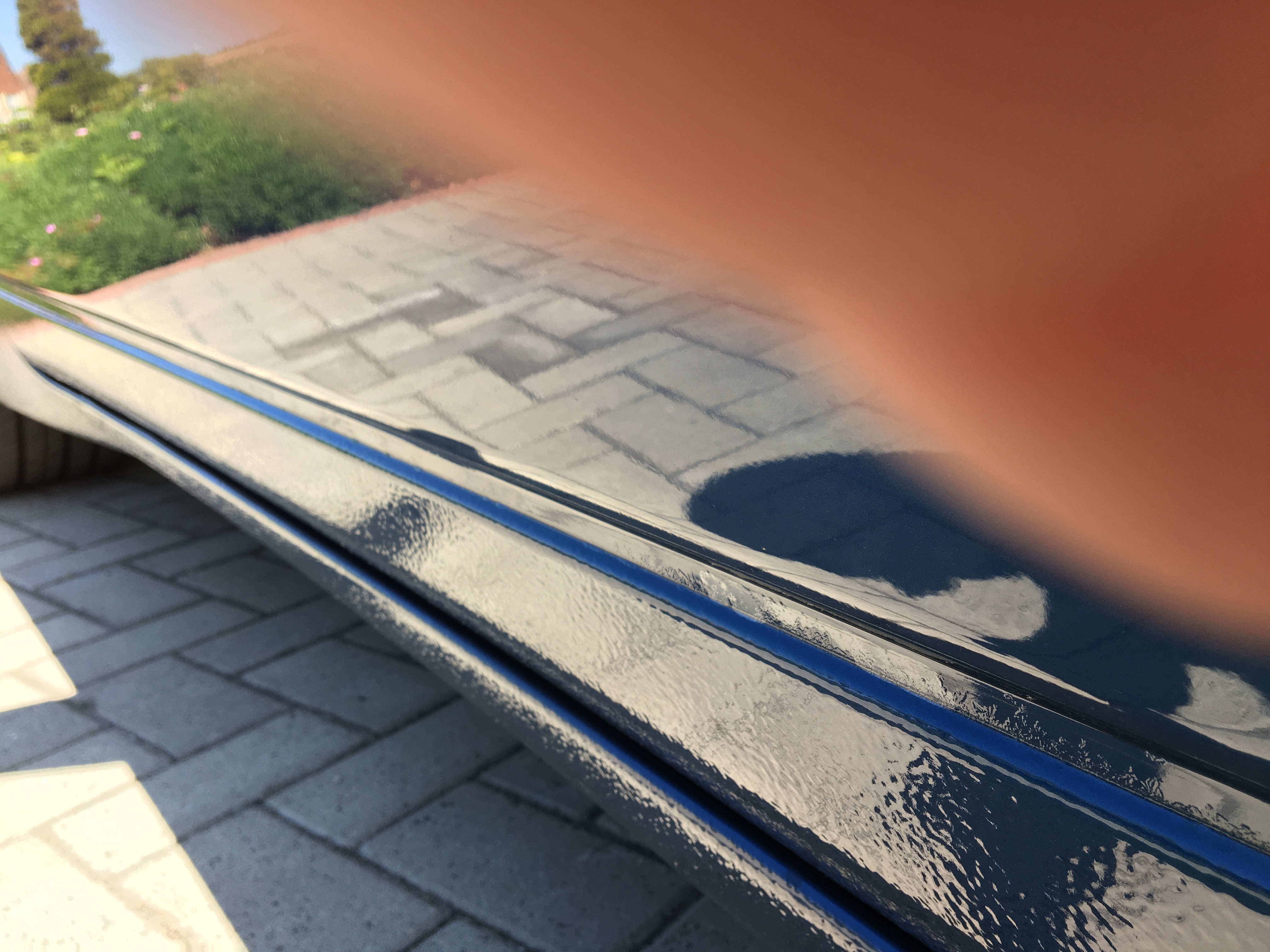

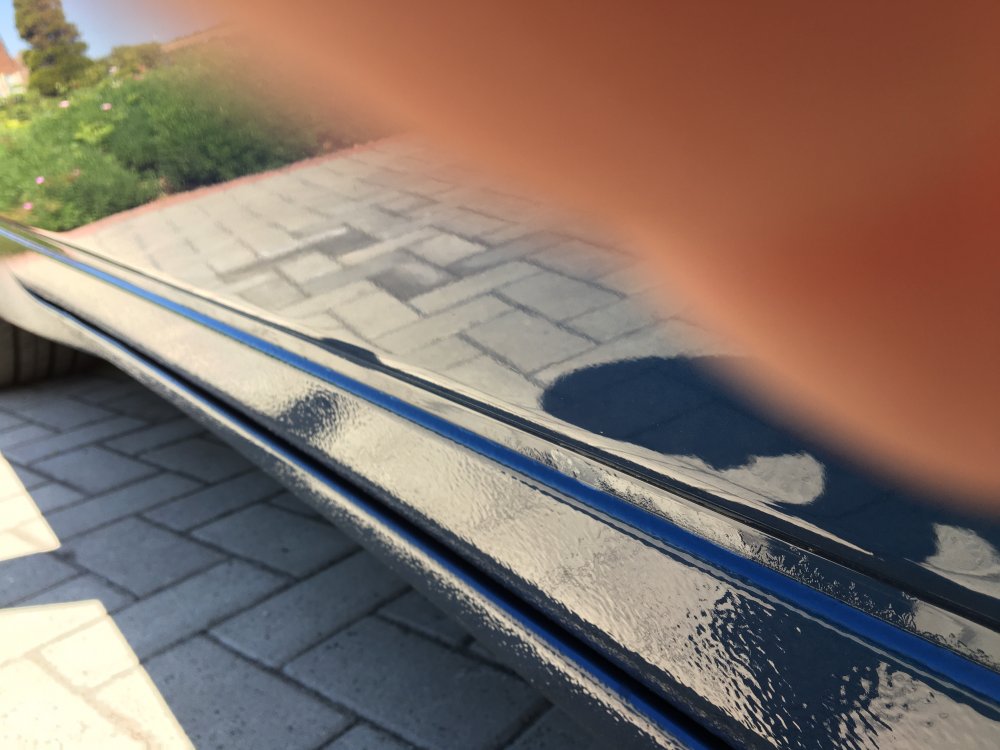

The pin stripe was hiding some crap workmanship though when the car was resprayed when it first came to the uk around 2007. On the drivers side, it was hiding some lacquer peel and also the finish was rough, when it should be smooth. In the pictures it looks like rust bubbling under the surface but it’s actually just the crap workmanship. They obviously struggled to get the differentiation between the smooth body paintwork and the lower body stone chip effect finish.
Not all bad news though as this is only the case on the drivers side. I had planned to get repainted anyway the whole front end, rear end and the drivers door, so this will be resolved then anyway. The passenger side door which wasn’t down to get repainted, is by chance in a perfect state after the pin stripe removal, so that’s a right result!
I'd always wondered about that pin stripe, but just left it alone ?
Satin black is nice on a blue Zed IMO..... I had mine painted on - rather than sticky vinyl :classic_cool:
I'd always wondered about that pin stripe, but just left it alone [emoji846]
Yeah I thought long and hard about it before removing. Funny as RichardS has just said, I thought a black stripe would be ok if I was to put one back on - don’t think I will though.
I’m toying with the idea of doing a full respray rather than doing 50% of the car that I previously planned. Kind of thinking do it right once from the start and not have to go back to do paint work later on.
Not sure though as over and above the extra paint cost, you start incurring massive costs to replace all the windscreen trims etc.
I think due to the fact the paint is around 14 years old it will be tricky to get a perfect match, I've seen 4 TK3 Zeds and all 4 seemed a slightly different shade.
On one the rear end had been painted again and you could clearly see the difference, even though they had blown into other panels to blend.
Maybe get one small area painted, and see how it matches ?

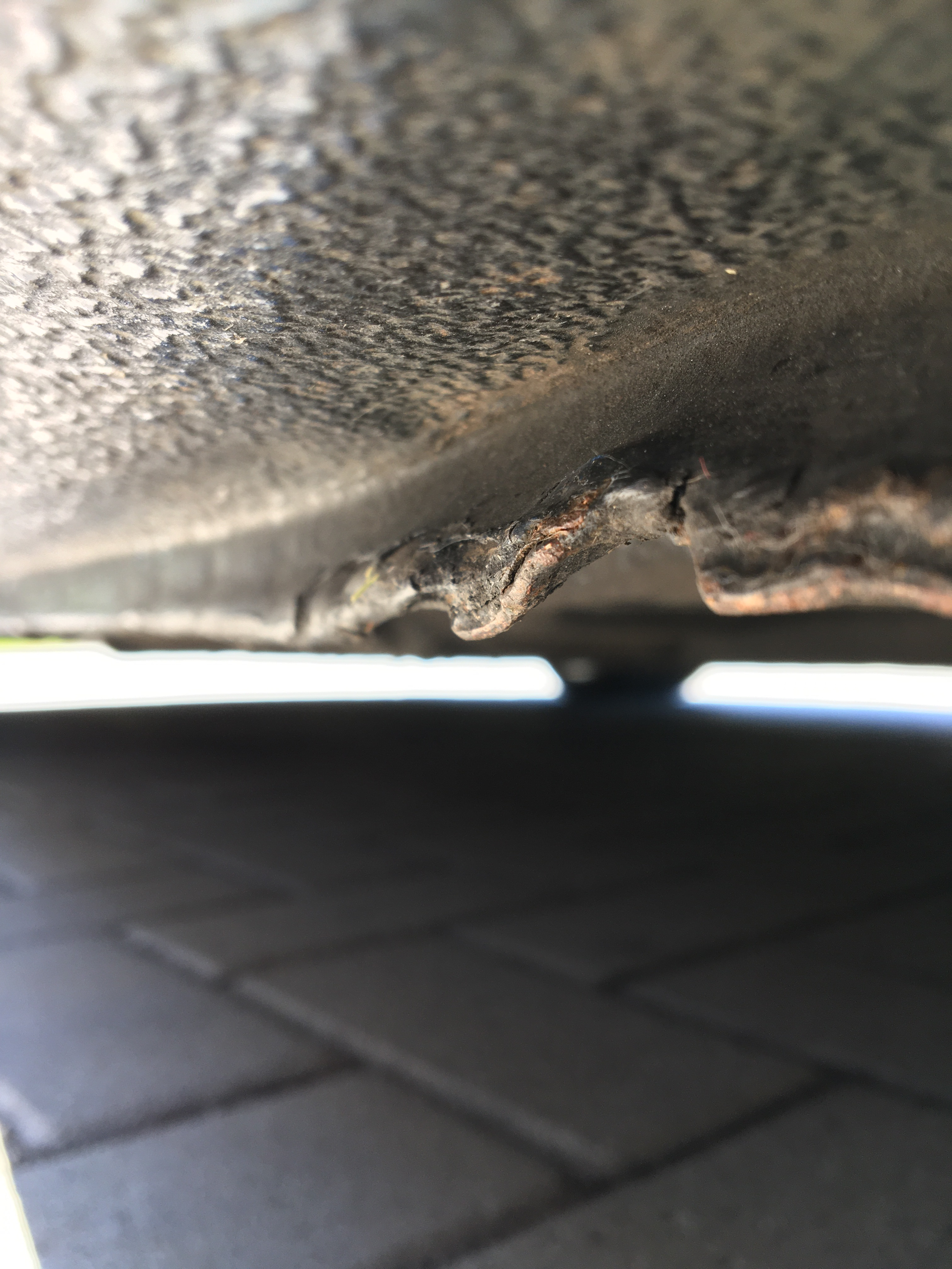

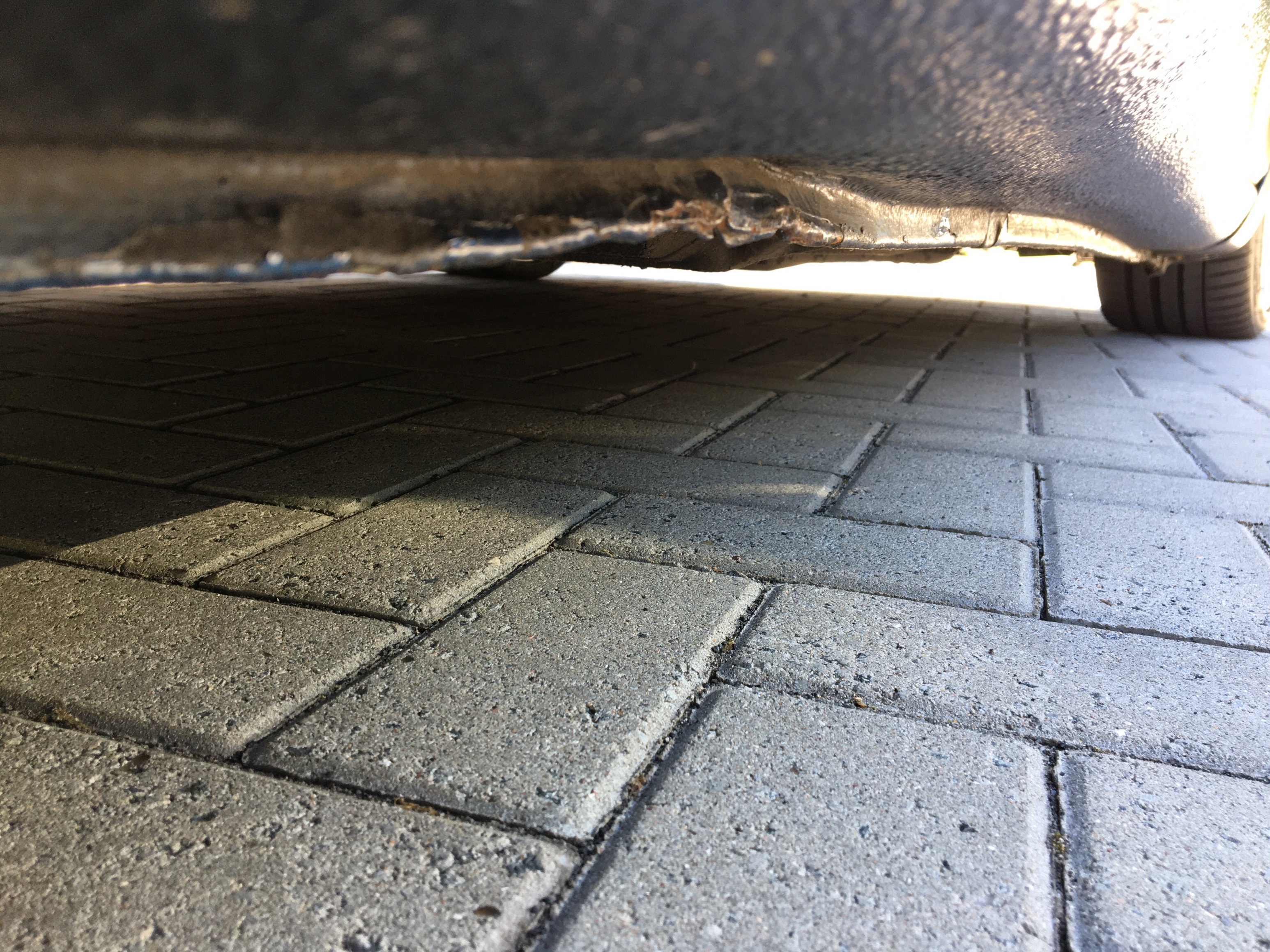

I was going to repair the sills rust myself with the rust busters kit that Jimmer recommended to Akita, on one of the big threads here, and finish with the can of supposedly colour matched paint the previous owner gave me, but now thinking 'whilst i'm there' (famous words) painting the body, I might as well replace the outer sills with the oem ones from ZCentre. Since the car is technically a daily driver for me (only do 5k-6k miles a year), I was going to get the chassis properly cleaned and fully rustproofed with Dinitrol by a professional, by the end of summer. I would do it myself and have done in the past but that was in my old house which had a big double garage. In our new house, we only got a single garage in the back garden with no way to get a car in, and there's no chance i'm splattering underseal over my lovely driveway!
It makes sense then before I get it undersealed, and just before I get the paintwork done, to get the sills replaced, rather than me do a temporary repair only for the rust to start poking through in a couple years, then having to repaint the area again etc.
This is what I meant by if I go for a full respray, I start adding on tonnes of work haha, but think it needs to be done and done properly from the beginning to make sure this car lasts for the long term...

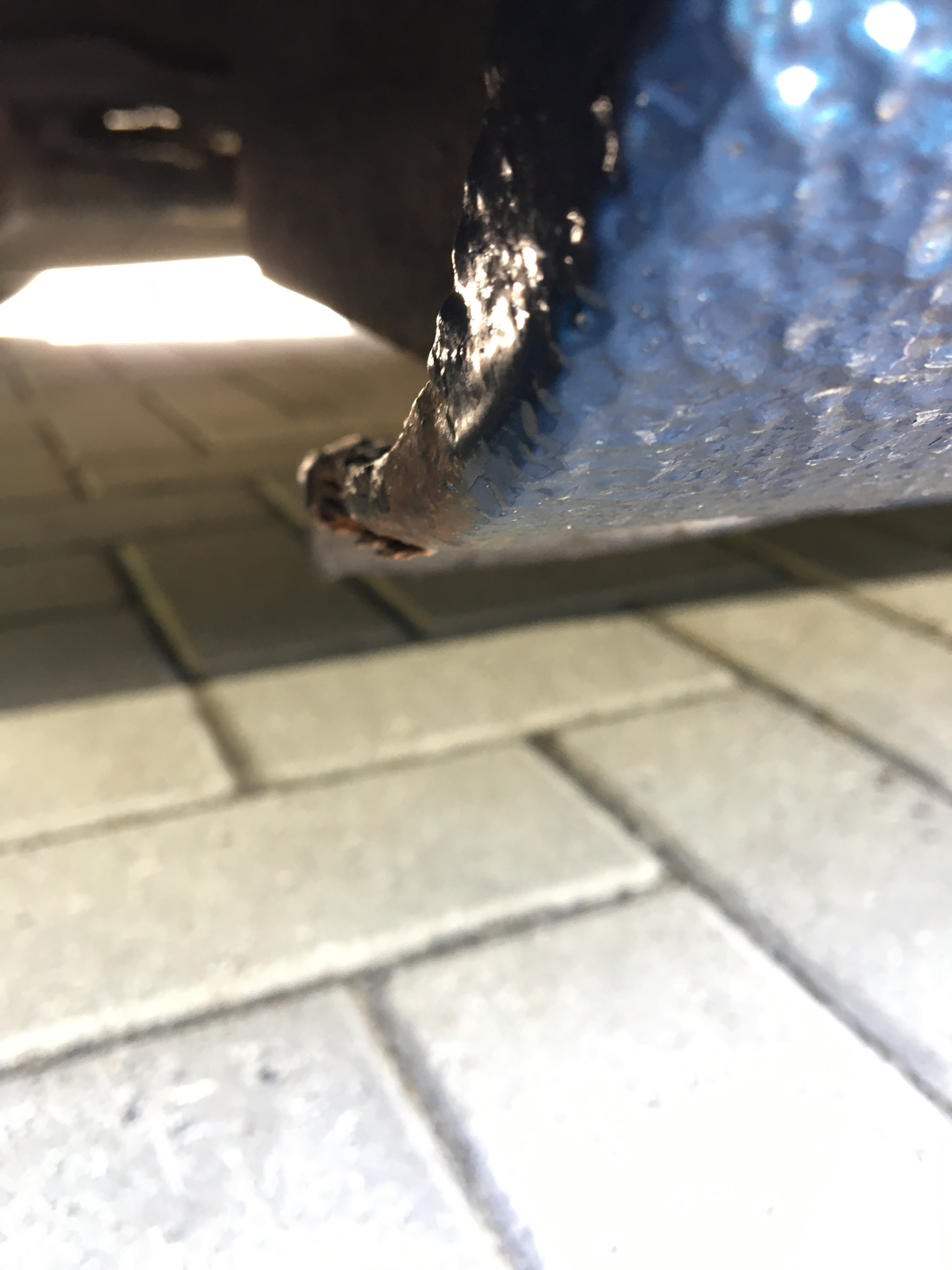

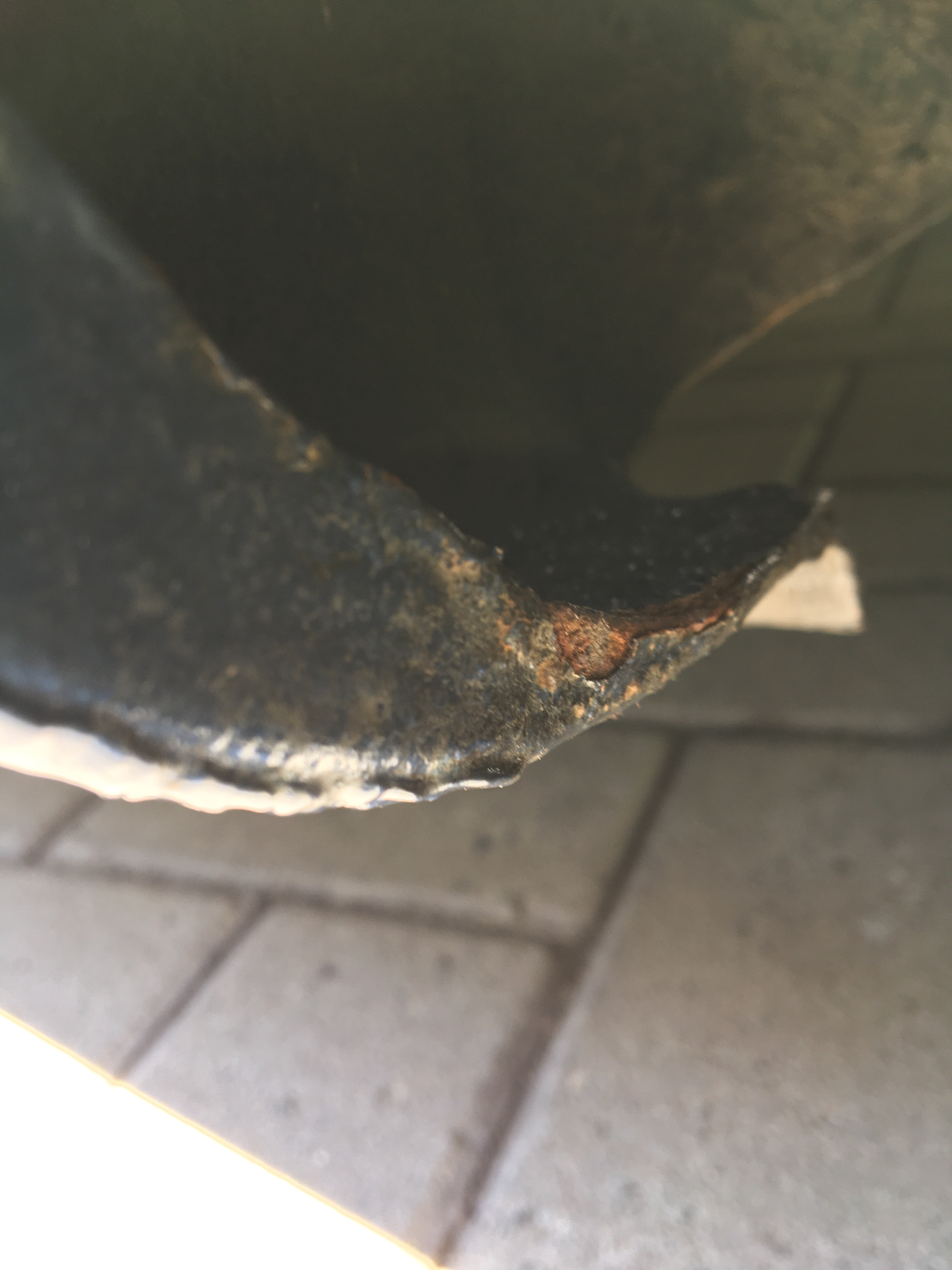

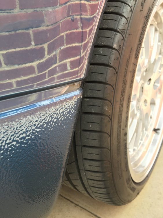

Interested to see the sill rust, how bad is it?
Guess the procedure would be repair sills and any other bits that needed attention, fully undersealed then respray work.
Not cheap but future proofed.

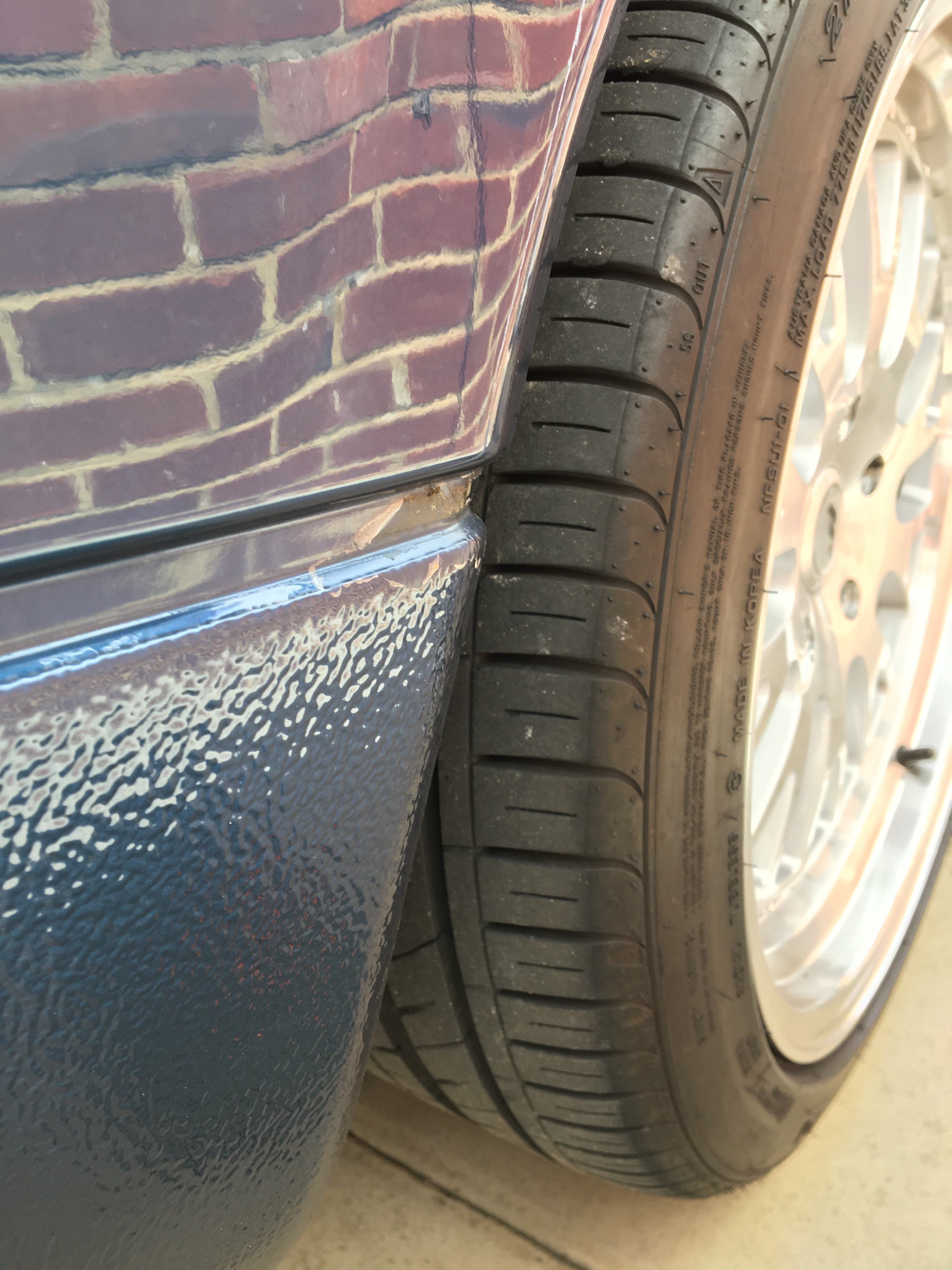

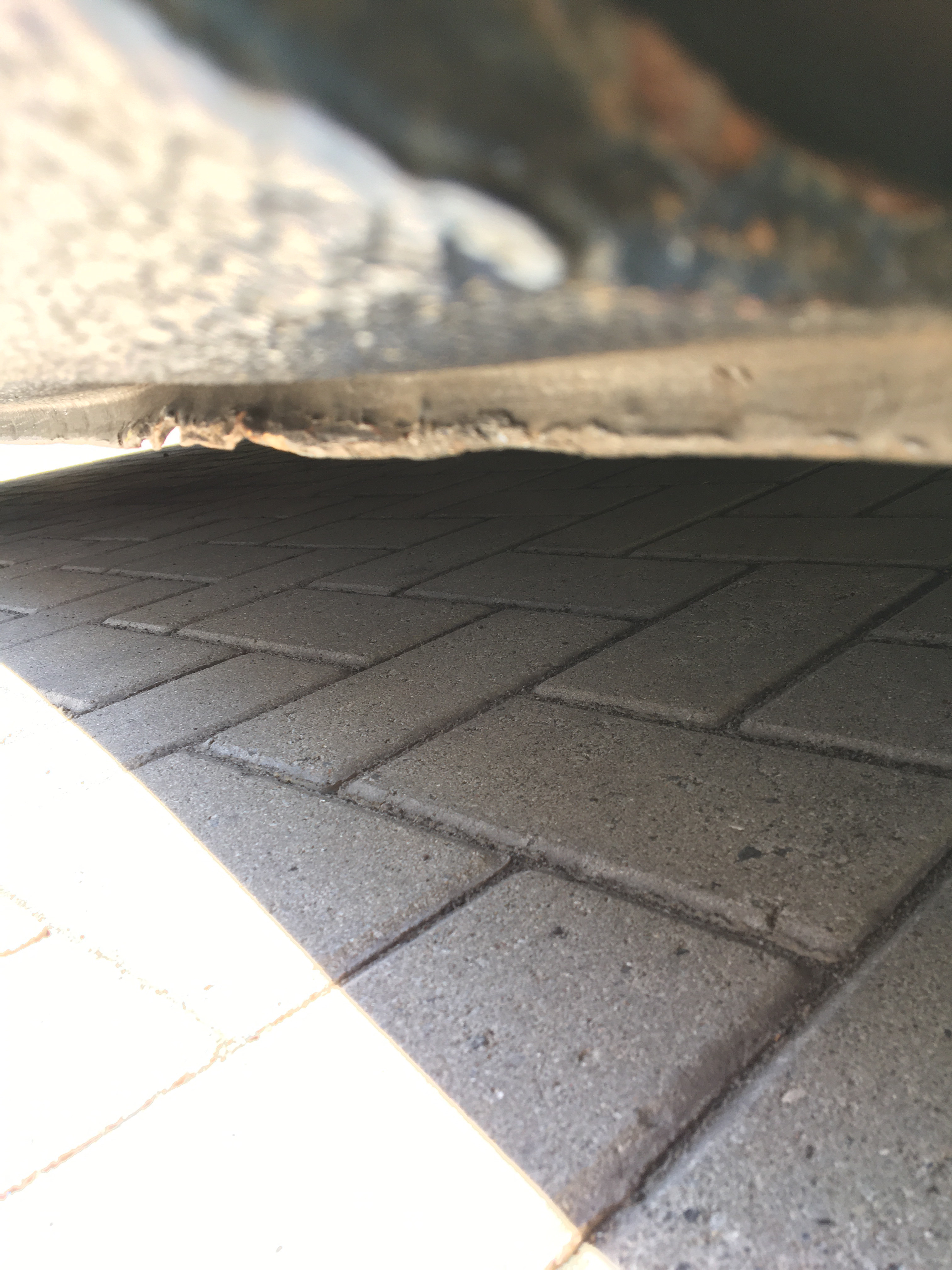

Just took some pictures of the sills finally.
I took it to the bodyshop today
and he has opened up to trade, but he’s low on staff.
He’s quoted me more than I thought but I think it’s worth it. The bonus is he definitely doesn’t think the sills need cutting out - he will grind all sills back to bare metal, repair properly and sort in house so that’s a saving. Overall taking into account not having to buy replacements, it’s about £1k more than I thought [emoji857]. I guess I was over reacting with the sills so that’s a bonus I don’t have to buy replacements.
Hi I would take the rear quarter trims out, you can get a phone and take pictures, the sills rust mainly from the inside out.
2004 BMW Z4 30i
1991 Nissan 300zx TT Project
1997 Jaguar XK8 Scraped ☹️
Oh I see - thanks for the advice; I’ll do this over the next week or so, see what the state is and take it from there.
Doesn't look too bad, but you can never tell until they strip it, shame the sills are bent though, some idiot has gone in there and jacked it wrongly or something, always hated people doing that.
When I had it up here it was only used during the summer and only then during dry weather 95% of the time, and it was clean, it's changed quite a bit on just a few years.
Yeah luckily my regular garage respect the car so jack it properly. Although their bread and butter is modern cars, they specialise in classics anything from Jag E Types, Aston DB5’s so you know they’ll treat it well.
Summer only driving makes a world of difference to daily driving. Ollie drove it as a daily for one year then used it only as a weekend car. As well as using Jimmer who’s about an hour from him, he used quite a few local garages for minor jobs probably for convenience like I do, and they’re probably the ones who buggered the sills.
Don’t worry though mate, after I get the bodywork and undersealing done, it’ll be mint once again! Ollie spent an absolute fortune on it mechanically, which probs left him low on funds to do work to the body. He covered the sills in dinitrol though and went over with touch up paint, which helped stop it rusting worse I reckon.

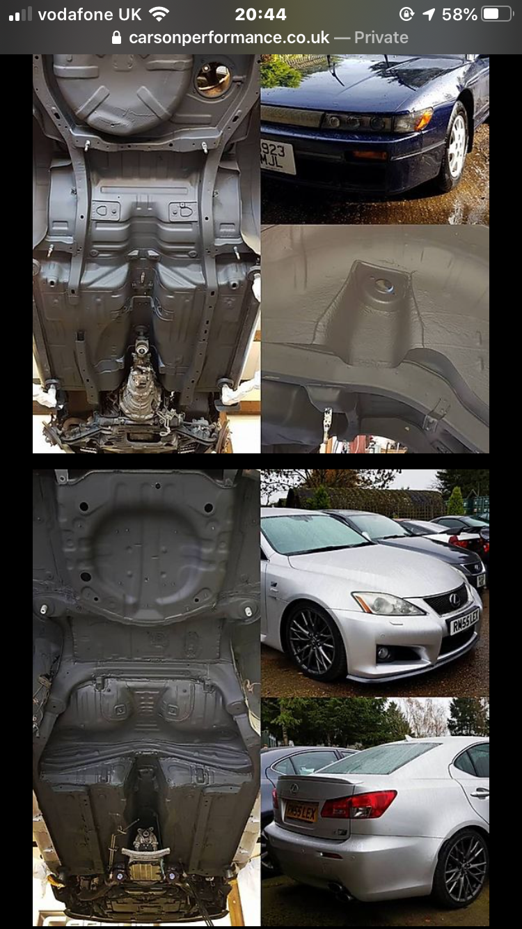

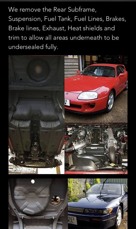

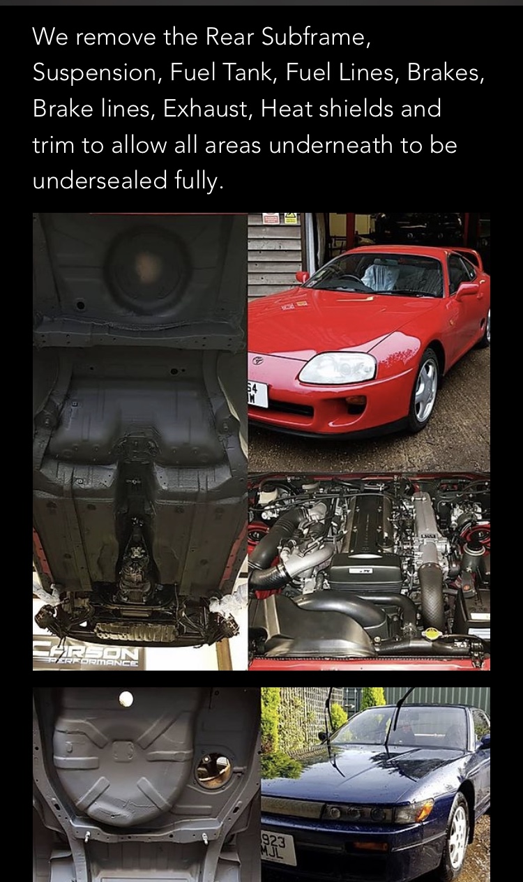

I’m getting a quote from a well known Jap car tuning firm who do proper undersealing. They strip everything from the underside and do a proper job, as per below pictures. This combined with me giving the chassis a clean after winter annually, should keep my underside in great condition. I also won’t drive it when they salt the roads.
Just got to wait for an update from work hopefully this week on the madness that’s going on at the moment, before pressing the button on all the above.
