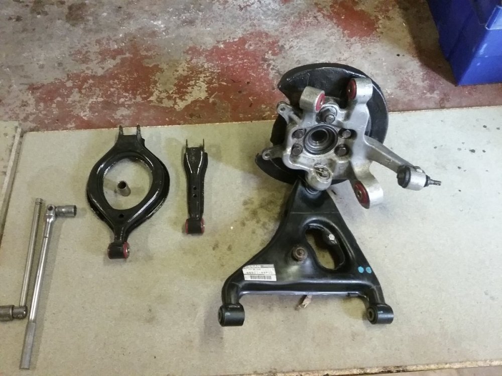

Did mine last year, i got polybushes and rear steer joints from concept z performance
Most poly bushes went in easily but one was tough took a lot of goes but got there eventually.
Good luck with yours.

Yeah red energy suspension bushes if you lube properly squeaks should not be a problem, i have no squeaks.
I did front and rear , i renewed  lower suspension arms which have ball joint in them. And also renewed rear ball joints on hicas
Made big difference to handling on bends.

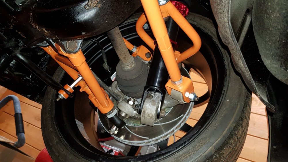

12 hours ago, JaiKai said:
When i done my rebuild i replaced everything i could aswell as the top arms which are fully adjustable.
I'm now riding with 19" wheels and a perfect alignment.

I just renewed bushes using a vice and plenty of the white grease supplied with the red energy bushes which I bought from concept z performance rear cost around £70 posted . Fiddly but not hard.

Hiicas ball joints needed press to get out, if you try in situ aluminium arm could easily break.both of mine were shot so needed to be changed.
