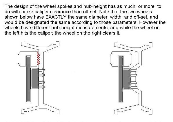

You will also need to take into consideration the design of the spokes of the wheels regarding caliper clearance.
The picture below illustrates the point. Which wheels are you interested in?
Exactly what Andrew says.....!!
I learned a hard lesson last year, I bought a set of wheels which theoretically should have fitted. All the sizes and off-sets were in line with what me and many members had successfully installed on their Zeds before…. However as the spokes were dead flat, the front wheels still fouled the brake calipers; as in the first picture above.
