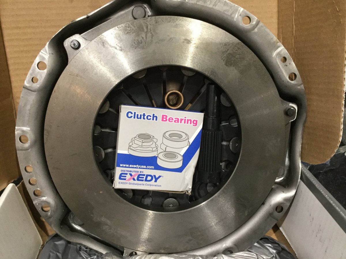

I have a manual gearbox to install.

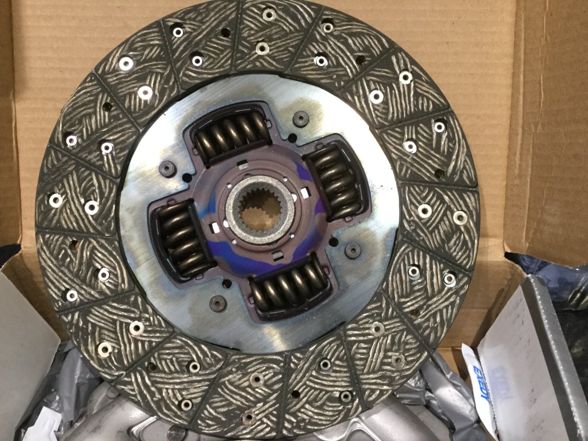

I purchased an Exedy Pro-Kit (complete clutch kit)
i want a lightweight flywheel but have been informed that I need to purchase a whole new clutch kit & L/w flywheel.
Has anyone bought a lightweight flywheel separate & fitted it with this clutch kit I’ve purchased?
Hi Andrew,
I was informed that a lightweight flywheel is not compatible with the kit I have purchased.
I have seen a kit advertised by techniclutch in Lancashire who appear to sell the same set up as my purchase but with a XTD lightweight flywheel.
When I spoke to them yesterday they said the clutch & lightweight flywheel had to be purchased together! But I cannot see a difference.
Also XTD 5.7kg pro-light flywheel sold by XTDclutchuk separately says non turbo.
Then XTD pro-light racing clutch flywheel sold by  aimcoclutch 90-96 300zx TT $200 inc shipping which is much better than £400 for a whole new kit.  So a little confused.
Many thanks
Art
Yes it is 06046 !
As the 06046 is sold as an OEM replacement clutch which will therefore work with a stock flywheel I can't see why
it won't work with an aftermarket TT flywheel (lightweight or otherwise) that is machined to the same dimensional
specifications as the stock TT flywheel. Provided both clutch and flywheel have been properly balanced seperately then
they should work fine together.
Just bear in mind Art that the weight or rather mass of the flywheel has function, it’s mass is to carry inertia and make the transition from stop start smoother and keep the engine turning. I’m not saying you will notice but you might be paying for something that doesn’t give YOU a desirable benifit. Bearing in mind iirc you wish for your car to be a cruiser rather than a angry thing. Just something to consider.
Do NOT fit that lightweight flywheel by XTD or any other like it.The ring gear is rubbish and chews up !

i have just ordered from Z1 a TT lightweight flywheel  which they have confirmed it is compatible.
Art
1 hour ago, art213 said:
This is why I like this forum!
thank you  all.
Art
The Z1 Flywheel is basically the same i am afraid Art.
I see that Z1 have two TT lightweight flywheels - a MK1 and Mk2 version. Which one did you go for?
Edited by AndrewG
Hi Andrew,
I ordered the Mk 1 I assume as it states the "old style" 4140 forged steel at 11.3 Ibs
Jimmer are all lightweight flywheels for the Z no good? Am I better off putting the old OEM flywheel on?
Ive only got a standard TT no power upgrades.
The SPZ fw is very good but many of the others are very poor.The Z1 version is the same as the XTD,The ring gear is soft and wears quickly in my experience.Id stick with stock in your case being honest.
