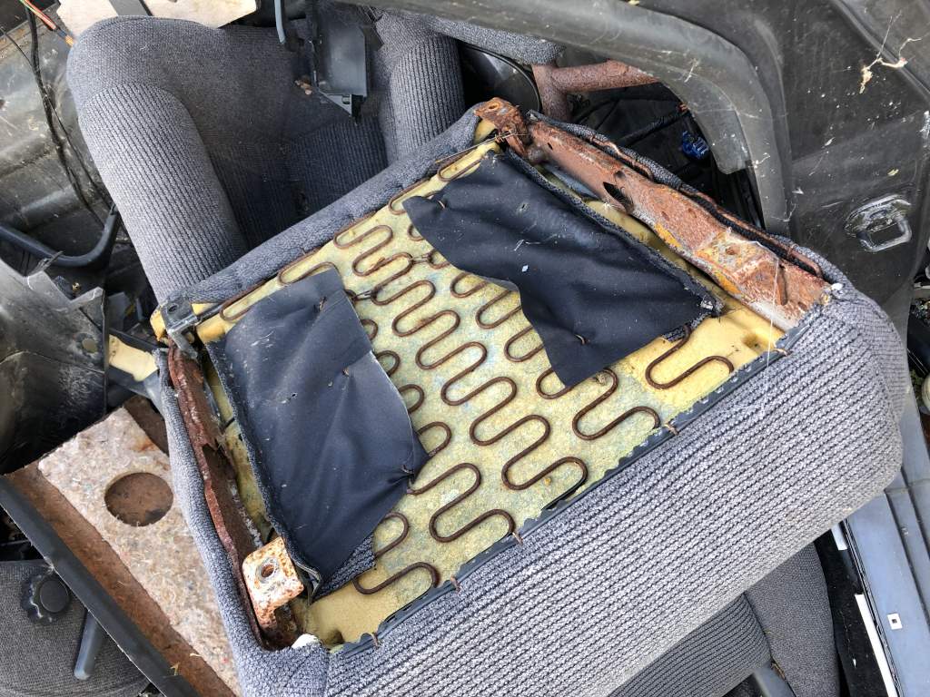

[ATTACH=CONFIG]118724[/ATTACH]
Full manual. Sorry mate.
