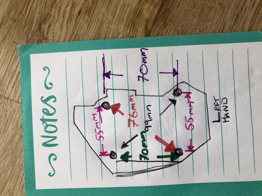

If someone's got the audio brackets out, could they please measure the distance (hole centre to hole centre) of the screw holes - I'm thinking that getting a tap to ream out the holes in the radio to 5mm might be the simplest solution.

Pardon the bad drawing but I thought that better than trying to tell you the measurements.
Let me take a peek in my box of old car audio fitting tools..... I'm sure I have nearly every type from back when it was my living.... lol
Thanks Chris300, spot on.

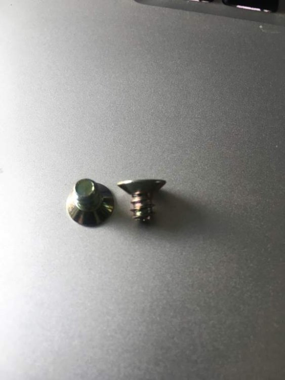

Like these???
Aha! Looks like veilside01702 had the right ones. The JVC ones arrived today and here's a pic of what they sent (top - they fit) and these look like veilside01702's pic. Does anyone know what they're called? Obviously, they're not M5 8mm long. The others are the shop-bought M5 and the OEM ones sent by chris. I don't think the ones from JVC or veilside01702's are the spec that JVC put in the manual (so I've pointed that out but don't expect any change. They also came in a little pack with 4 countersunk and 4 domed so my guess is these are bagged for use in Japan units but taken out as cost saving for export. Hey ho, you live and learn.

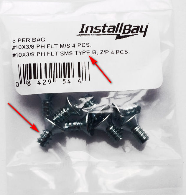

Mike, they are in the ebay link I provided above (Type B thread).
More examples here:
https://www.valuefastener.com/sheet-metal-screwsself-tapping-screws/type-self-tapping-screws-c-100_624_880.html
From the pics, I see what you mean. But neither of those Ebay listings say they are 5mm dia screws which is what the JVC manual says. If the JVC manual had said ISO screws or #10 3/8 or if JVC UK Head Office had said what to look for, it would have been easier. But when they tested in their workshop, they agreed with me that "the screw size it said in their manual didn't fit" and didn't have an answer.
Plus my previous experience that the OEM screws have been OK for all the other units I've put in/taken out (including the last JVC). So far, the score seems to be AndrewG 1: the combined team of 2 Ebay sellers, Nissan, 2 screw experts, JVC manual and JVCKenwood UK 0. :D
