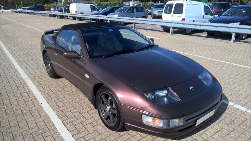

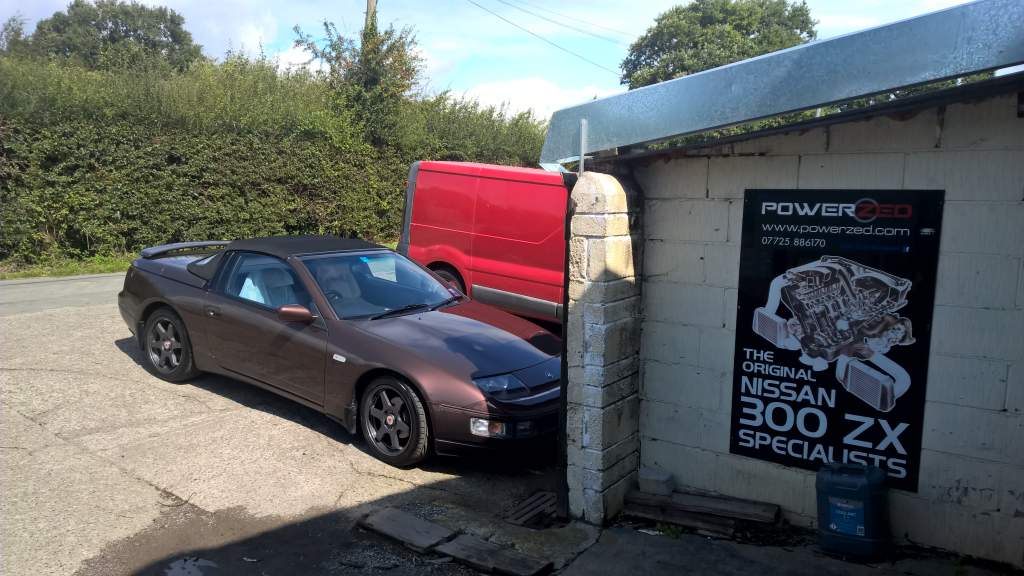

Picked up Z#4 today from PowerZed (hi Jimmer) after timing belt, a/c condenser, plugs, fluids and a bunch of other stuff.
Homeward bound.

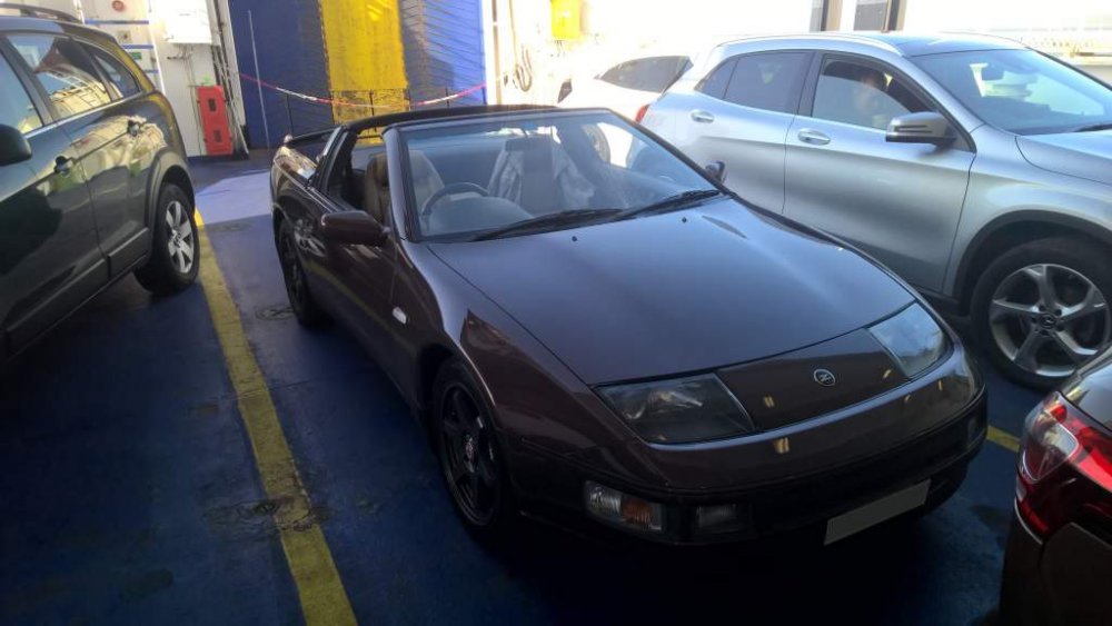

To prove I took the top down on the ferry :)

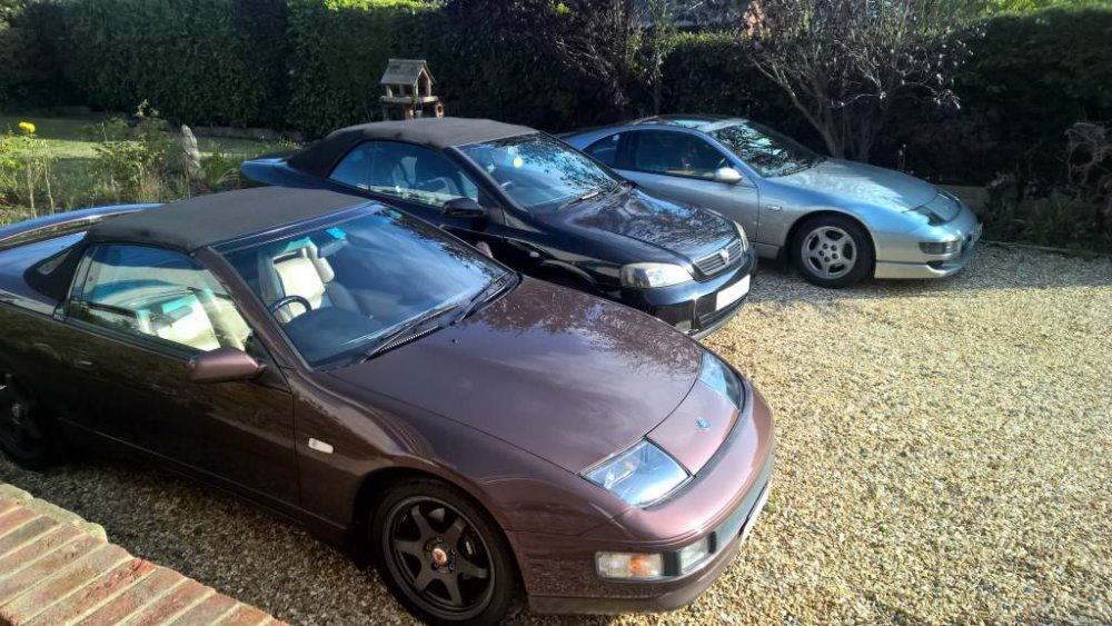

The fleet. How many Zeds is too many? Well, 2, actually - so let me point out the silver 1999 is still for sale :)
