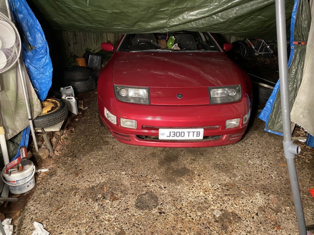

Hi since I smashed up my beautiful Green 1995 300, I have been driving my older 300 most of the time being my only car, I had to take it off the road yesterday fo some major needed repairs.
Lucky I still have the use of my brothers 911, seeing he is still living in Hong Kong.
I am so embarrassed at how I have neglected my car, but only doing 1 - 2 thousand miles a year and having a bad back (no excuse really) it is now time to sort everything out before the next MOT.
Having sold most of the parts I had collected, I have been getting ready with the long list of parts I now need, how the prices have gone up, can’t really believe it.

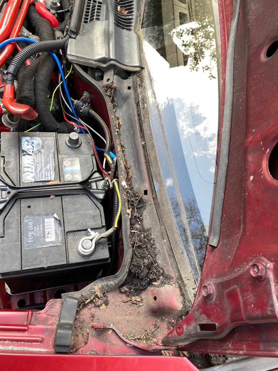

Started stripping her down yesterday, what a mess.
The only good thing about so much oil leaking is those areas are rust free.

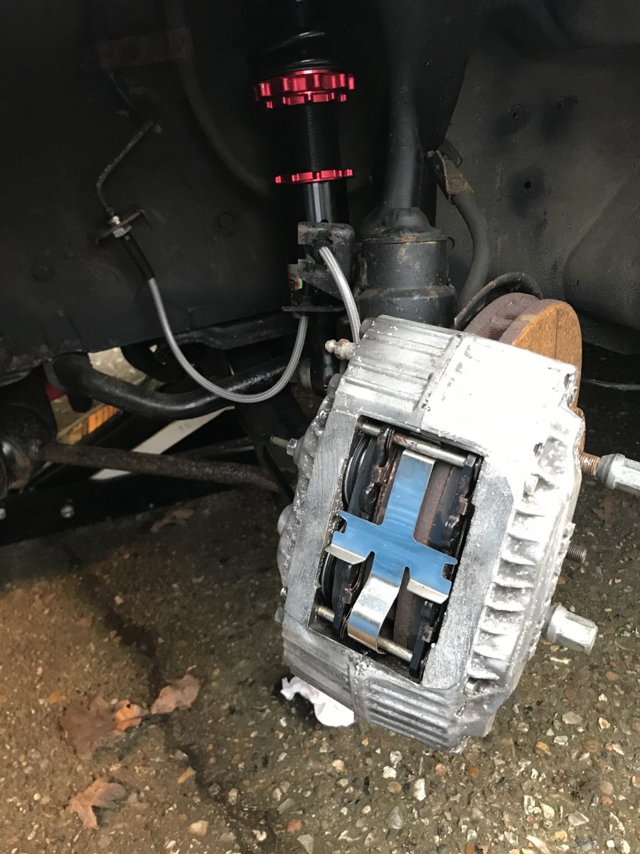

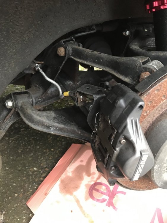

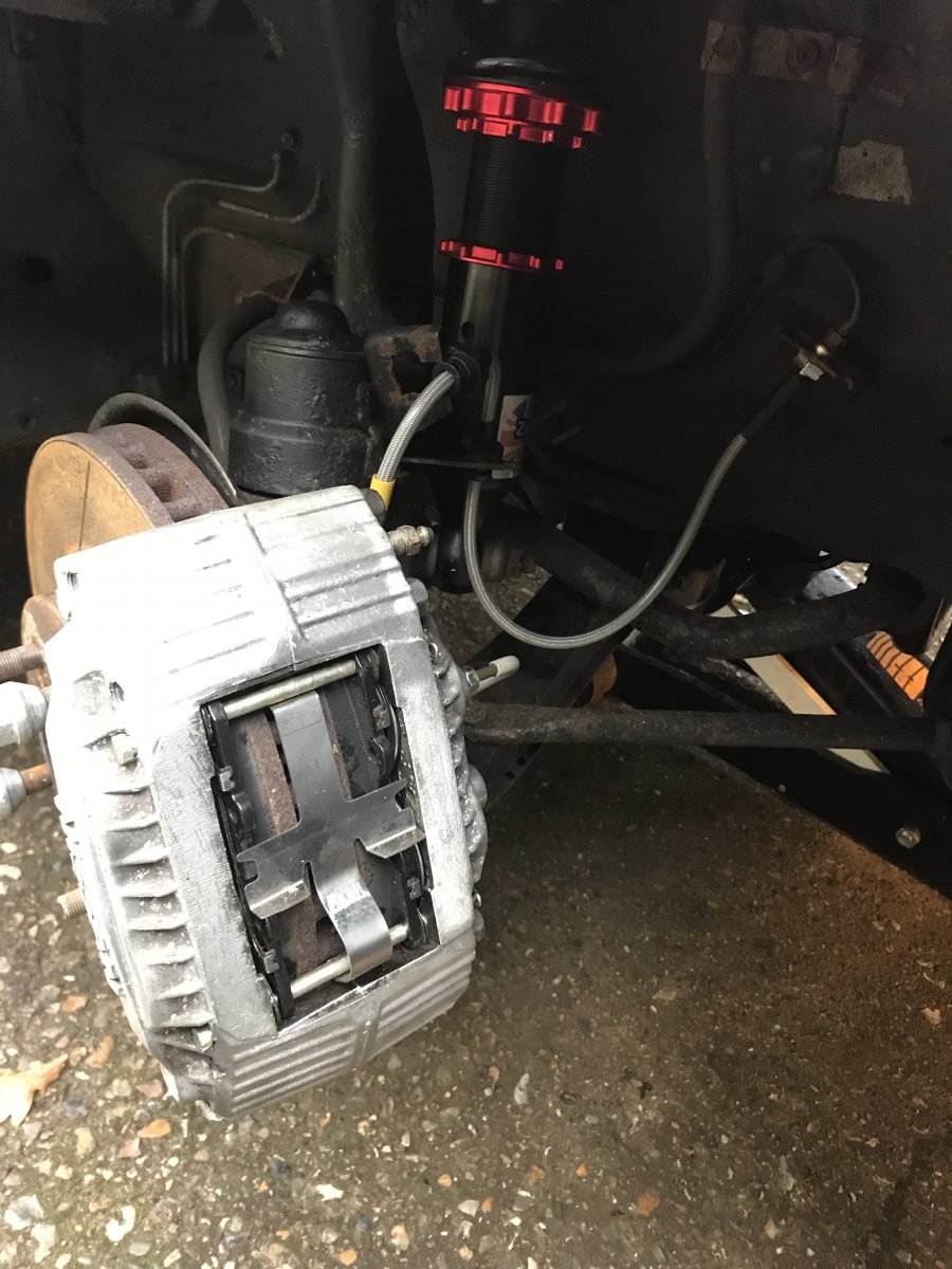

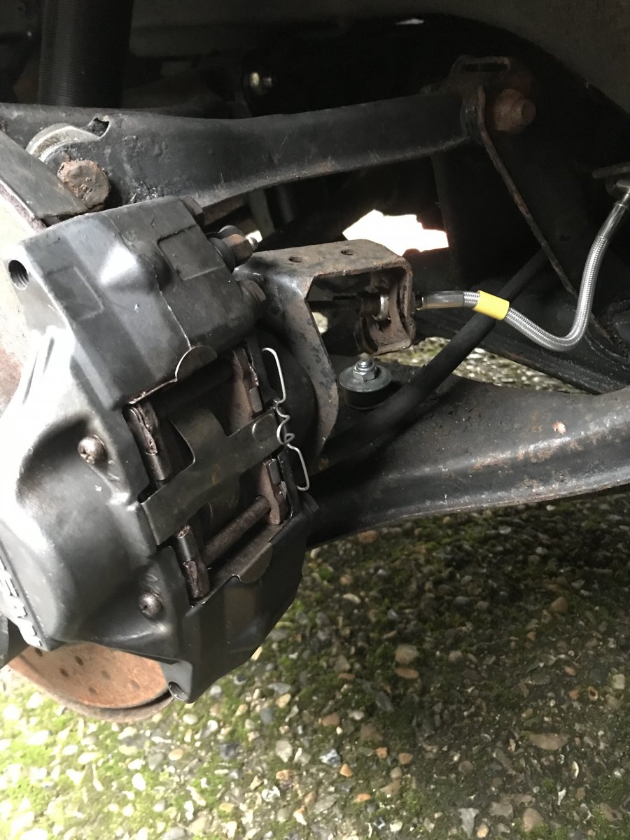

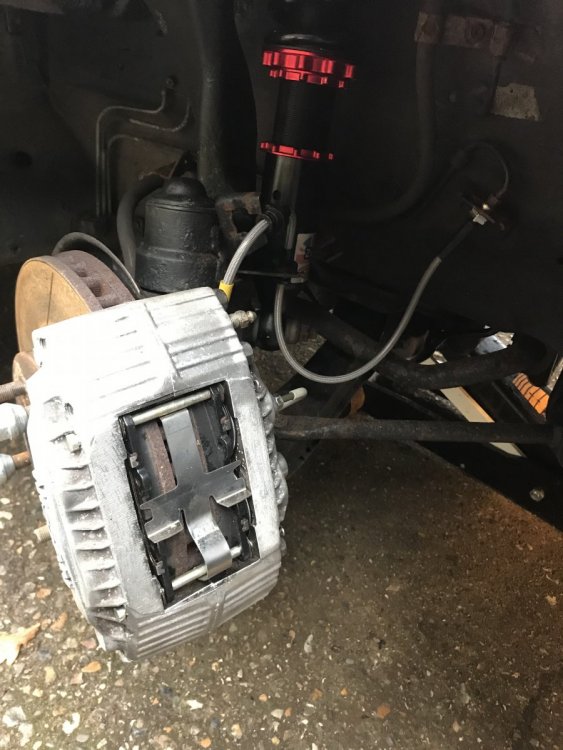

Started work on the car again, managed to get the brake callipers on.
1C4F1984-A326-4CD4-A946-2038B7CC5CCC.thumb.jpeg.9e29ae9a180fa086fc6950b2ee22bcfc.jpegB1CDA391-AB5C-460F-97C8-D04438C99183.thumb.jpeg.9ac77932093acd3bfde572c5d624531c.jpegF6A8647B-E009-4C3B-8492-D8DB39640B44.thumb.jpeg.2840fa4931f297711e88a12740b4ca35.jpegC7CA9683-E6FE-49EC-A5CE-3155BEFFD744.thumb.jpeg.61046f16321703ddc9b8ca4a16d52910.jpeg

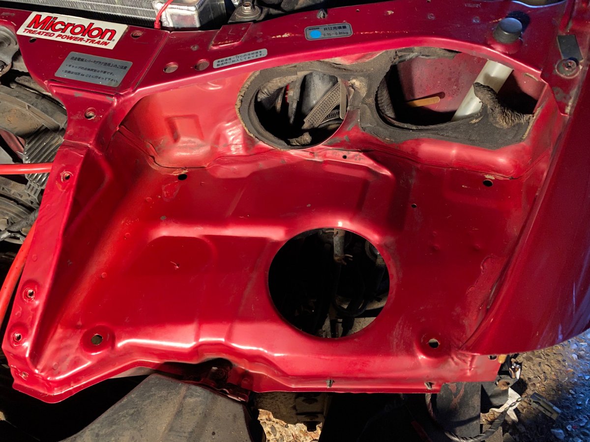

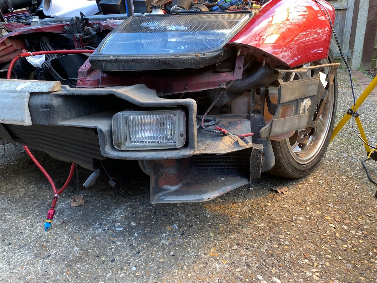

Can’t believe another month has passed and not much done. Today I removed the front bumper to clean things up a bit, glad to not see any bad rusty parts, bits I can see will be treated. I have booked an MOT for Friday afternoon fingers crossed, still have tracking to do and sort my headlamp problem I’m going to disconnect the dim-dip unit tomorrow hope that fixes it.
0F2075F2-6446-4AEE-B840-D1C2F7096355.thumb.jpeg.ddeb51d01edd7283921454442d2aa031.jpegAB7B2B8E-EF78-47BC-BF9F-EC757643BDD4.thumb.jpeg.445c390df8594581b08a05cbf1de950c.jpeg

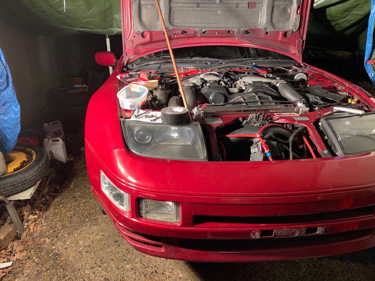

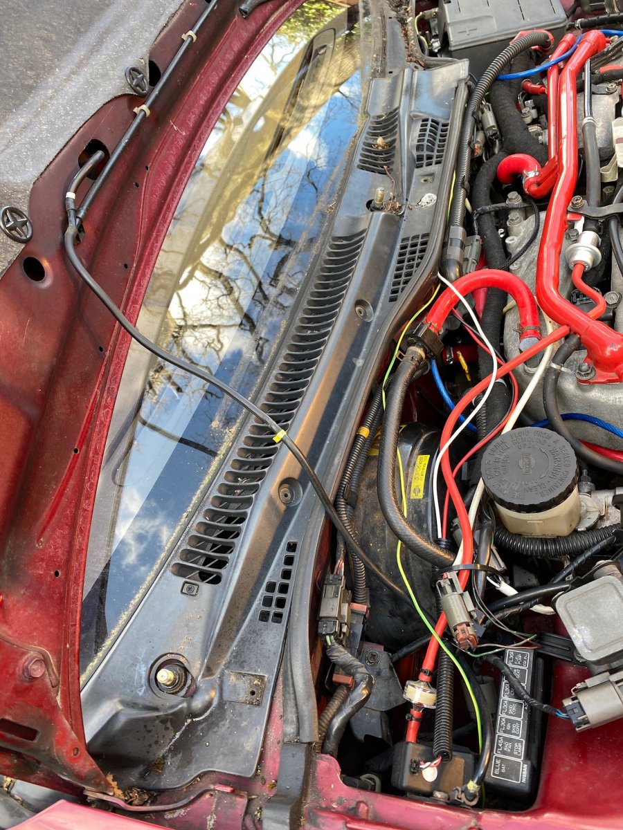

Well what can I say that’s acceptable, not much finally tracked down my headlight problem took most of the day.
Long story. So short version, right dipped beam fine left dim
main beam RH fine LH not working
after testing many wires I found the wire from the relay in the fuse box to the light pod in the car, both pink wires RH with black stripe LH with silver band. RH continuity working LH nothing, so made a wire from the pod to the LH relay and hey presto lights function as normal, what a pain and lost a lot of time, still lots to do before MOT at 3pm tomorrow not sure if I will make it but fingers crossed.
247578A4-5B93-40DA-8010-1BCD0CEB795B.thumb.jpeg.79a2b28af934c7f38a33251f7b74dc59.jpegDDABA710-631F-4172-8EE9-0B85578E475A.thumb.jpeg.f2823928dd87a4da2a9e31c91342b922.jpegone done might have to leave other side now for another day.

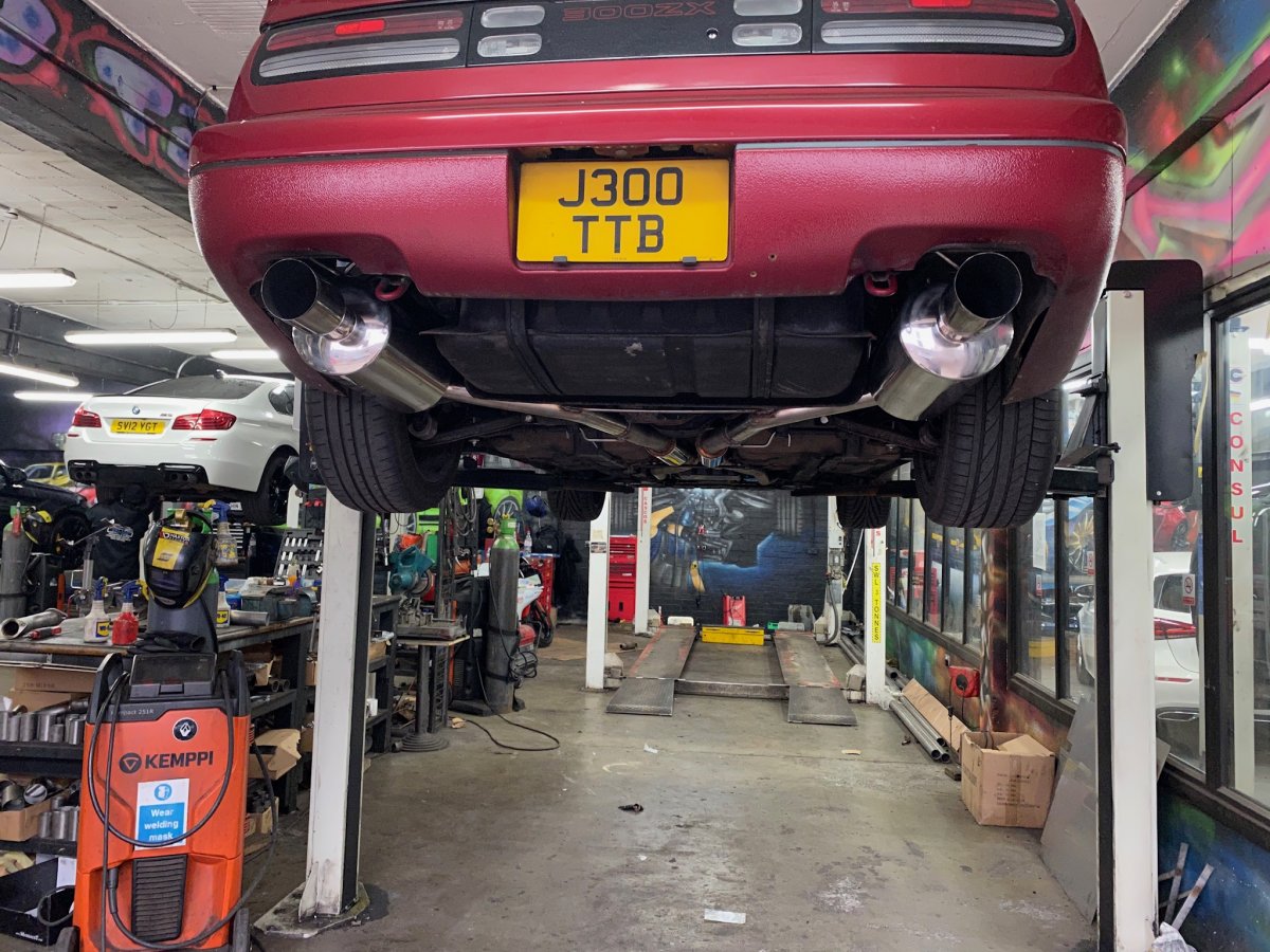

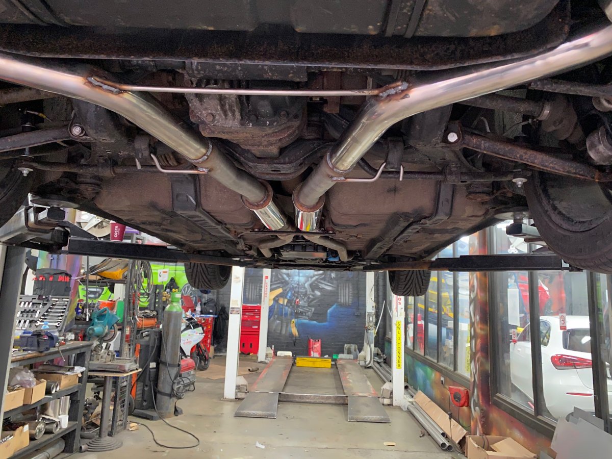

Went to get the exhaust sorted today.
C860D400-8E2E-45E9-93BC-E8C3C36DE28F.thumb.jpeg.78123f9f41e72b03a829304fde17fa11.jpegEF4F77CD-0A09-49CE-9FBA-5F914D43D819.thumb.jpeg.ea8934f93dd2d8f110c1756e8935fcaf.jpeg
2004 BMW Z4 30i
1991 Nissan 300zx TT Project
1997 Jaguar XK8 Scraped ☹️
14 minutes ago, AndrewG said:
That looks like a LOUD system Tony.
Looks but it’s not loud I live in a flat and said I did not want the police to hear me coming lol.
2004 BMW Z4 30i
