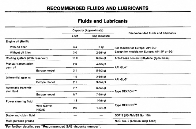

Hi
I am looking at changing the gearbox oil on my 1993 300ZX TT Manual, any suggestions on what oil to buy? are the drain and fill plugs individual? is it easy enough to replace at home on axle stands?
TIA
Adam
MT90
Drain and fill plugs would always be individual. Drain plug is on the bottom and fill plug is on the side. Fill until the fluid to the point at which it's to flow out.
