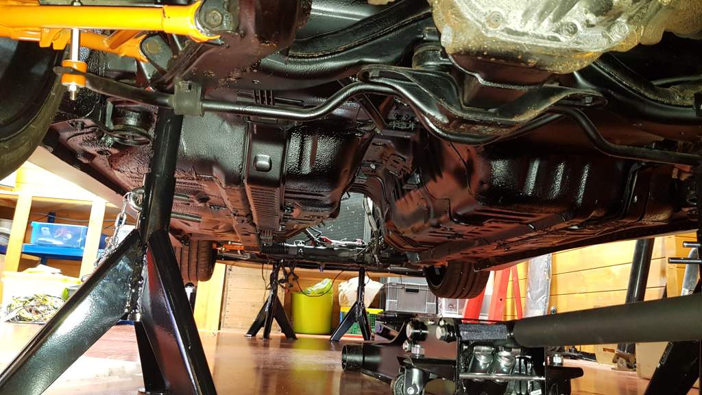

i did mine 2 years ago with dinitrol, rubbed down any exseeive rust patches and treated them with rc900, then a coal of ML (3125) which is like water and seaps between any panel joints etc, then 4149 over the top, works really well. i have currently got wax oil in the sill cavities which was put in when i had them welded but i need to reapply the sills with dinitrol next year.
