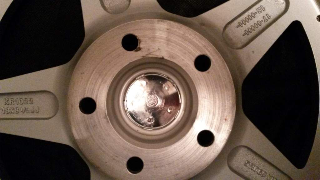

Because he’d have to cut the end of the OEM studs with a 10mm spacer as the studs would protrude too far into the wheel mating face. Here’s a random google pic to illustrate, they have also kindly marked the pic showing the protrusion.
He would also have to faff about finding nuts that were slimmer than 10mm (which would be questionable on the amount of threads to grip). He’s on about using hub-centric spacers that don’t bolt on so there is no compromise on safety, it just requires longer studs and in this case is most certainly the way to go. The Eibach kit that Pete has linked above is what you want Richard, great quality those (just check it comes with 10 studs and not 8 as pictured!).
