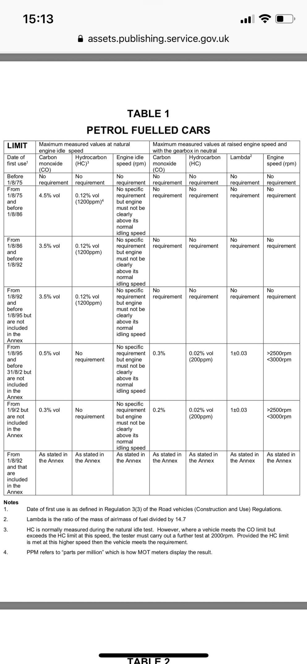

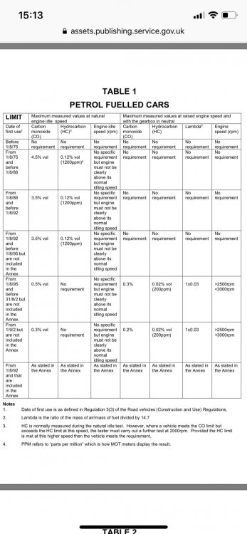

90% of 300ZX’s DO NOT NEED CATS for an MOT. It is NOT listed on the Appendix for Emmisions testing and therefore only has to comply with a Non Cat Test. Only vehicles with manufacture dates after Aug 1995 are subject to the tighter emmsions tests
Page 12,134,135,136 and 137 are the relevant pages
https://assets.publishing.service.gov.uk/government/uploads/system/uploads/attachment_data/file/676700/in-service-exhaust-emission-standards-for-road-vehicles-19th-edition.pdf

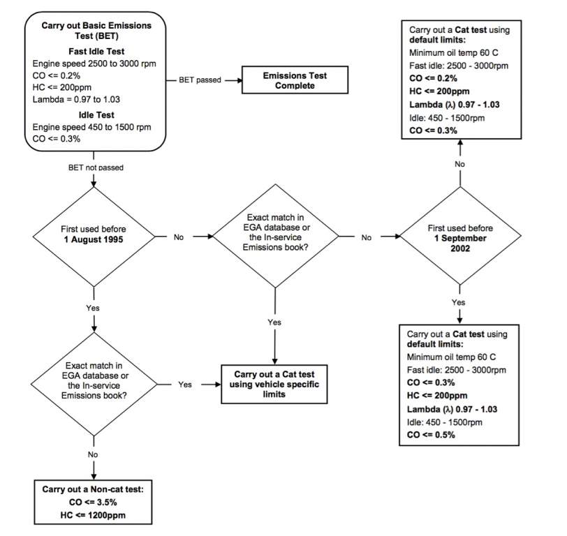

This is the flowchart that should be followed for an MOT emissions test. The important point is that the Z32 300ZX
is NOT in the "EGA database or the In-service Emissions book" So for Z32s first used before August '95 a
"Non-cat test" should be followed.
