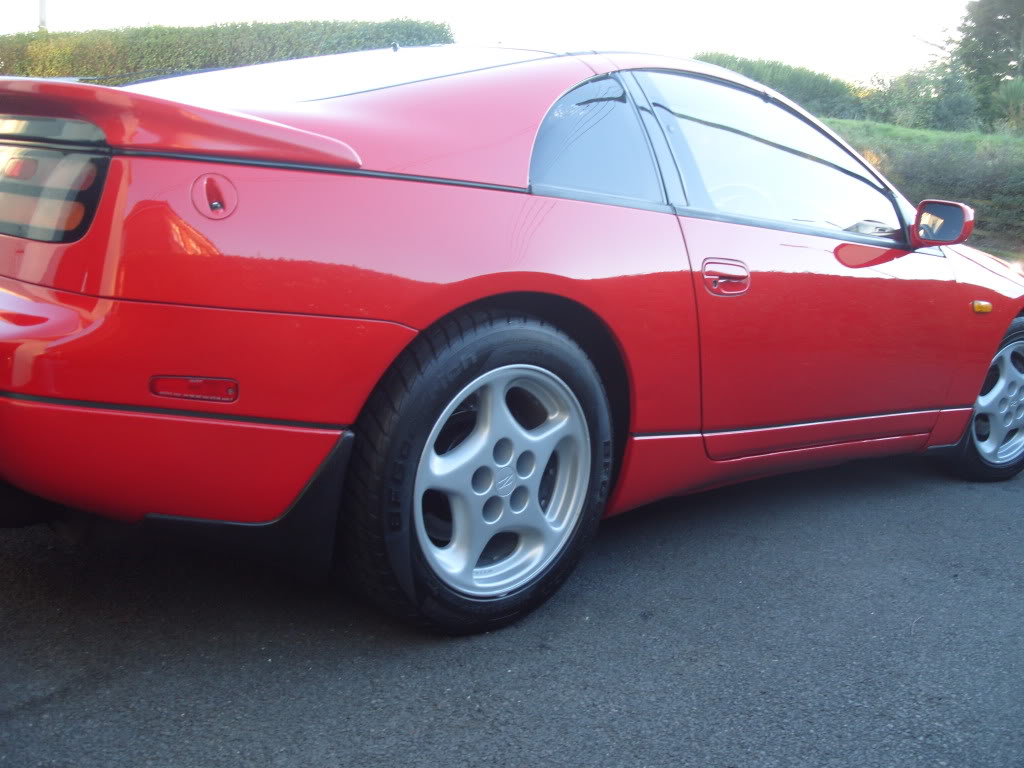

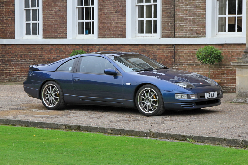

Are you using standard springs too Gaz? Some picture of how it sits with 18” would be nice. :wink:
Jeff, what springs did you use and what wheel size? Also a few pictures would be nice if you have them please?

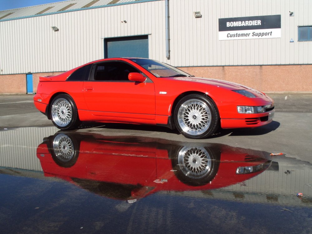

Chassis Dynamics 50 mm drop, tricky to get hold of these days though, pics below with 18" wheels
https://www.europerformance.co.uk/pages/products/category_results.mhtml?category=hrsprings&car=nissan300zx&manufacturer=hr&sub_category=1&category_sub=loweringsprings
Jeff

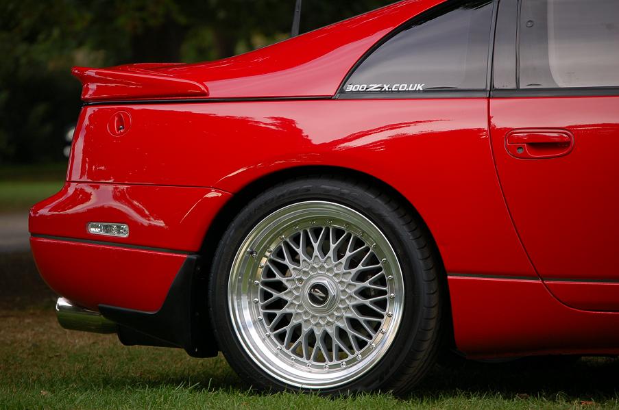

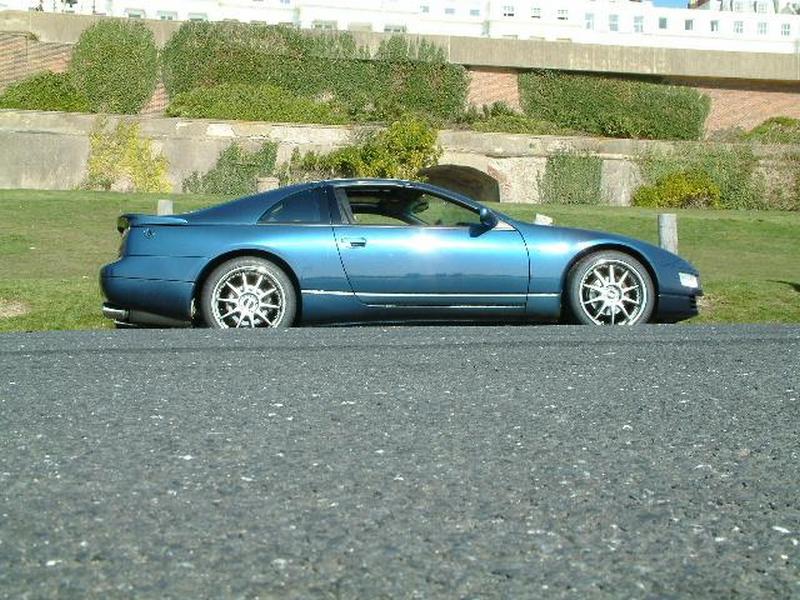

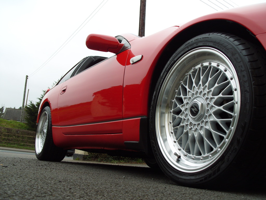

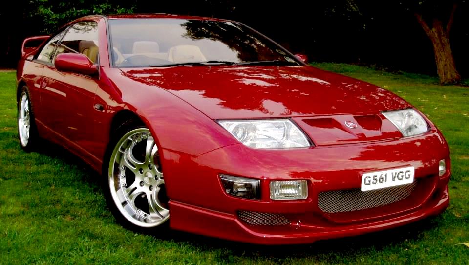

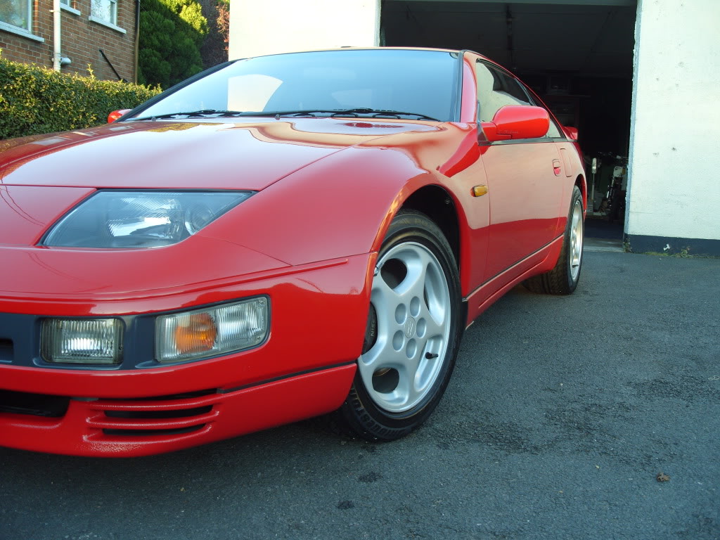

OEM springs and shocks with OEM wheels
With OEM springs and shocks and 18" wheels. (25mm spacers on front hubs)
OEM shocks and springs on 18" wheels:
KYB shocks/Eibach spings (0.8" drop) on 18" wheels:
The Eibach springs are NLA but come up s/h. The KYBs are still available:
