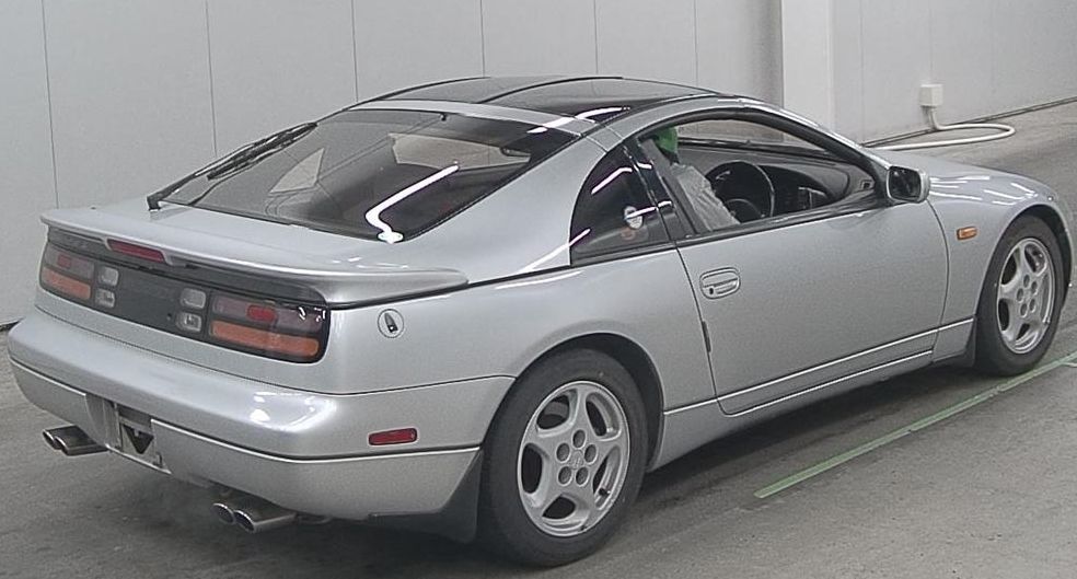

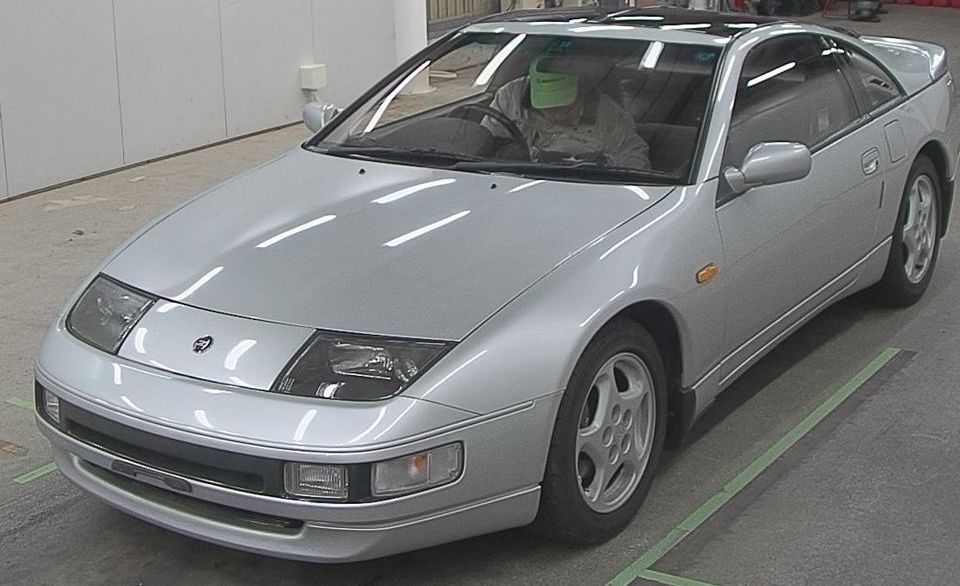

Another couple of pictures from the Japanese auction some months ago !
Pretty nice to go for a car with 4 pictures :)

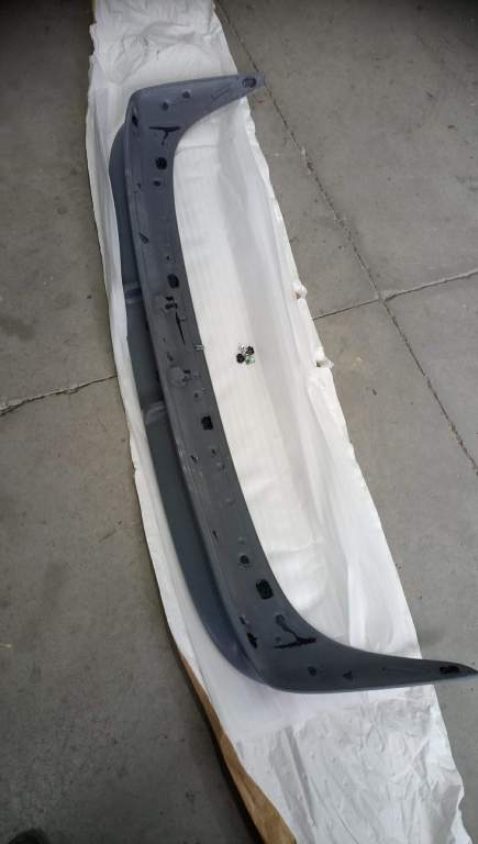

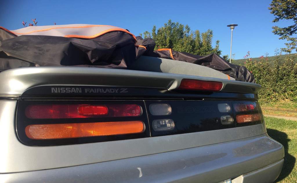

No problem, here goes :
As the wing of the imported was a bit tired of the years under Japanese sun, I was looking for a replacement. As I looked everywhere, it was pretty hard to find used OEM wing in decent condition, as the foam material it is made of, tends to age badly and it gets harder and harder to paint.
I was lucky enough to find a brand new OEM wing (J6030-42P28) on a UK genuine part website. it is of dark grey color, ready to be coated. I bought it and had it directly delivered to the paint shop.

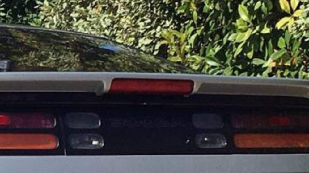

Everything made it fine to the paint shop, but the wing was not painted right away, as some other work needed to be finished first. It looked like this :

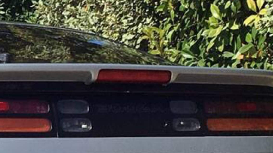

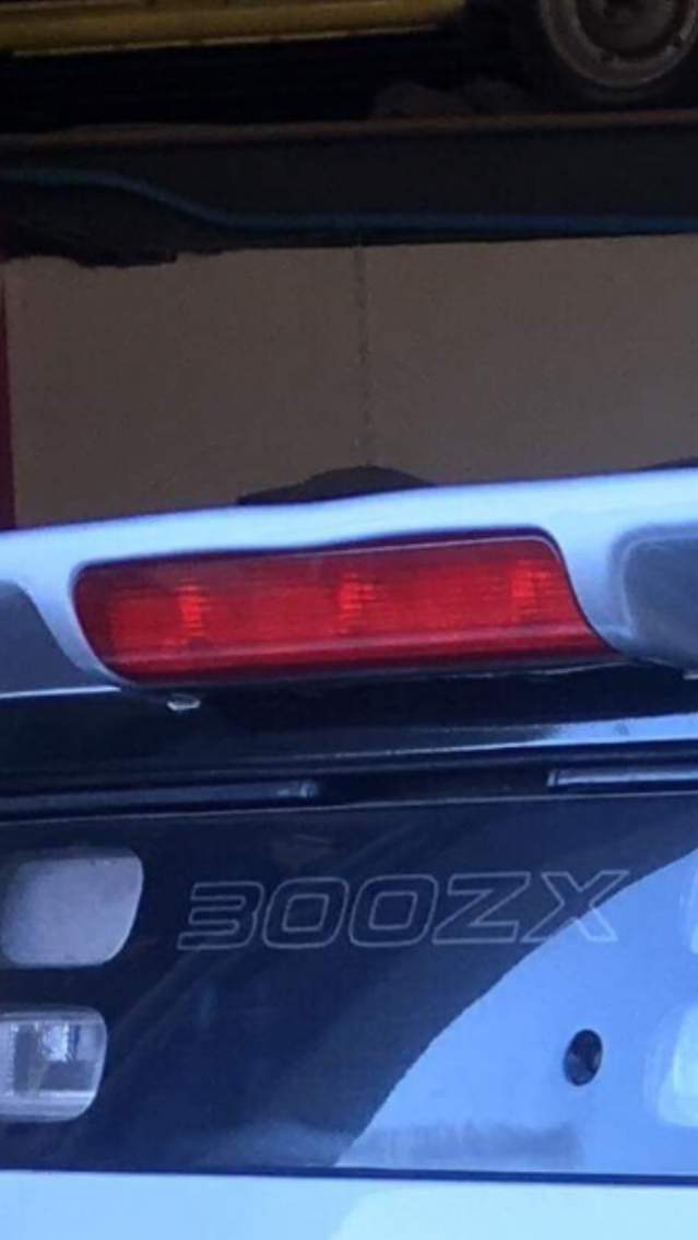

When it was finally painted (3 weeks ago), I got photos of it and notice that the wing was somehow sinking right in the middle of the 3 break light... (see photo below)
Which is not really the way it should (photo below of the imported car, and anyway of what it should look like) :
After asking around on all sides, I end up being pretty screwed, ah ah :
- The paint is not responsible because they claim the wing was painted and stored on a flat surface without any chance of possible damage. They rather say it was delivered with this damage,
- The defected cannot be reworked due to the material softness,
- It is too late to send back the wing to the UK shop... as it is now painted and more than 3 months over order !
Well... as my only option to remain 100% OEM is to source a new one from Japan for ~1000€, so I will end up buying a nice fiber replica instead :)
Regarding the paint job itself however, it has been done very well, the key seems to use the right kind of primer due to the foam material. So be sure to check it, and for sure inspect the wing itself in all detail so that you can revert in time if damaged... Hoping this will help !

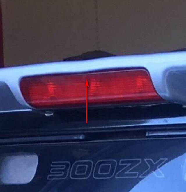

That looks like storage or transport damage. Before you give up with it try removing the third brake light and apply upward pressure to the
bend in the spoiler (see arrow below). The spoiler is formed of a thin steel frame covered in foam and then the plastic outer skin. You may be
able to deflect the steel frame back at that point into shape. It's worth a try as the J6030-42P28 spoilers are by far the best fit and finish
compared to fibreglass replicas that I have seen (and I have experience of both).

I agree with Andrew. I’ve not seen a good replica yet and the OEM may very well be ok with a little pressure.
Thanks a lot for the good tips and advice !! I will definitely give it a try when I get the Z back from gear box repair.
I hope I will manage not to crack the paint by doing this... :)

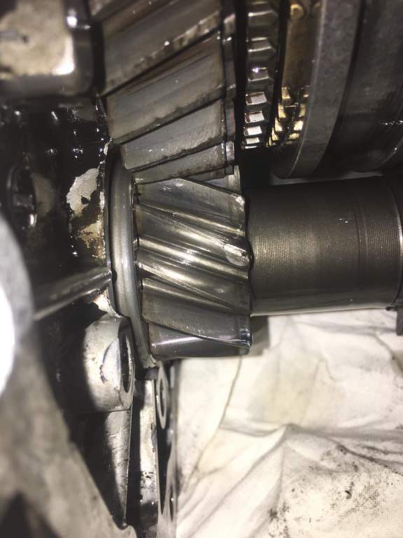

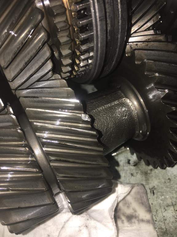

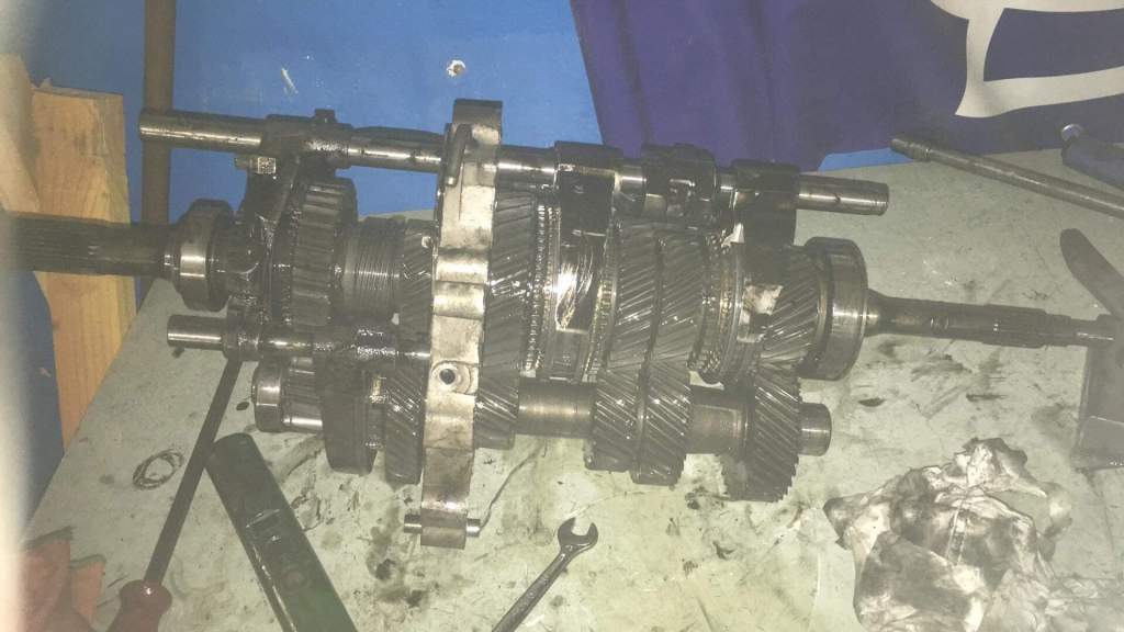

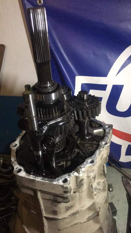

Hello everyone !
I finally got some fresh news from the garage regarding the gearbox... well, doesn‘t look so good indeed, the fear box is badly damage on 2nd and 4th gear shafts, as you can see bellow. We are checking what is the best solution now, but looks like I‘m good for a used gearbox..!
Cannot see what caused so much damage, the car has only 130000km :(
I‘ll be glad to hear any advice from you :)
