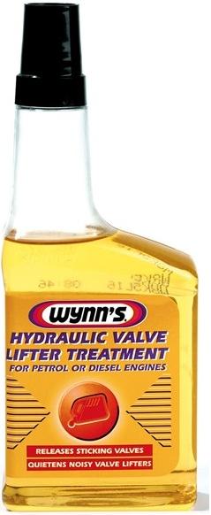

Do not normaly advocate additive`s but what you need is Wynn's Hydraulic Valve Lifter Treatment, we used it many times in the workshop on customers zeds and the results were always good and safer than using flush.

Thanks Jeff, with this valve treatment do I add it to new oil and leave it there, or do I change it soon after?

It is designed to be left in there so makes sense to add it to fresh oil if you can, that said that is not absolutely necessary, make sure your running the right oil too, any good brand 10w 40 semi-synthetic is spot on, do not be tempted to go for fully synthetic.

I'm getting new oil plus treatment tomorrow thanks again Jeff
