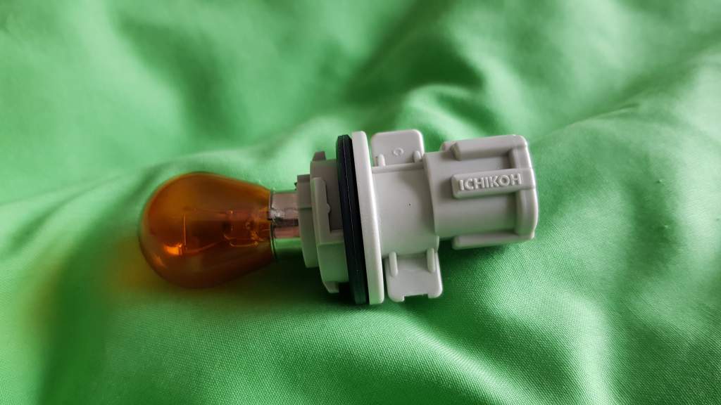

this is the bulb that this harness requires ;

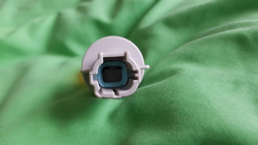

this is the bulb adaptor that i want to use but i'm not sure what plug this is :

I have millions of bulbs. I'l see if any of them look right for you. Are the pins straight opposite each other or are they slightly off centre opposite?

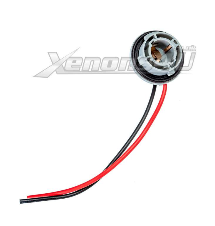

Iiuc your side lights are the 501 bulb holders ?
You want me to send you 2 holders with tails foc ?
Hi Jaikai it’s a BMW bulb ... Osram 63122695020 21/5w available on eBay.... item number 221937178044.... hope it helps.... Russ
if I understand correctly he doesn't desire dual filament bulbs, just the 21w part, not the weedy 5w !!
Pm me your address Lee and i'll get the 2 x single filament bulb holders away plus some bulbs if I have them, have I to assume you want amber coated ones ?
Here's the thing; as said in the first post two ways I can go about this with the parts I've got.
I have a single point, single element tinted orange bulbs and bulb holder that came with the 99 Spec lenses.
I can't currently fit these at there is no cable on them and they require a new plug which my zed doesn't have.
The plug on my main loom of my zed does fits the y harness loom shown in the pictures above which requires the dual element bulb which I don't have.
So I either find a source to replace the dual element bulb or find a plug to fit the bulb holder - or change the bulb holders and splice them into the loom.
