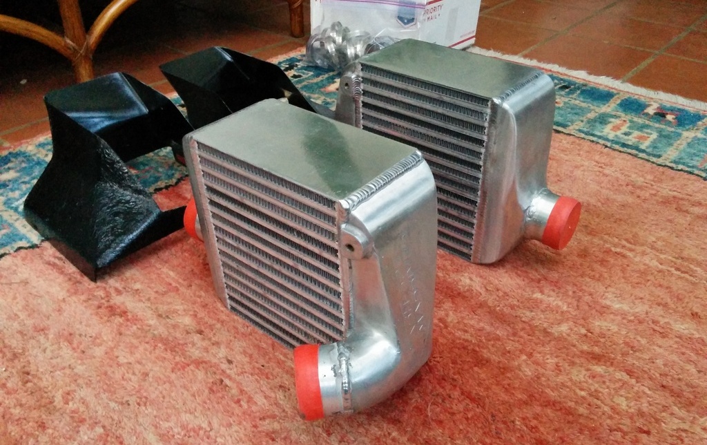

Did someone mention larger IC's...
[ATTACH=CONFIG]113603[/ATTACH]
They're still in your conservatory aren't they...….!!!
That’s what I’ve got on my zed V3 plus all the pipework.
Yup, along with the Ashspec pipework - Q4 install.
See you Sunday. :)
