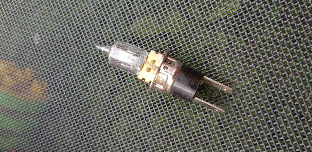

Got the bulb secure in the headlight with the spring clip thing but only have one pin and a 2 pin connector
Btw, I think map cars bulb is H3C if that makes a difference

Just been to look. The H3C bulbs is right for an import. Should be like this

I did mine earlier this week for mot.
The bulb lit without having to replace it into the housing.
Mine's a jdm with a 2 pin H3C bulb. If yours is a uk it may be different.
Auto shops here only had H1 and H3 bulbs with 1 pin. I will look online and see if I can get some. If not I will solder an earth cable to the H3s.

As others have said, H3c is the correct bulb for jap cars and connects differently to the H3. You probably arent getting a ground

Thanks for the offers guys, I have ordered some on next day delivery.
