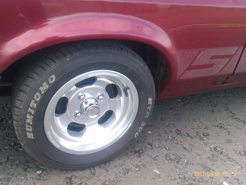

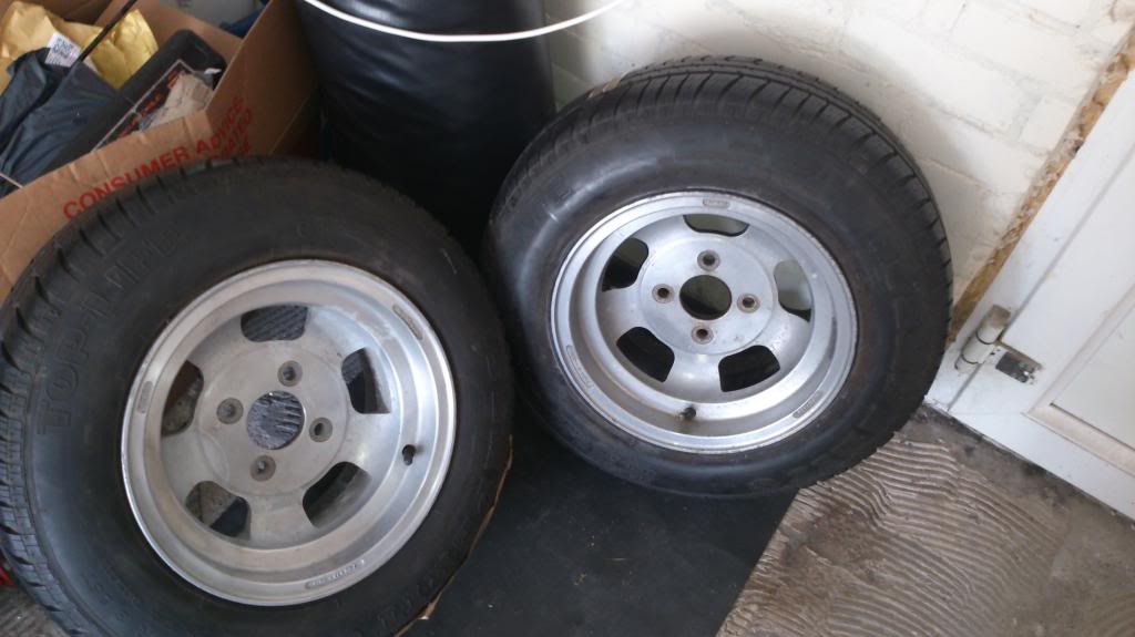

Oh memories, had Wolfrace alloys on a Capri in late seventies !!
They start like this>>
and
a few months later
look like this >> ( sh*t ! )
[ATTACH=CONFIG]113165[/ATTACH]
and
a few months later
[ATTACH=CONFIG]113166[/ATTACH]
