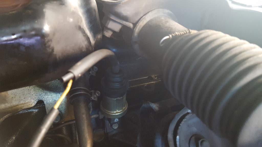

Changed my front brake pads yesterday and now my Z idle is very high. I did clean around the bottom if the engine and remember hitting the wire in the picture below.It had tape wrapped around it so removed it and there is one yellow wire. What is this for?
Ok firstly, get a Conzult! It can make diagnosing these things easier. For example in this instance you could electrically disconnect the AAC from the IACV without physically disconnecting it, which’s saves time and potential damage to the harness (especially if it’s original!).
Disconnecting the AAC and monitoring its position could help isolate a vacuum issue from an AAC fault. Have you ever removed the IACV to clean inside it as it’s possible that it’s gunked up causing the piston to stick.

If you do decide to remove the IACV for cleaning/inspection, that pic clearly shows the location of the 4x10mm bolts holding it on. I’d recommend removing the small scuttle trim and the battery for easier access.
You’ll need a new gasket for when you refit PN 2378540F00
https://www.allcarpartsfast.co.uk/nissan/nissan-2378540f00-gskt-aac-valve/
