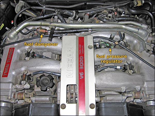

Balancer bar smelling of petrol is a classic for the fuel damper diaphragm to be leaking fuel into the balancer bar, pull off the small rubber pipe and see if it is wet or smells of fuel...if it does change it, it will only get worse and causes hot start flooding issue.

Hi Jeff, I checked the fuel damper and it seemed ok, but I tested the vacuum connection with a piece of vacuum hose and could taste fuel.....
I swapped it with a spare I had just to make sure....

Ok I should of been more clear on the fuel damper, if there is fuel smell in the vacuum line that us exactly the issue that can cause flooding as it gets worse, so you have cured that by changing it.

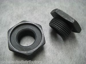

The 02 sensors are a royal pain, as far as changing them out, we found in the workshop the easiest way was to take a long chisel or prybar and basically break the porcelin top off with the cable, this leaves you able to use a socket directly on it with some wobble bars. But even with slow turning and lots of WD40 the threads can just pull out of the boss on the elbow, not a major problem as the you can remove and replace, see pic below.

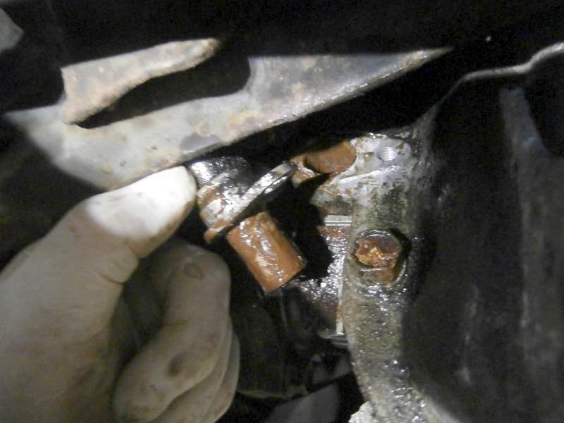

The rear abs sensors come in pairs only as they use a common loom / connector, they can be difficult to change as they seize in and the access is difficult, did a small tech thread about this some time back see below.
https://www.300zx.co.uk/forums/showthread.php?171999-Rear-ABS-sensor-tech&highlight=rear+abs
