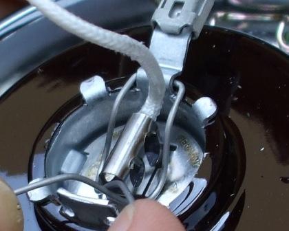

Help required please.....I have disconnected the wiring....removed the locking ring and rubber boot....how do I get the bulb out?

Once you've unhooked the wire lever, it just slides out.
Not an actual 300zx headlight but the spring wire holding the bulb in is the same
Done it !.....was stuck in there...can't have been out for years!
