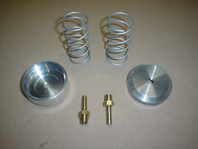

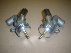

Unfortunately the OEM recirculation valves are not serviceable and are NLA from Nissan. Specialty-Z in the US
sells an aftermarket replacement:
https://specialtyz.com/shop/gfb-go-fast-bits-recirculation-valves.html
The "goose honk" is described here with the fix for stock recircs:
http://bde-performance.com/goose.htm
and you can see why the OEM's aren't serviceable from the photos.
