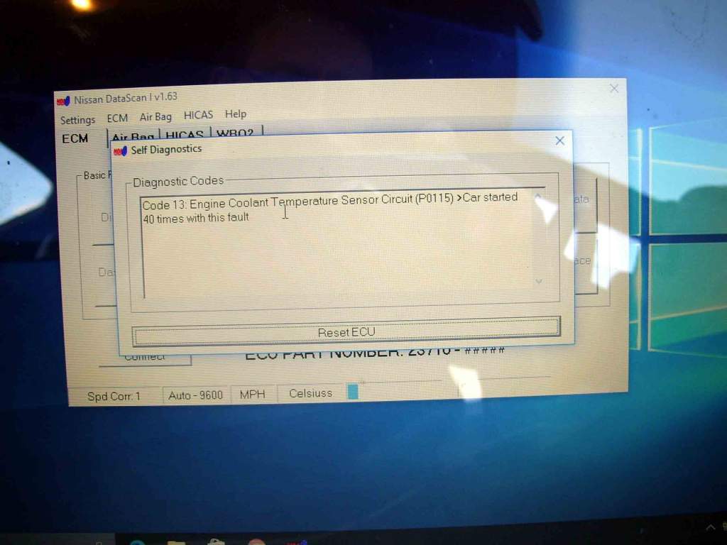

UPDATE: Having got my carsick from the body shop and driven from Wiltshire to Cardiff & back my car starter stinking of fuel through the air vents. This got me thinking if it could be related to y starting issues. I checked the ECU for fault codes and got code 55, all clear. I checked my fuel lines for leaks and couldn't see anything obvious. However, when I pulled the vacuum lines off of the fuel pressure regulator it stank of fuel. I think maybe the diaphragm has split and its leaking through into the vacuum system. This could be linked with my starting issue. I going to change the fuel pressure regulator and the other fuel component jobby (which looks like it has a diaphragm in it as well) and see if that cures my problem. Is this a Nissan main dealer part of can I then from somewhere else Z1 motorsports maybe??

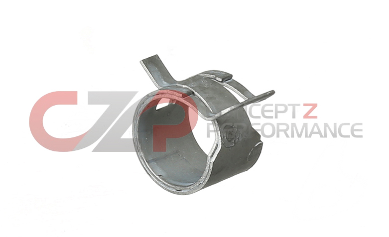

Make sure you tighten up ALL the hose clamps. They loosen over time. You're better off replacing them with the later style spring clamps.
What do the later ones look like Si?
Thanks Andrew. I'll get some ordered.

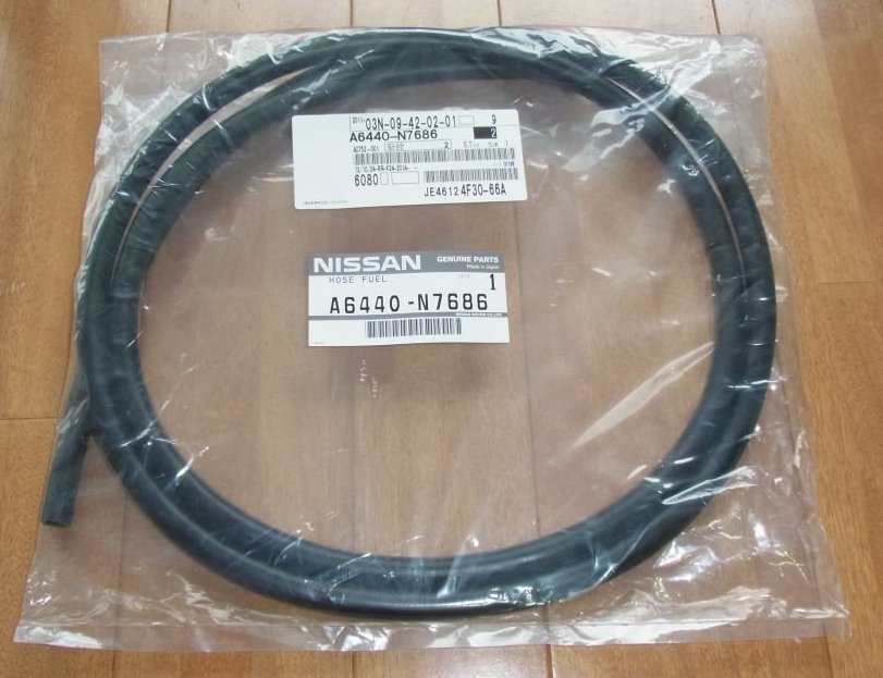

If you decide to also replace the rubber fuel lines, then the most cost effective way is with a single length (2.20m)
of Nissan hose suitable for Z32 fuel injection and resistanct to damage from ethanol in petrol cut to the required lengths.
https://www.allcarpartsfast.co.uk/nissan/nissan-a6440n7686-hose-fuel/

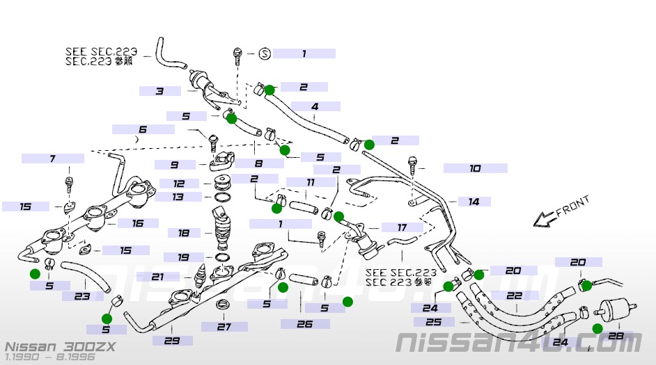

This shows the hoses and clips (green dots):
