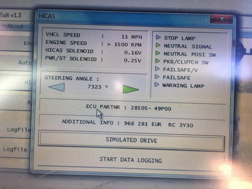

I ran a CONZULT diagnostic and got some very odd readings. I wondered if the Haltech was causing issues with the Conzult system, so switched in my original 16bit ECU and got the same results (pictured). When I took this picture, the engine was NOT running and the vehicle was stationary. The sensors in the HICAS diagnostic appear unresponsive to change.

I’ll be checking PS solenoid voltage and HICAS rack solenoid volatge later this afternoon. However, given that every single bit of data on the screen grab is wrong,
Says engine is idling at above 1500rpm - ENGINE IS OFF
Vehicle speed of 11mph - VEHICLE IS STATIONARY
7323 deg I’d lock yet neutral position sensor is active
I suspect the HICAS ECU may have failed. I can’t seem to find any similar instances of failure though

Just had a look on the engine tab on Conzult (with stock ECU in place). On that tab, it has vehicle speed as 2mph (I’m still stationary at this point without the engine running), but HICAS is seeing 11mph

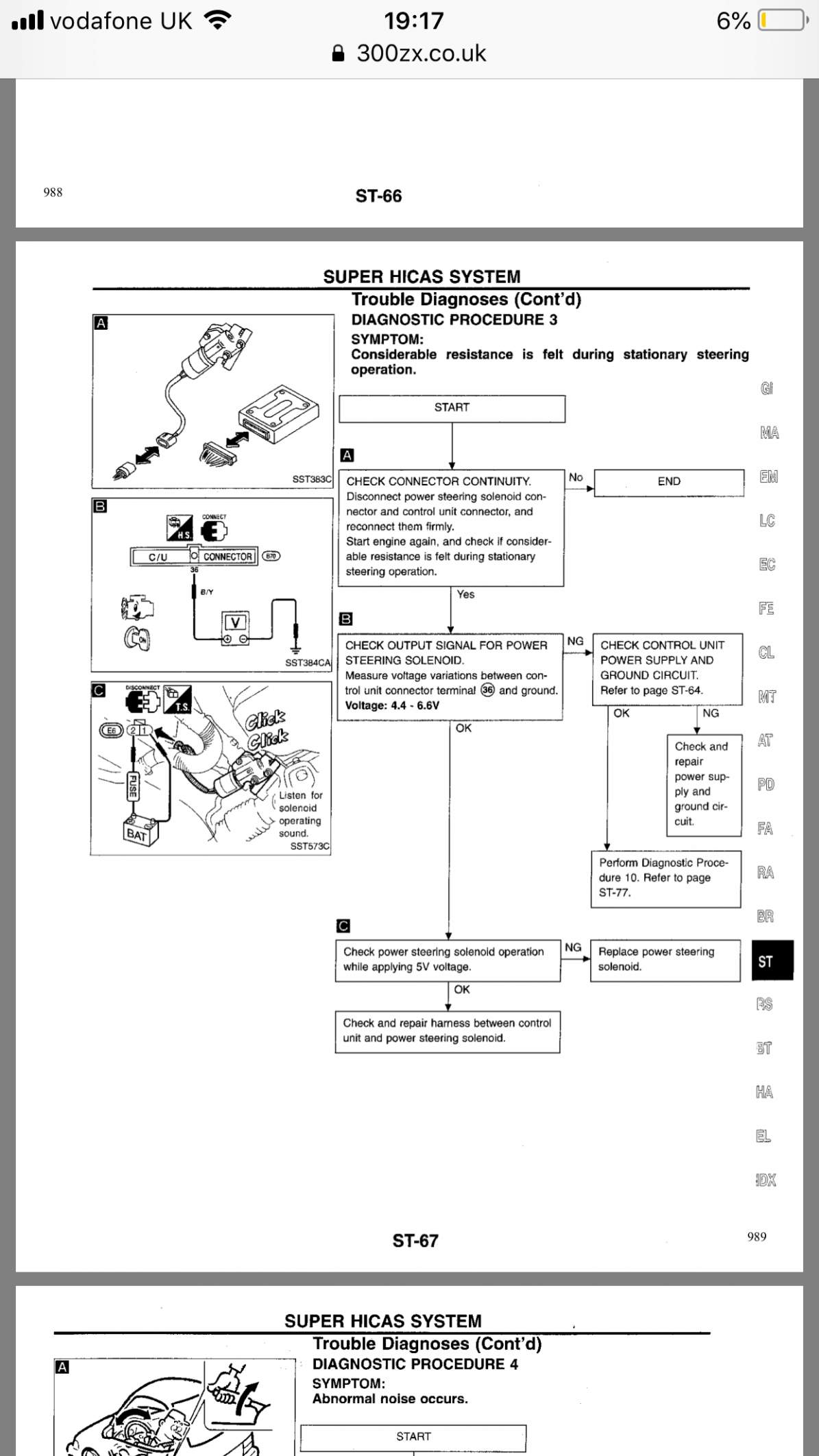

So in this process, section B, I’m only getting 0.2v to pin 36

Well I’ve been through the workshop manual and can’t find a single thing wrong with any of the inputs (steering angle, neutral position etc etc)
