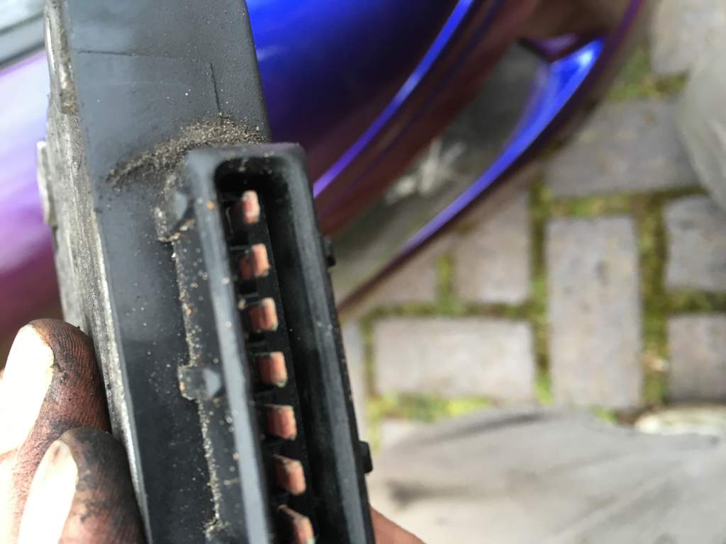

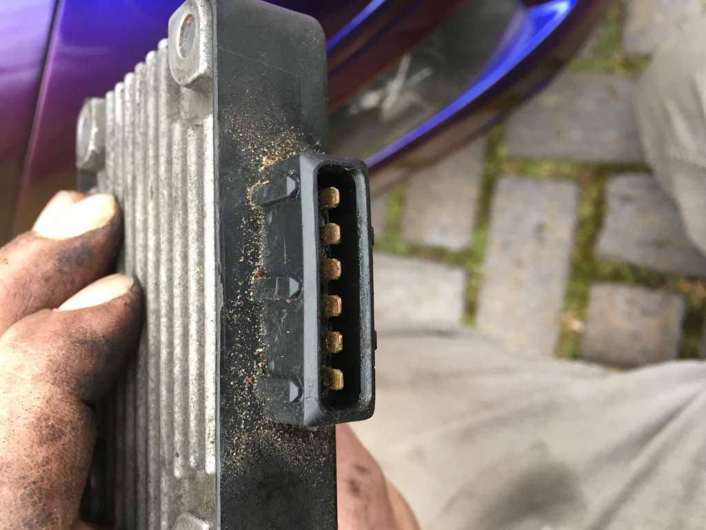

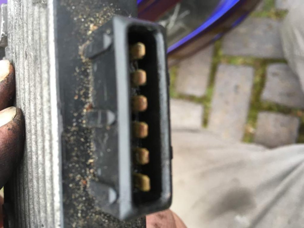

You are also running a S1 PTU which are prone to giving the symptoms you are having.
Thanks Andrew, I thought it was a 2. I’ll chase up another one. Can you get them new or is it only used now?
10-14ohms
My car did have backfiring issues because of the Ptu, it just dropped more cylinders.
Not sure if you can get them OEM new. I know you can get Chinese ones but they will probably be unleliable so easiest to swap for a S2 once you tested with another S1 and can confim it's the issue

PTU will affect more than one cylinder (plus you can't tell anything from the outside of a MAF or PTU)

Ptu can affect just 1 cylinder or more. It's 6 individual power transistors in a box.

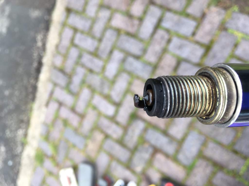

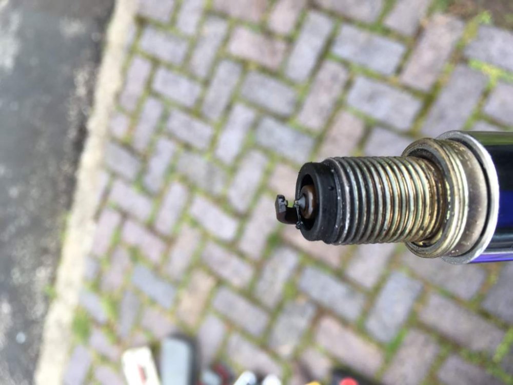

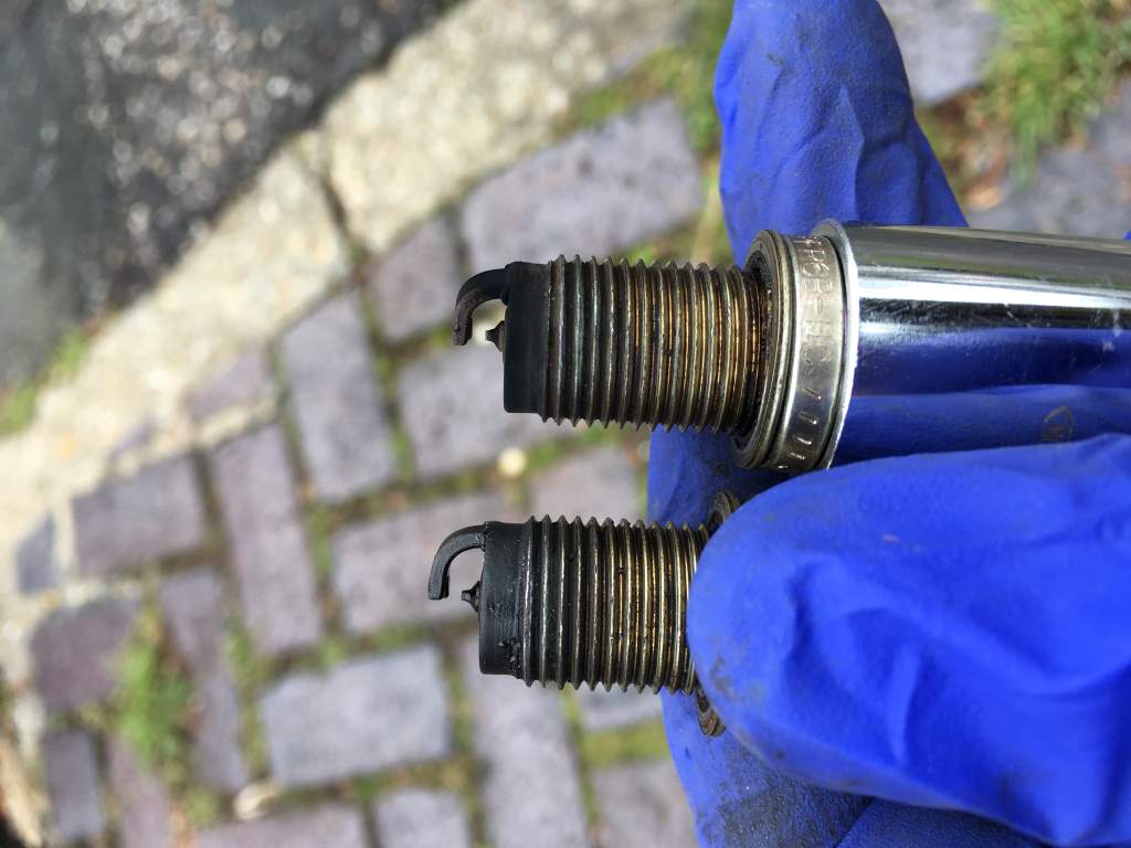

Next I removed the SPARK PLUG and noticed it looked a bit glossy and so double checked against another.
I’ve swapped the plugs round and the issue moved with the plug. Any ideas what will have caused the plug to look like this?

Looks a bit wet as if fuel was on it and not ignited.
Throw a new plug in it.
Running rich on the cylinder it came out of which points to an ignition problem. The problem would have moved
as the plug is now so fouled.
Cheers Ali. That would make sense as it’s not been combusting down there. Any idea why the spark plug might have failed though or can it just happen?
