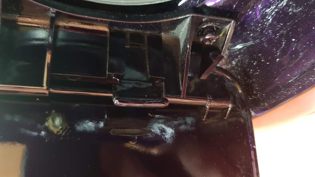

Its not really a spring but bent piece of metal that pushed outwards against the petrol flap.
Open the flap and bend it slighty back so that when closed it applies more force on the flap.
Pictured here in the middle :
