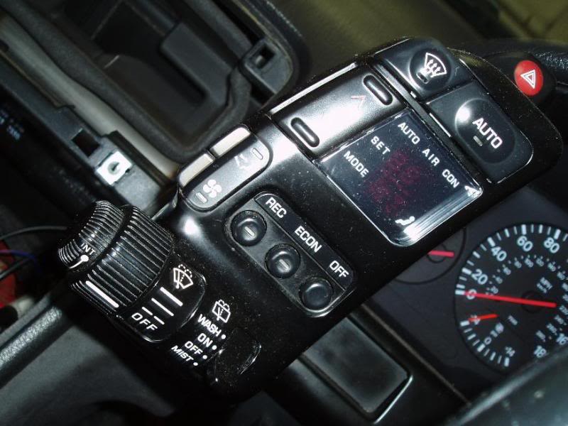

Hey guys. Is this all I need to install the directional blower?

You got the wrong series climate ecu. you need the blue one.
Edited by Alic
The one with the blue label? OK, will have a look for one.
Here is a set up I sold in 2010 from a UK breaker and the label on the ecu is green, came from a series ll zed, the colour of the label changes between series ll UK spec and series ll Jap import.
https://www.300zx.co.uk/forums/showthread.php?140827-Series-II-air-con-upgrade-parts-for-

So what you're saying Jeff is UK zeds had the sII with green sticker, but jap is a blue sticker. while the series 1 jap is green.

Yes the numbers are different between import and UK as well some confusing label colours, there is also red and yellow as well as dark blue and light blue all depending on spec of the ecu.

That part# 27512-41P11 matches the part for a UK spec (11/93 build) item 35:

Series 1 JDM are green and S2 JDM is blue. UK S2 is green.

So I've got a spare 41P02 here which is a JDM 1990 NA.
Green sticker series 1
Yours is blue and 41P11, but not sure of S1 or 2.
