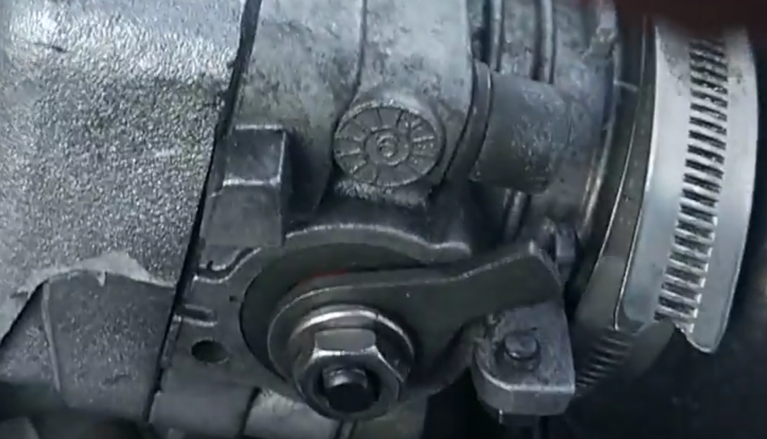

Check for any vacuum leaks and TPS (make sure throttle is completely closed) and then you can adjust the iac if okay. I read correct your rack is pissing fluid? You probably need a new rack.

Thanks for the reply Alic, excuse the ignorance but how do i ensure the throttle is completely closed ? also have you any recommendations as to where to source a steering rack, and also a favourable place for a exhaust system, I will check the door height tomorrow and the order in which the lights come on, although I could not see any other illumination at the front of the car other than the fog lights when the light switch was in the sidelight position, is there more than one bulb holder in the fog lamp housing or should there be another lamp on the front that houses the sidelight bulb ?
Thanks again for the reply
Sometimes the throttle cable can be too tight and hold open the throttle.
This dial (on series 1s its on the outside and later cars on the other side of the throttle body) should be touching the stopper. When adjusting the cable you should have it so the cable will be as taut as possible without actually starting the move the rod. This way there won't be any deadplay in the pedal. If you do adjust it be sure to set the TPS to 0.44v to ensure it knows its shut.

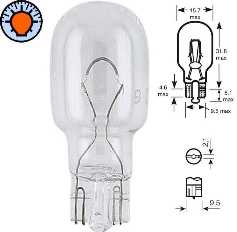

I have noticed this morning that the centre brake light only partially illuminates so Im hoping that that will just be a bulb replacement
The correct replacement bulb is Nissan part#26261-30P00 (13w). Be warned they are expensive!
If you PM me your VIN number (you will need to be a subscribed member to PM) I will lookup the factory build date etc for your car.
A £5 each !!! no way, Nissan rip off as per.
Standard T15 fittment, given they are the same bulb that is fitted into 12 volt garden lights they are available in various wattage from 5 watt to 21 watt if you fancy a brighter upgrade in different colours as used as indicator and brake light bulbs on many French cars etc.
Used the 18 watt one`s in the past and causes no issue within the light unit.
