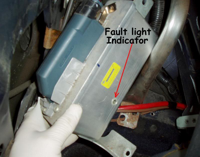

The abs system has a built in self diagnostic system, I covered this in a previous thread, (see link below ) you can easily try that yourself by following the test procedure, if not then a dedicated ( Very Rare ) Nissan ABS tester will find it as I had and shown in the pictures.
Dependant on if the light is on from the start or only after moving off will direct you to where the problem lies, of course always worth checking the fuse under the bonnet by the master cylinder.

1 Left Front Actuator Solenoid Circuit
2 Right Front Actuator Solenoid Circuit
3 or 4 Rear Actuator Solenoid Circuit
5 Left Front Wheel Sensor Circuit
6 Right Front Wheel Sensor Circuit
7 or 8 Rear Wheel Sensor Circuit
9 Motor and Motor Relay
10 Solenoid Valve Relay
16 or Continuous Control Unit
Dash Warning but L.E.D. Off Control Unit Power or Ground
THREAD LINK HERE >>>
