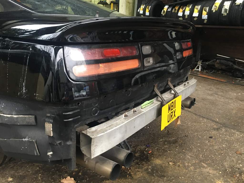

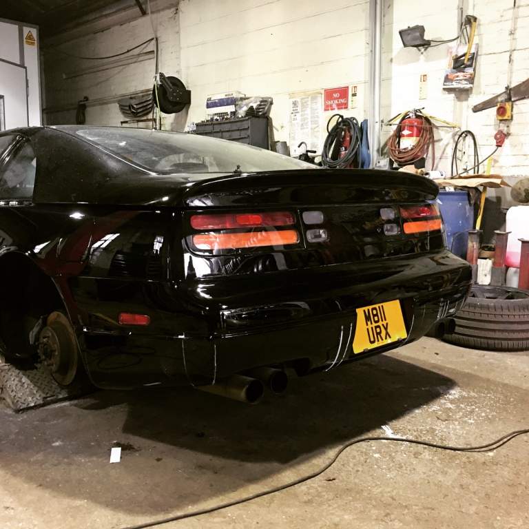

Well the WinFactory CSL-R is on!
[ATTACH=CONFIG]110667[/ATTACH]
Unfortunately, as with most after market fibreglass parts, there is a fitment issue.
[ATTACH=CONFIG]110668[/ATTACH]
As you can just about see, the bottom edge of the spoiler doesn’t follow the curve of the top of the rear lights. Having spoken to WinFactroy, it appears to be a issue when fitting to 2+2 hatches that they haven’t publicised.
Quite how I’m going to rectify this problem I’m not too sure, all I know is today turned into quite an anti-climax

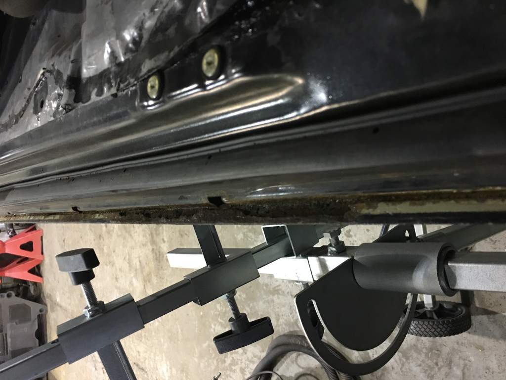

As you can see in the second pic, and my other recent thread, I’ve had to source a new set of doors. During the strip down stage we found the only gremlin I wasn’t aware of. The bottom of both the drivers and passenger doors were suffering with tin worm issues
This doesn’t seem to be a known rot place for the Z, but I can only assume this has occurred during the 3 years the car was off the road and stored outside under a cover. Initially it just looked like it was the outer door skin where it folds over onto the frame. But once they began cutting the rot away it became apparent that it wasn’t economically viable to repair these doors. Bugger
I sourced a new set of doors off FB which were in very good condition. The only downside is that I’ve now lost the side impact bars that were fitted to my original doors #weightsaving

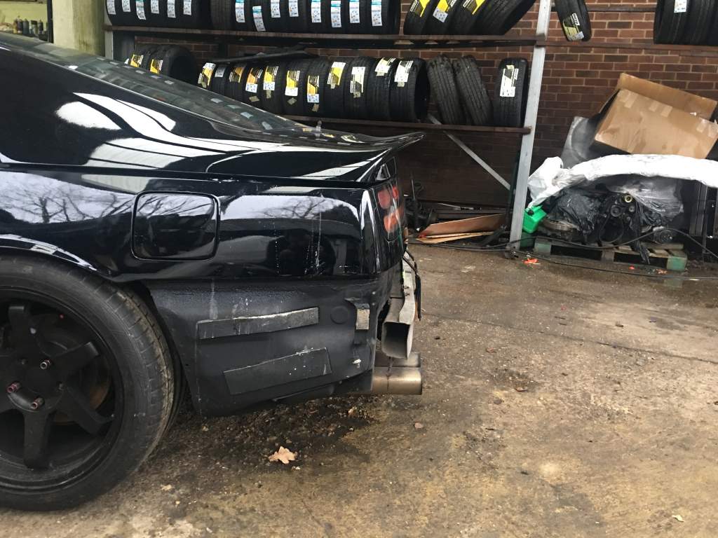

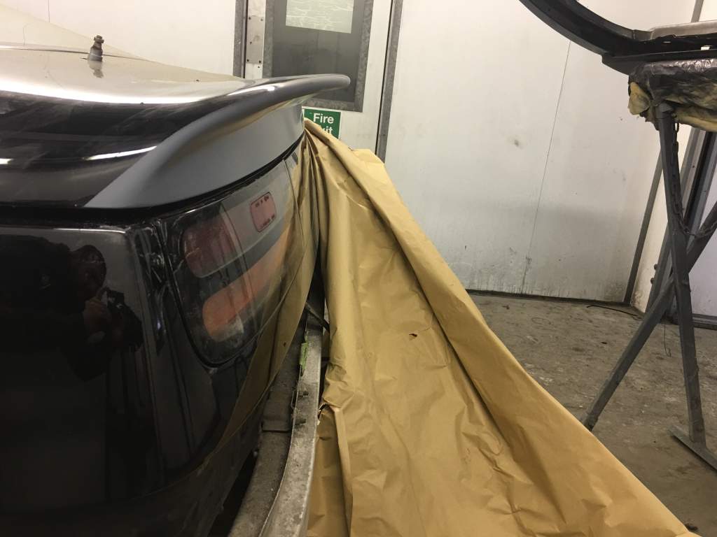

Well after the mayhem the weather caused, managed to pop over to the bodyshop. And I’m pleased to say the CSL wing fitment issues have been sorted.
After lots of little cuts, flexing, re fibreglassing, filling and shaping, it now sits as it should
The underside of the wing now has a bit more of a wave like curve to it, so technically it’s now a custom wing, but I’m happy with how it now sits.

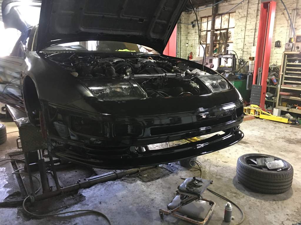

Bumpers are prepped and primed (forgot to grab a pic as was short on time) but it’s getting there.....

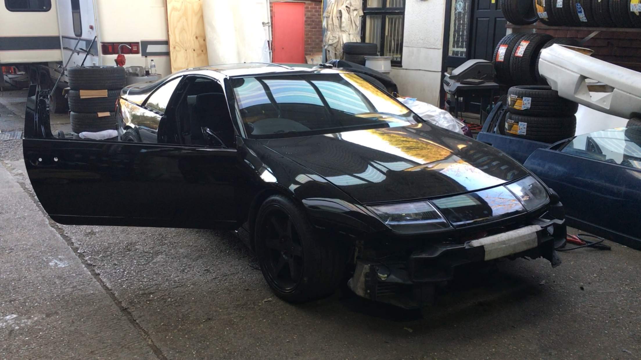

So I managed to source a set of mint replacement doors. They were red, but they were always going to be completely stripped back to make sure they were spot on.
I spent a day stripping the windows, rails, loom etc and putting them into the newly painted doors, so at least she looked a little more complete now (if a little dusty)

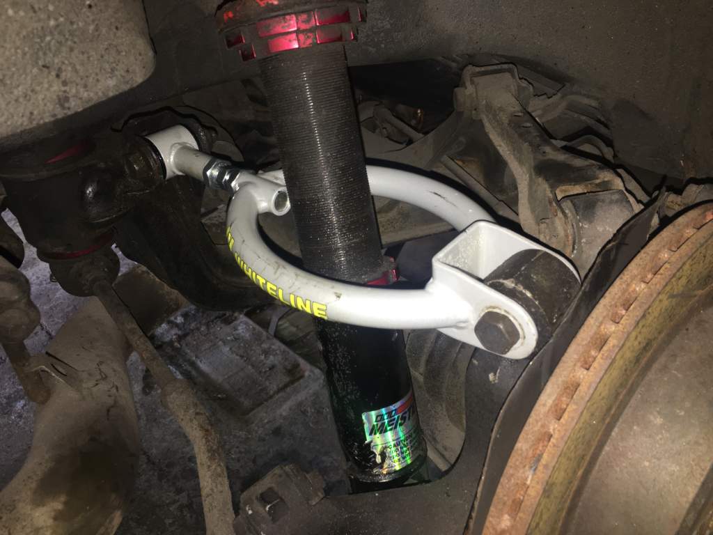

Popped in today to fit my new RUCA’s. I’d decided to rid the rear end of the hateful Rose joints, so went for a set of WhiteLine RUCA’s as they use whitelines more pliant poly (black) bush vs their “race spec” poly bush (yellow)

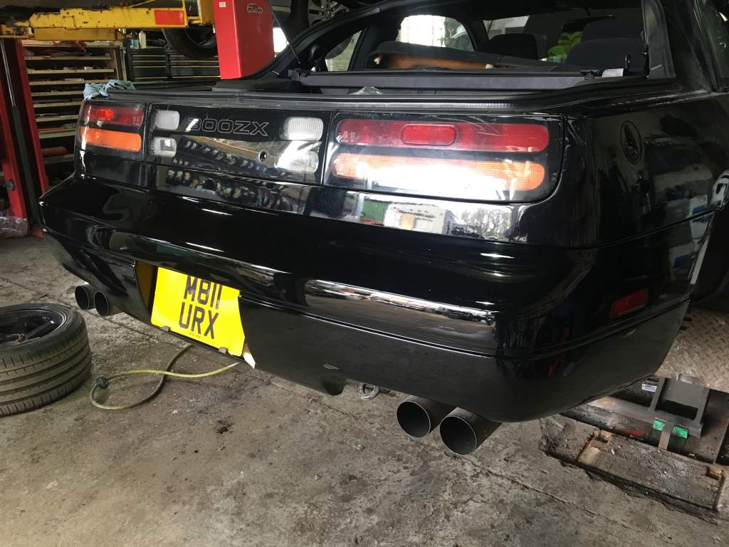

Finally, all the painting is sorted. The back bumper was back on and the front bumper is done bar the moustache, which will be satin black
The wet sanding has also started, so well and truly on the home straight now!

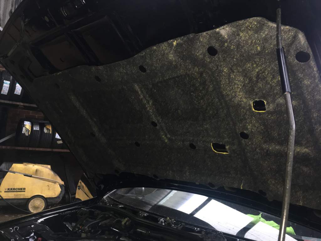

Also fitted a new OE bonnet insulation as mine was very tatty

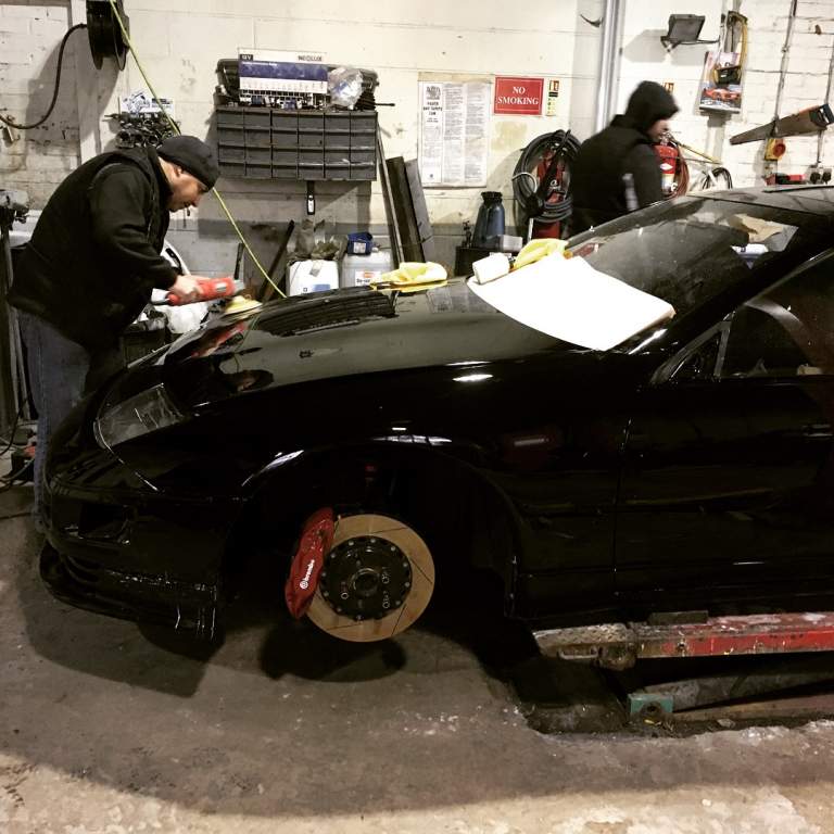

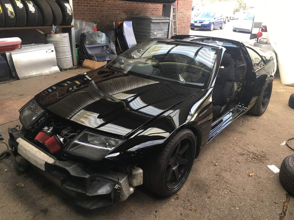

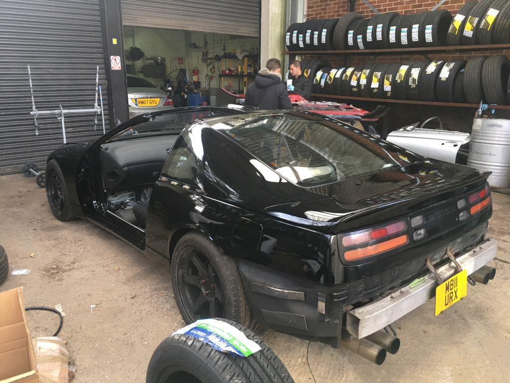

Returned to the bodyshop today to help with some wet sanding and compounding. Super excited now!
All being well, I’m collecting her on Thursday.
Hopefully I can get her in for its new exhaust and final mapping in the coming weeks

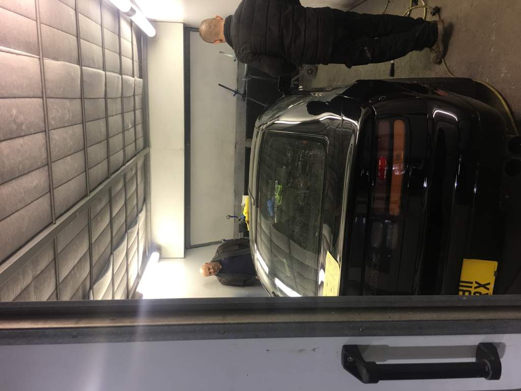

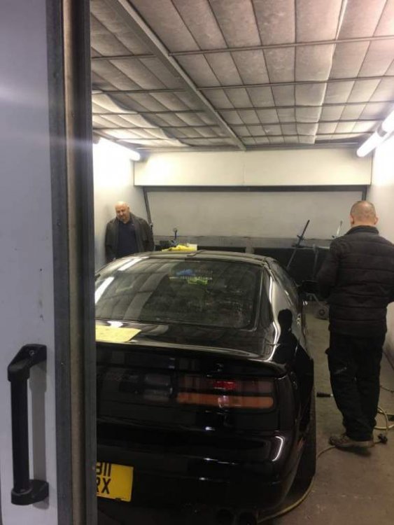

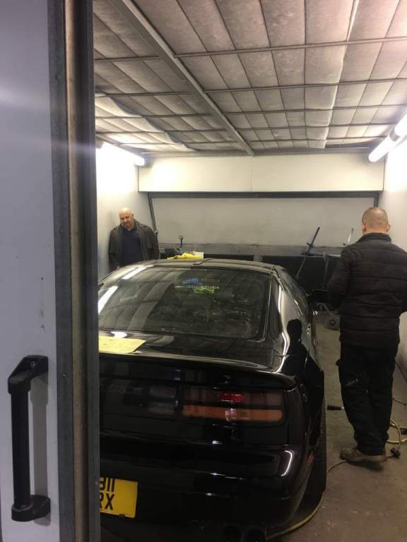

Well I was supposed to pick up he Z today, however fate suggested otherwise
A couple of days ago a very very careless eurocarparts driver parked next to the Z while it was out in the yard and opened his door onto my Z, marking and denting the passenger side door right in the middle of the panel. As you can imagine, neither the bodyshop or I were best impressed.
So, today the Z went back into the spray booth to have the door repaired and repainted.
After the baking process I decided to make use of the warmth and fit the OE Upper windscreen moulding (the one the windscreen company used was hideous). Annoyingly this is where we noticed the windscreen wasn’t sitting and flat as it should be and sits proud of the side moulding runners on the top left corner of the screen. There’s only one way to fix this, and that’s windscreen out yet again (hopefully for free).
On a positive note, the Z should be ready for collection tomorrow and off for mapping on Monday
