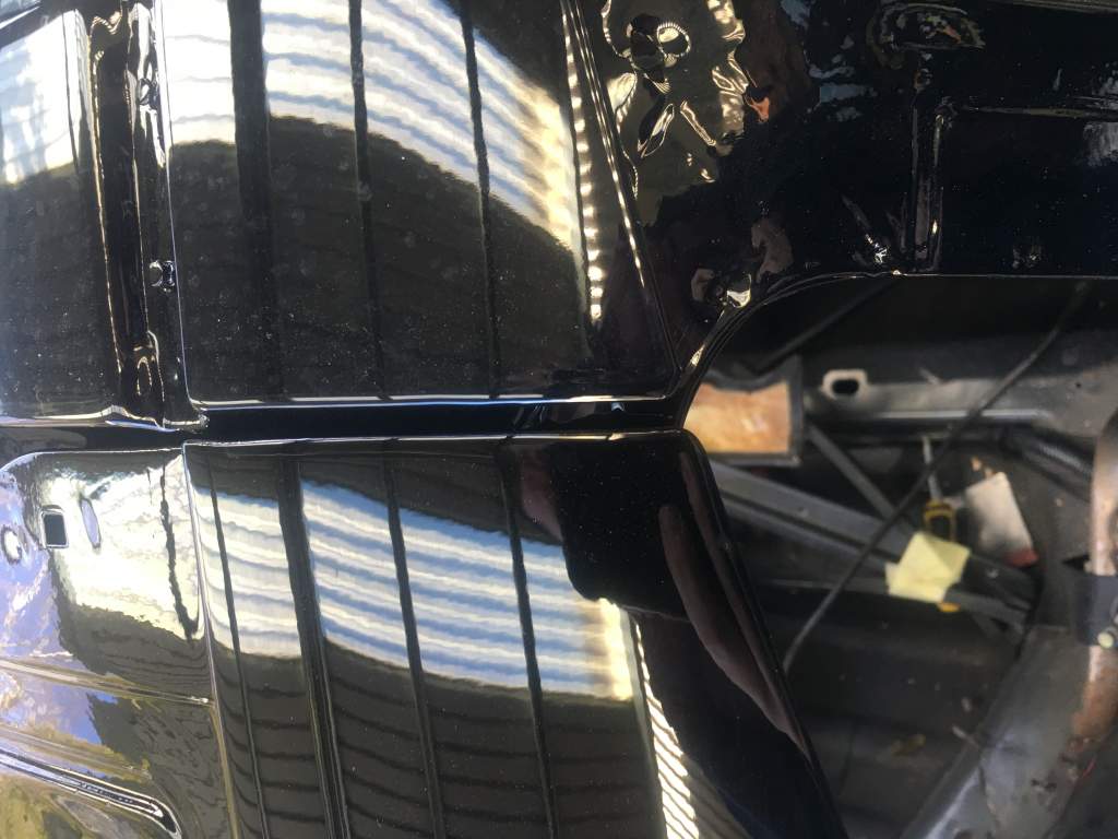

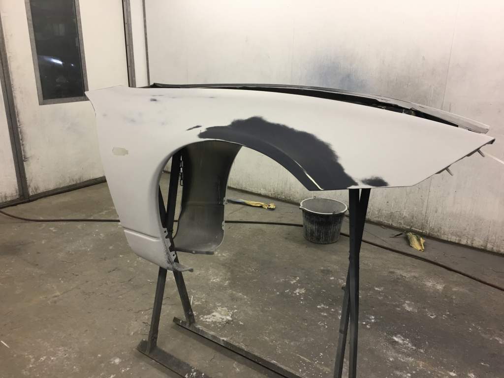

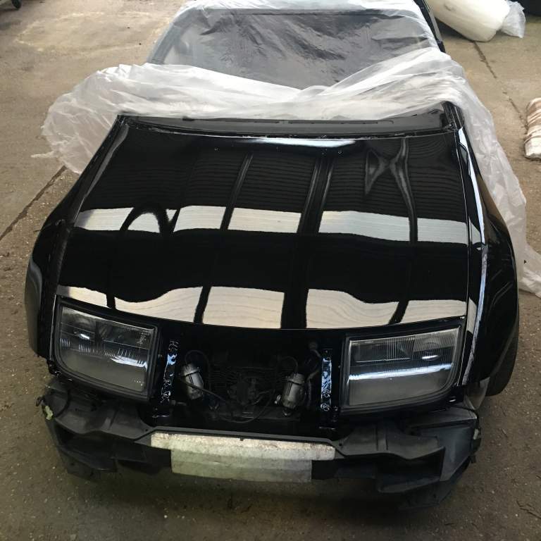

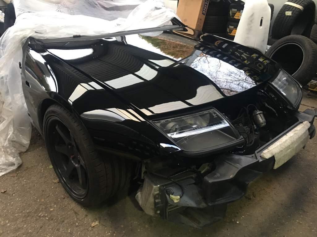

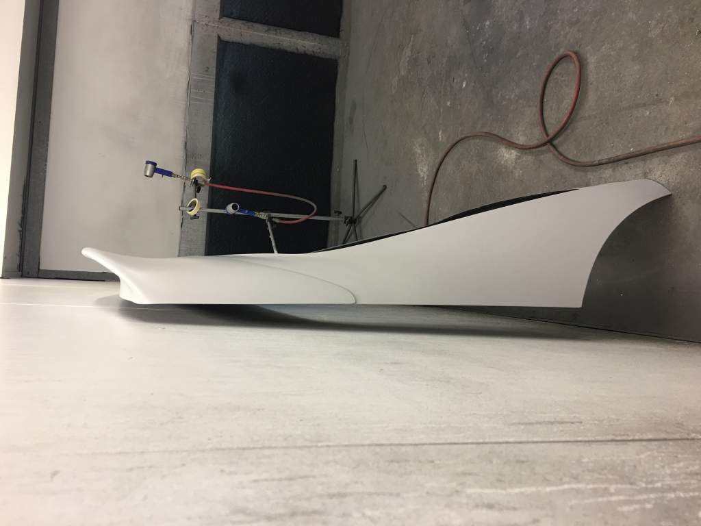

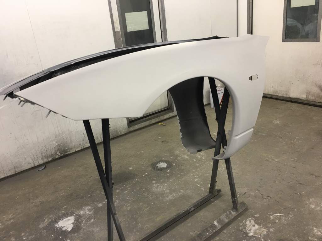

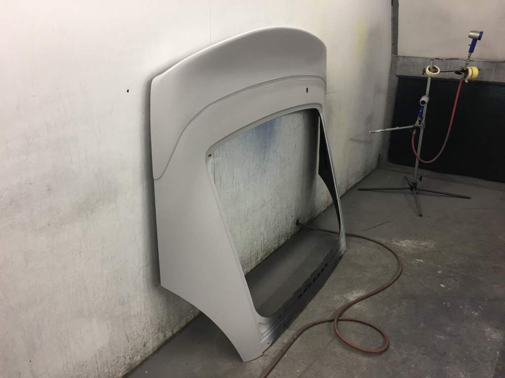

A little bit of progress...
Wings, bonnet and boot lid got their first coat of primer. A few little defects became apparent that needed sorting, but they should be in colour this weekend. Winfactory spoiler fitted beautifully. Once the sealant has fully cured on the leading edge, that’ll be flatted back. I didn’t want the spoiler moulded into the boot as I like the definition of spoiler on the boot lid.

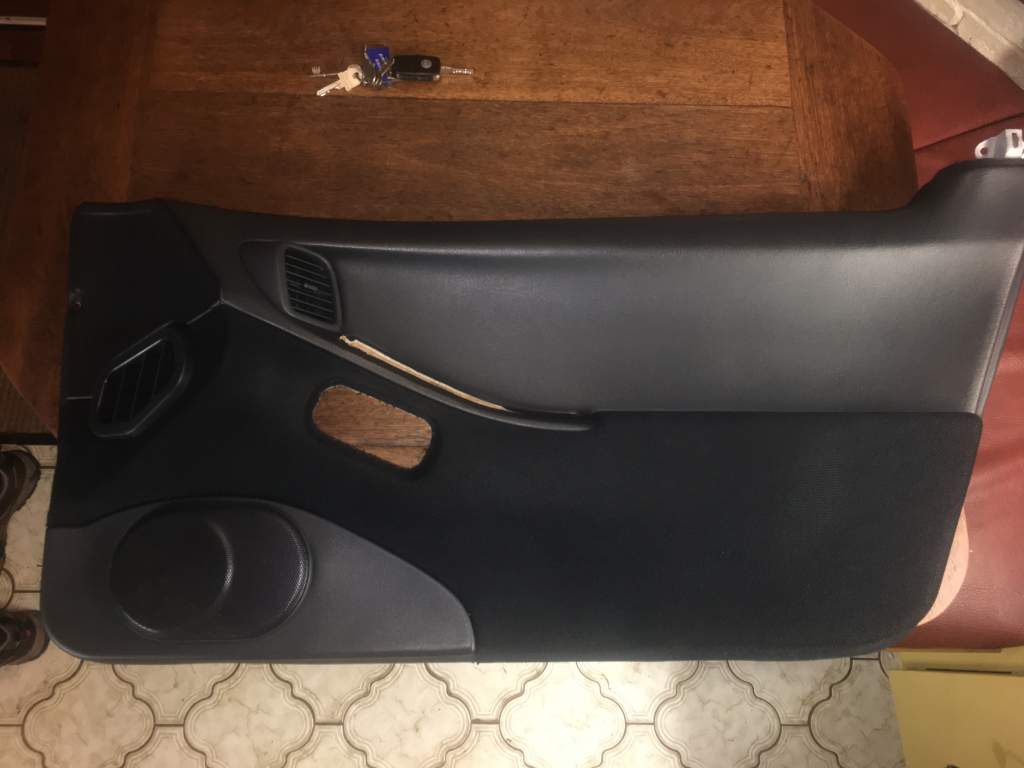

Also made a start on cleaning some of the interior parts ready to go back in the car. The later style cloth can be a royal pain for holding onto grime deep in the material. Nothing a bit of APC, microfibres and patience cant solve

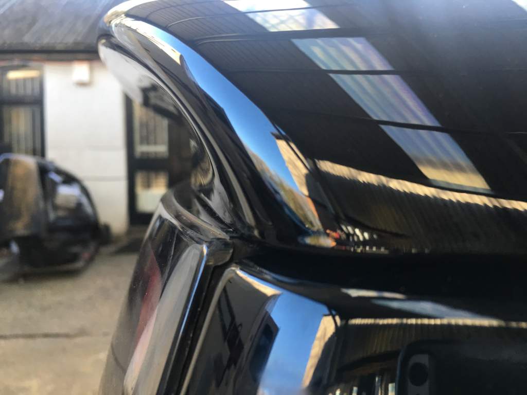

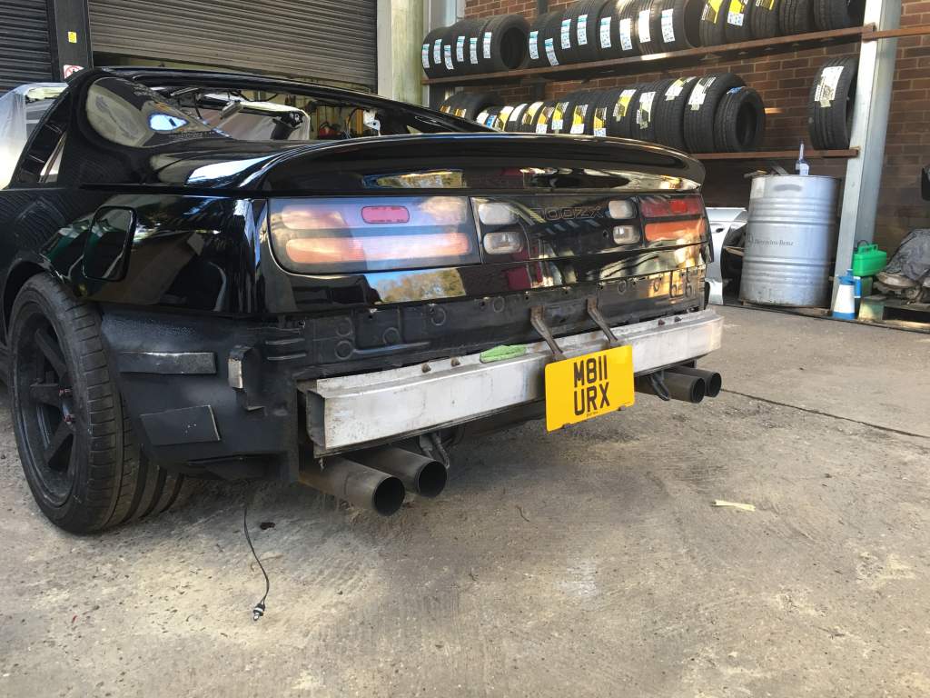

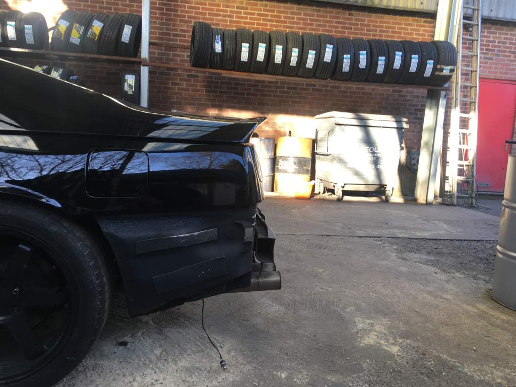

Well the WinFactory CSL-R is on!
Unfortunately, as with most after market fibreglass parts, there is a fitment issue.
As you can just about see, the bottom edge of the spoiler doesn’t follow the curve of the top of the rear lights. Having spoken to WinFactroy, it appears to be a issue when fitting to 2+2 hatches that they haven’t publicised.
Quite how I’m going to rectify this problem I’m not too sure, all I know is today turned into quite an anti-climax

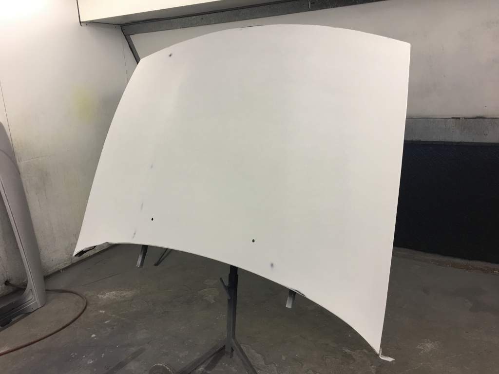

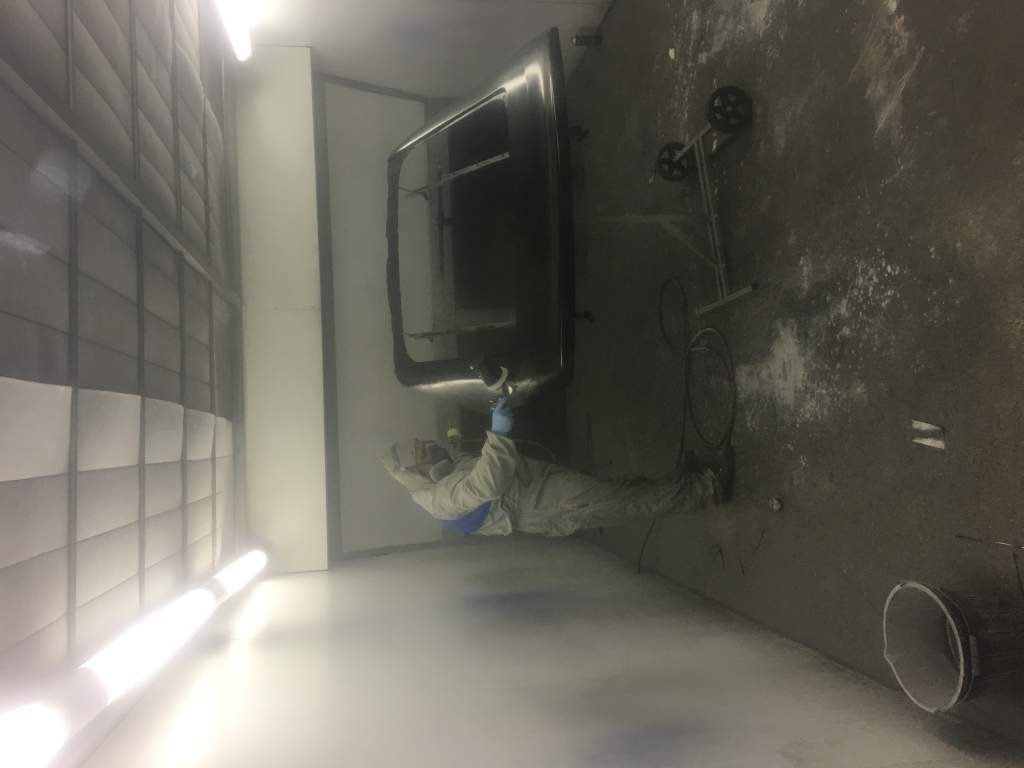

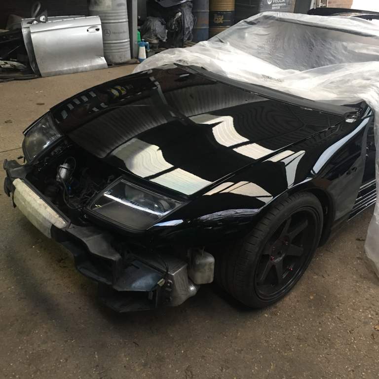

Dropped into the bodyshop this morning....
[ATTACH=CONFIG]110245[/ATTACH][ATTACH=CONFIG]110246[/ATTACH]
First coat of primer has identified a couple of defects that weren’t previously noticed. They should be easy to sort out before next coat of primer and final prep for base coat of Super Black KH3
Also lined up the WinFactory spoiler. While it fits perfectly across the top and sides, a significant gap is apparent where the bottom edge of the boot is, where the Perspex strip would have lived
[ATTACH=CONFIG]110247[/ATTACH]
Having spoken to Winfactory, this gap is intentional as the spoiler was designed to go over the top of the third brake light panel. A window seal type gasket has been suggested to close that gap, I’m not so sure that’s the best long term option, neither is filling it with filler.

Yeah, it’s pretty noticeable. It’s a tough one to photograph as the things so dam shiney!
Without the hatch sitting on the boot seal, it exacerbates the problem by another 5mm or so, but this shows the level of gap I’m talking about

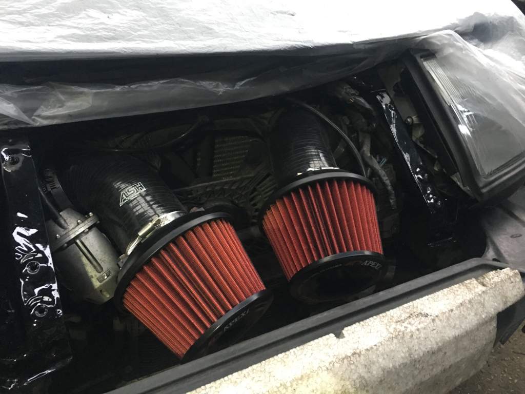

On a plus side, I fitting my dual intake today. A pair of 90 degree bends from ASH and a couple of Z32 MAF adapter plates, a pair of Apexi filters and bingo...
