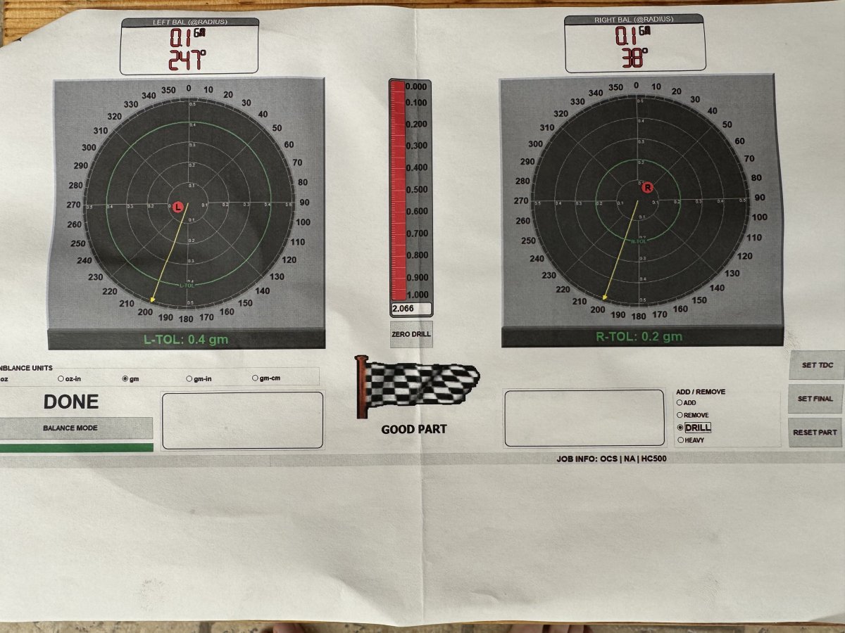

So, the plan as it currently stands is to machine my donor block to 88mm for my CP pistons, remachine the billet mains, resurface the block faces, balance the replacement crank and rotating assembly. Then I can start the assembly process while I have my heavily worked heads resurfaced to a proper finish.

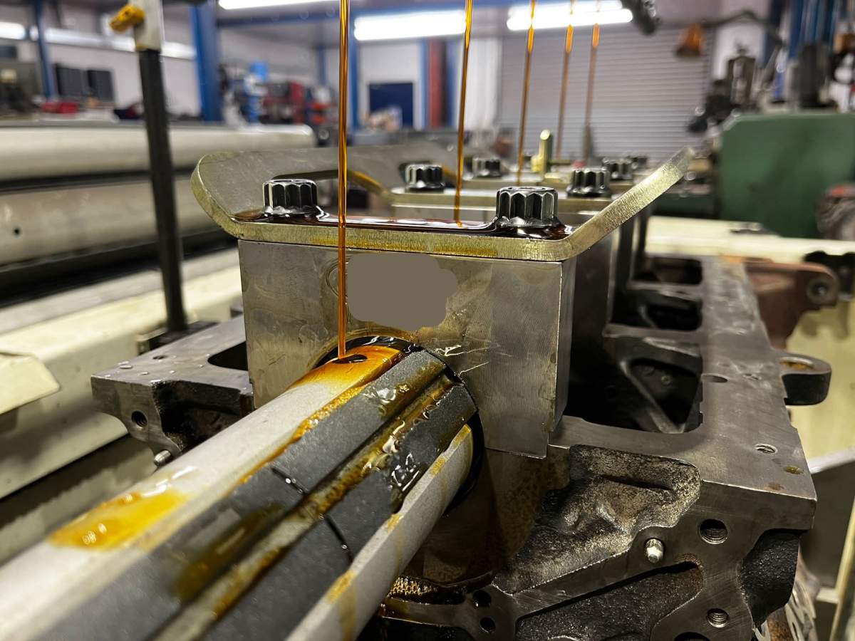

Happy to say my billet mains were salvageable and have been remachined to the correct size, and believe it or not, round!
Dropped off my torque plate on Friday so the cylinders can be rebored and honed and block deck can be resurfaced.

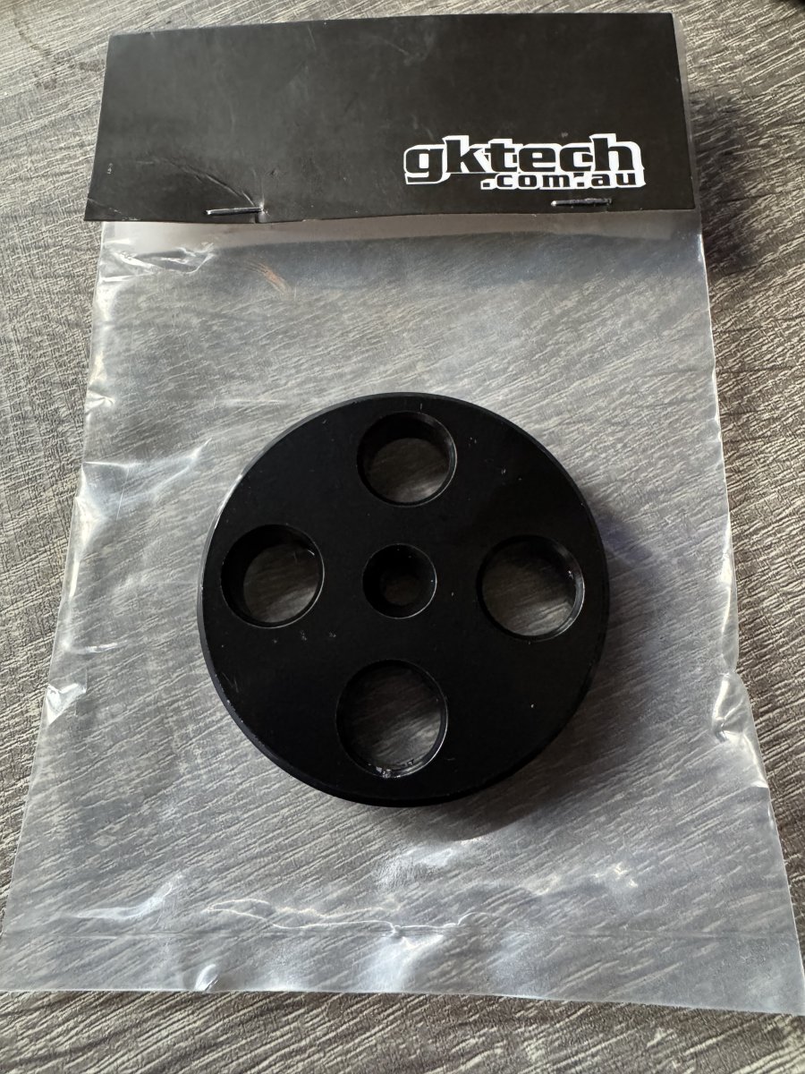

First purchase for the Z in a looooong time. I thought while the engines out, I may was well replace the steering column bushing with a @gktech_official solid bushing. More new parts arriving soon!

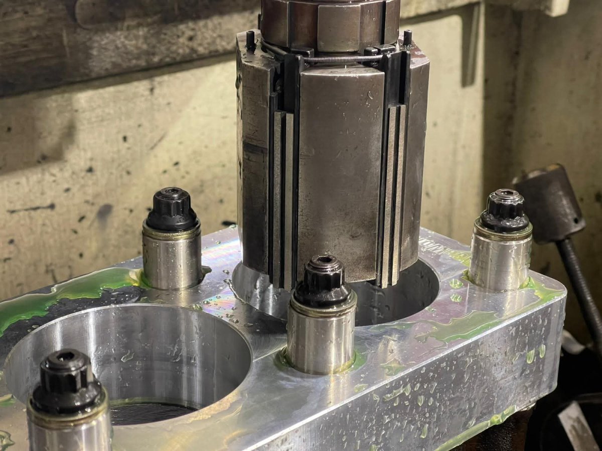

Happy to say work on my engine block is now finished! Billet main caps were found to be up to 4 thou out of round. This time they have been machined using the ARP’s that will be used during assembly (unlike last time by EPR!)
Cylinders were rebored to suit my 88mm CP pistons and cross hatching angle, depth and surface finish all set up for the Total Seal gapless piston ring pack I have chosen to use. I think I’ll be the first person on the UK to use Total Seal’s gapless piston rings on a VG30, so I’m looking forward to seeing if the live up to the hype

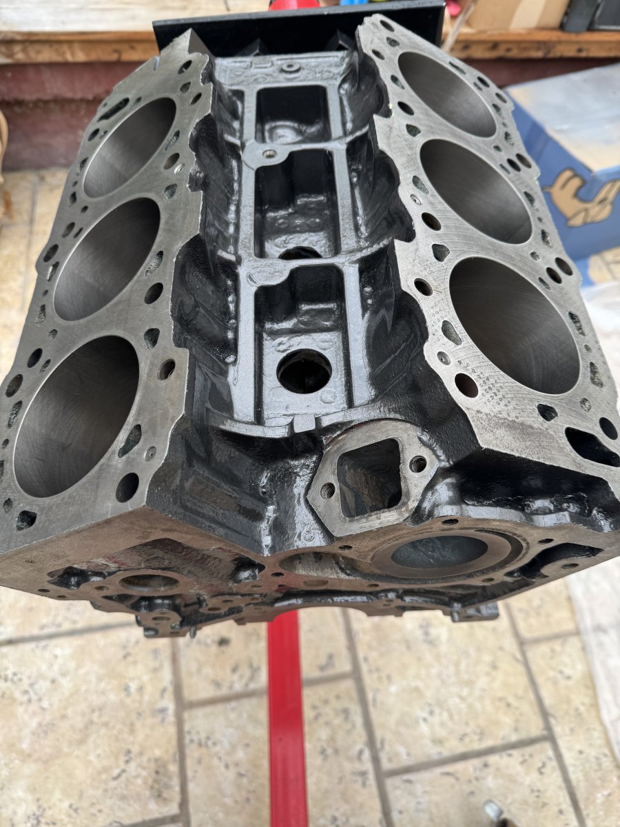

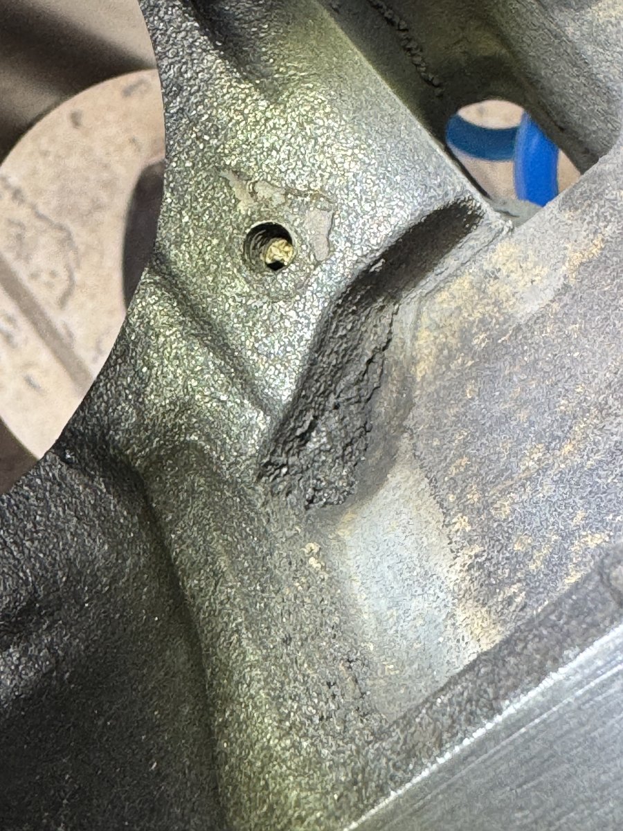

Well I got my block back from OCS last week and have started on the block prep for deep clean and assembly

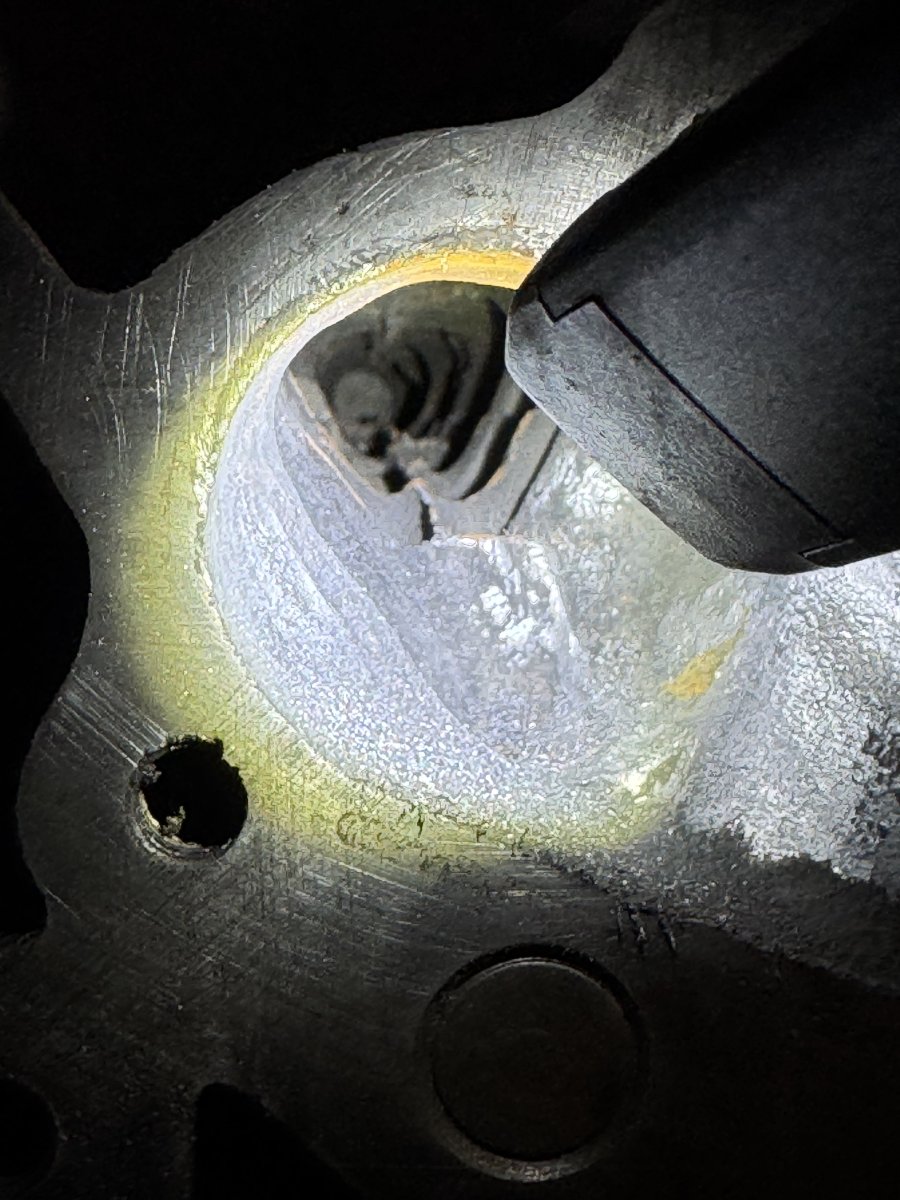

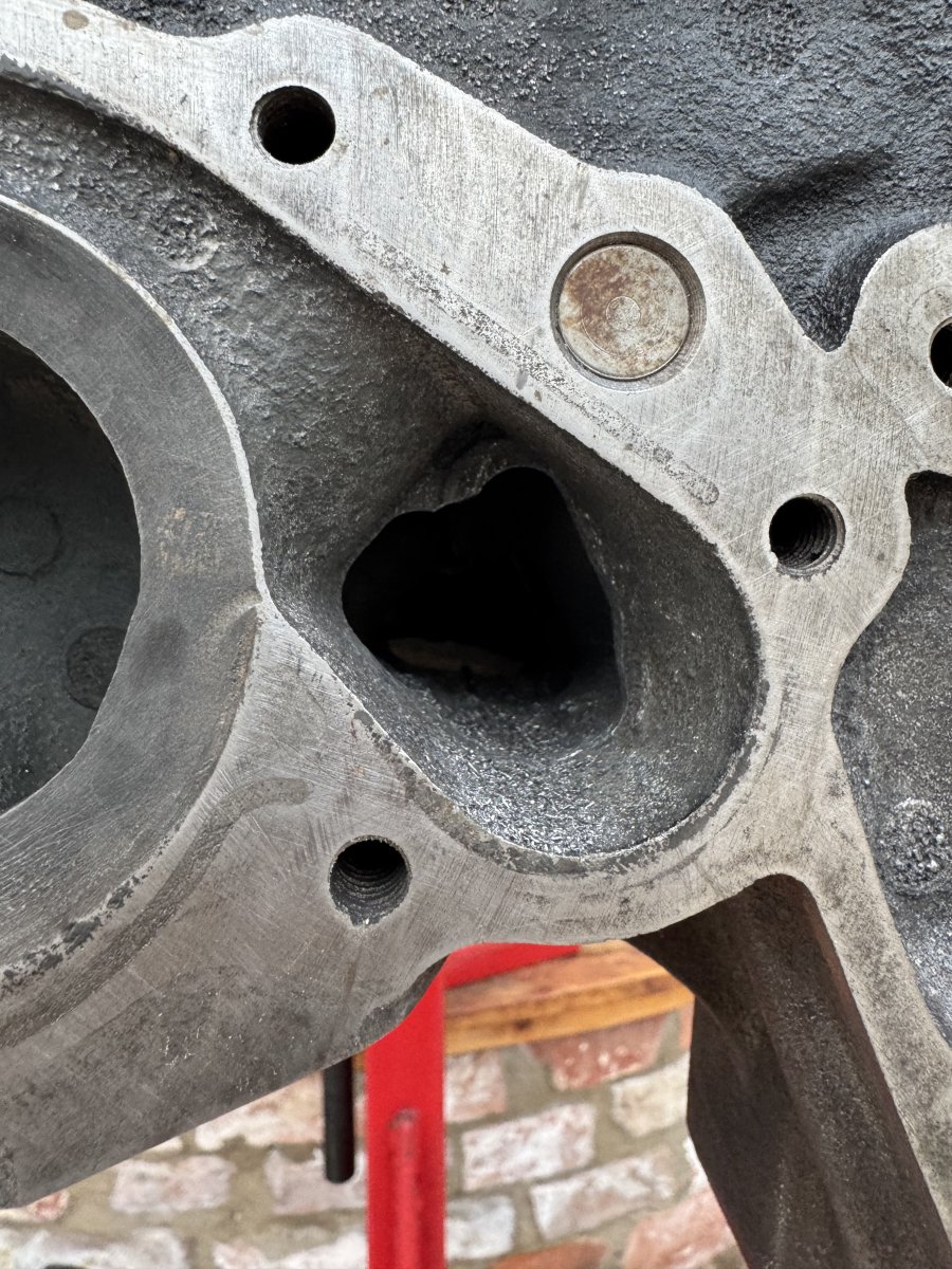

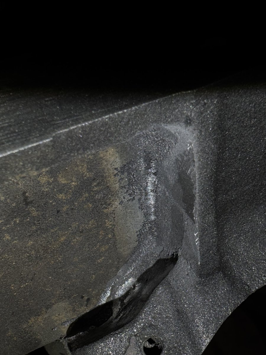

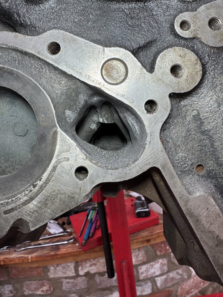

first job was to clear the excessive casting flash in the centre coolant channel and smooth the entry point out. Out came the long shank tungsten carbide burrs. A small but positive improvement
Also spent a bit of time with the burrs to clear out the casting debris and stress risers from around the bottom of the block around the crank journals.
This casting debris is from the imperfect casting mould that leave small sections of iron/sand mix still attached to the main casting. In certain situations, harmonics can release bits of this debris which then has the potential to destroy the bearings, an engine, by being circulated by the oil system.
Stress risers are similar. They’re very fine ridges in the casting that can form a weak point. Simple remedy is grind them back flush.

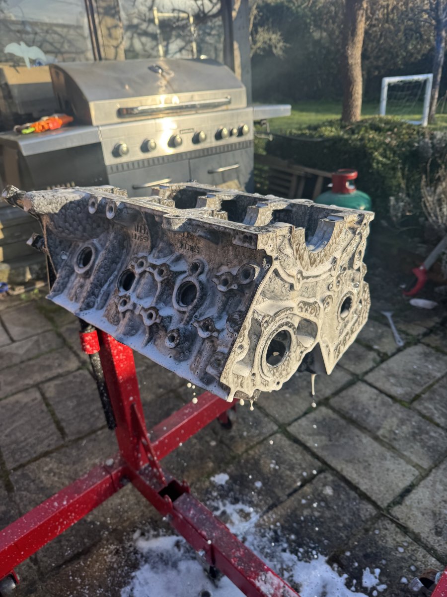

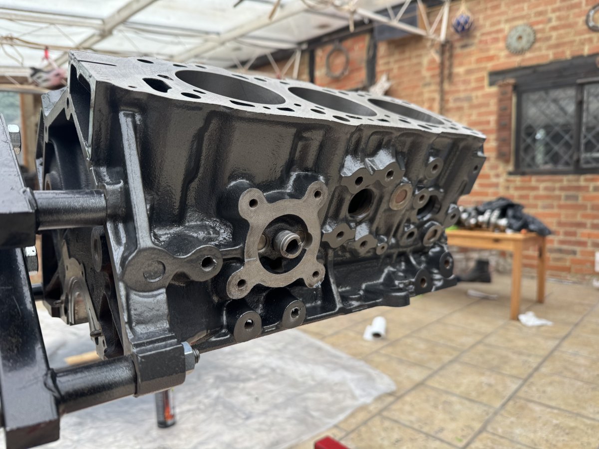

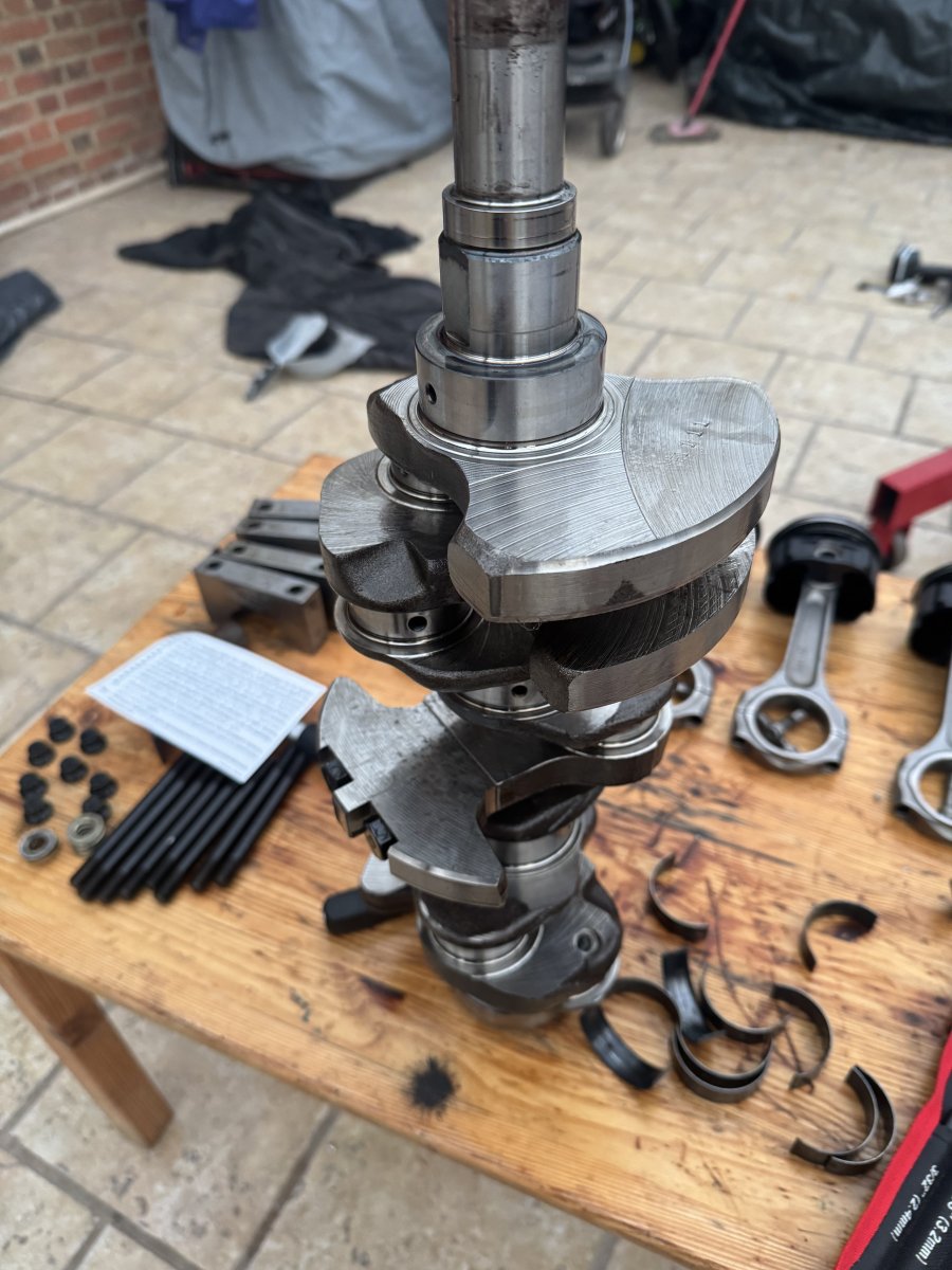

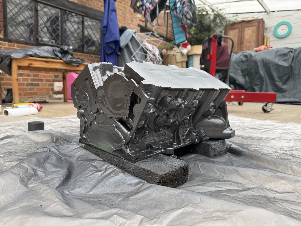

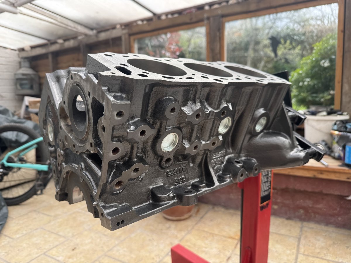

Take some time off work this week, so enjoyed the day cleaning and degreasing a variety of parts.

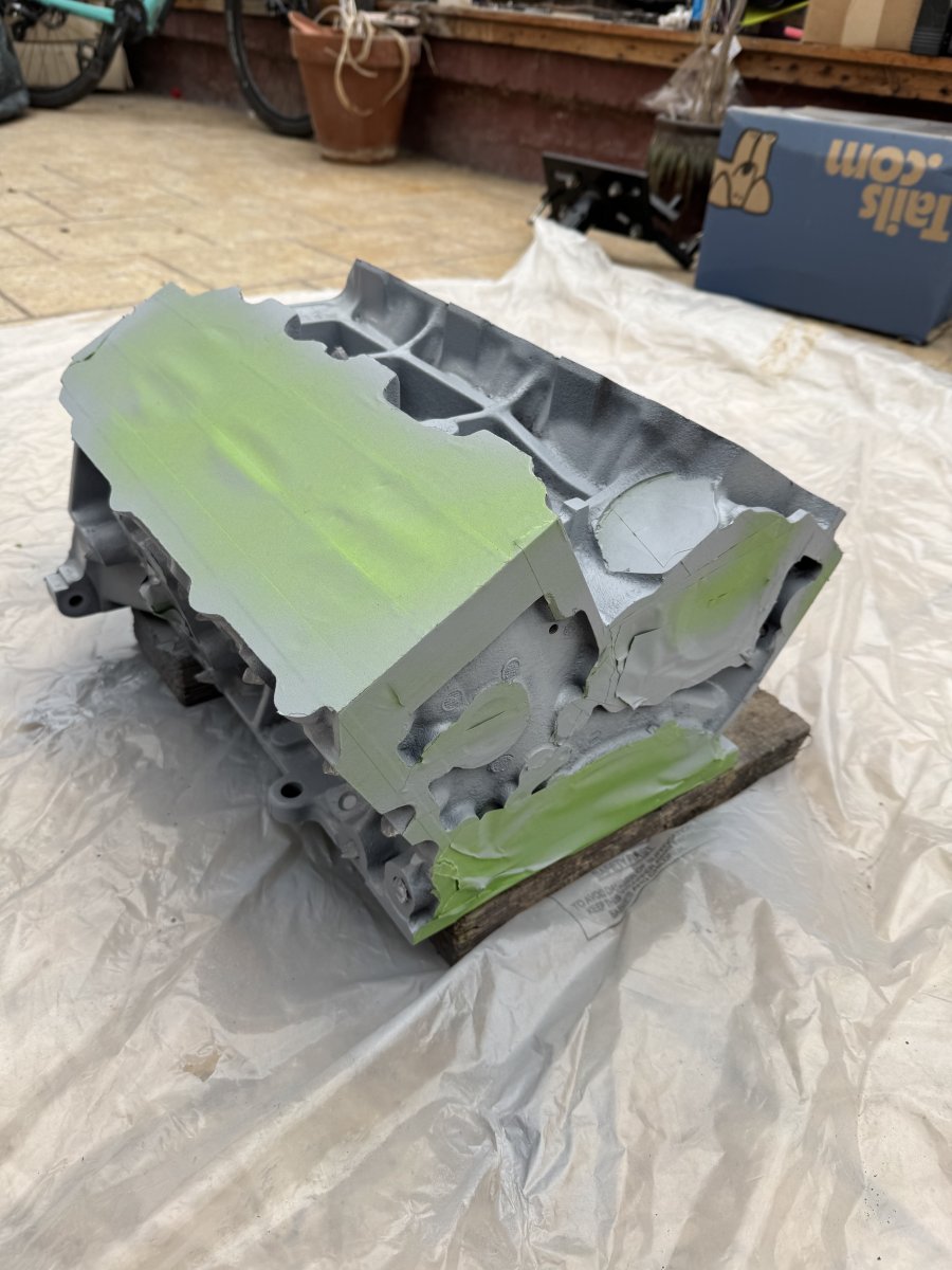

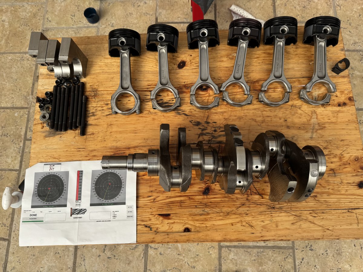

Engine block is now ready for painting (hopefully paint will turn up tomorrow). Donor Crankshaft cleaned up really nicely, and pistons and rods are also ready to go.
Bloody love Bilt Hamber Surfex HD degreaser, by far best commercial degreaser on the market in my experience!
