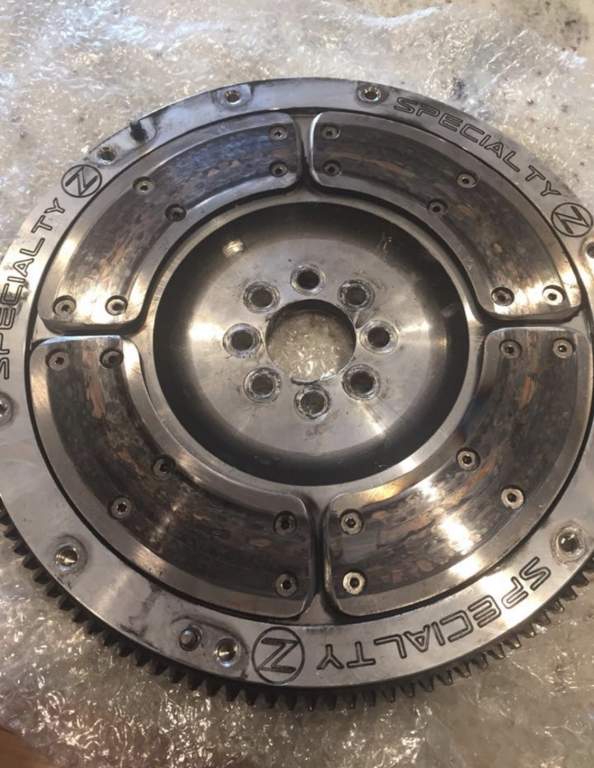

Yesterday I managed to source a second hand SZ segmented flywheel for a very reasonable price, which is now making its way to EPR. I may have to buy replacement segments for it, but even if I do, I’ll have made a decent savings over a new item

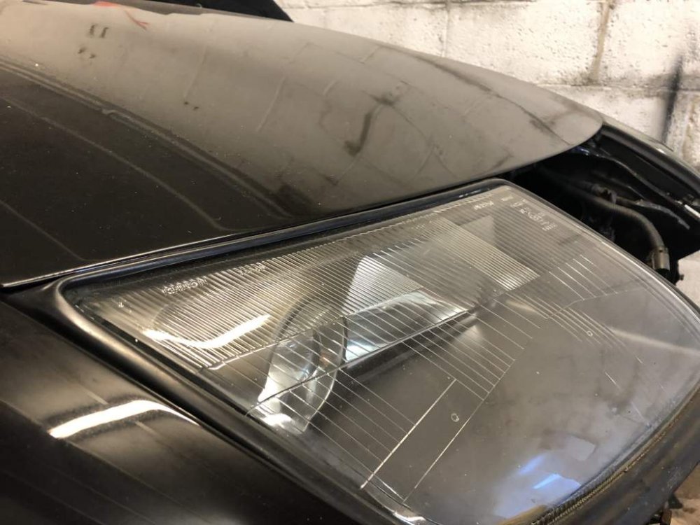

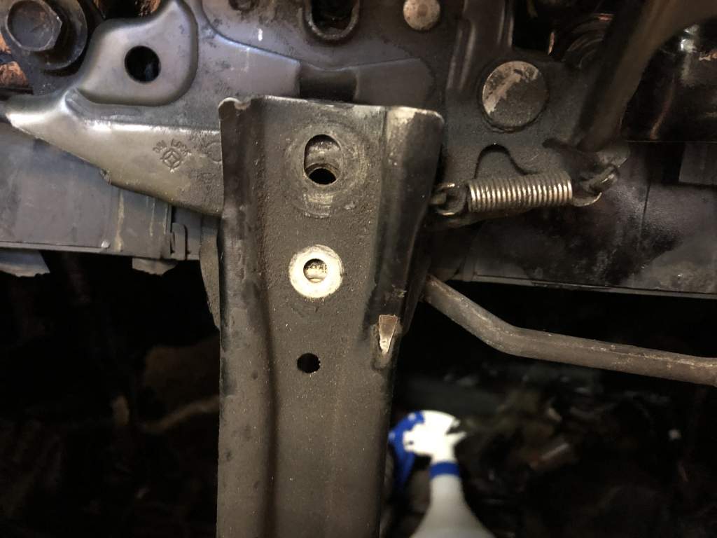

For the last couple of years, the bonnet panel gap across the front has lifted due to someone jacking the car up on the lower radiator support. You can just about see it in some of the pics of my car. The bonnet only sits a couple of mm proud of where it should, but to me it’s noticable...... devils in the details and all.
Having removed the AC condensor (which I’m replacing) I had a good look at the lower rad support. While there is some deformation on the underside, there was nothing apparent on the upper side. Infact it’s in pretty good condition with only a small amount of surface corrosion, which I shall treat.
I removed the 12mm and 10mm bolts that attach the brace to the bonnet latch, and gently pressed down on the upper scuttle panel until I got the desired contact on the headlight seals
With very little effort and a bit of tweaking of the bump stops on the scuttle panel, I managed to get the bonnet to sit where it should
I reinstalled the brace and inspected the bolt holes
I decided than rather go for the full surgery and try an massage the lower rad support, and potentially damage it further, that I’m going to elongate the holes in the support bracke, given I only need to increase the slots by about 5mm, I shouldn’t have any issue when I refit the new AC condensor.

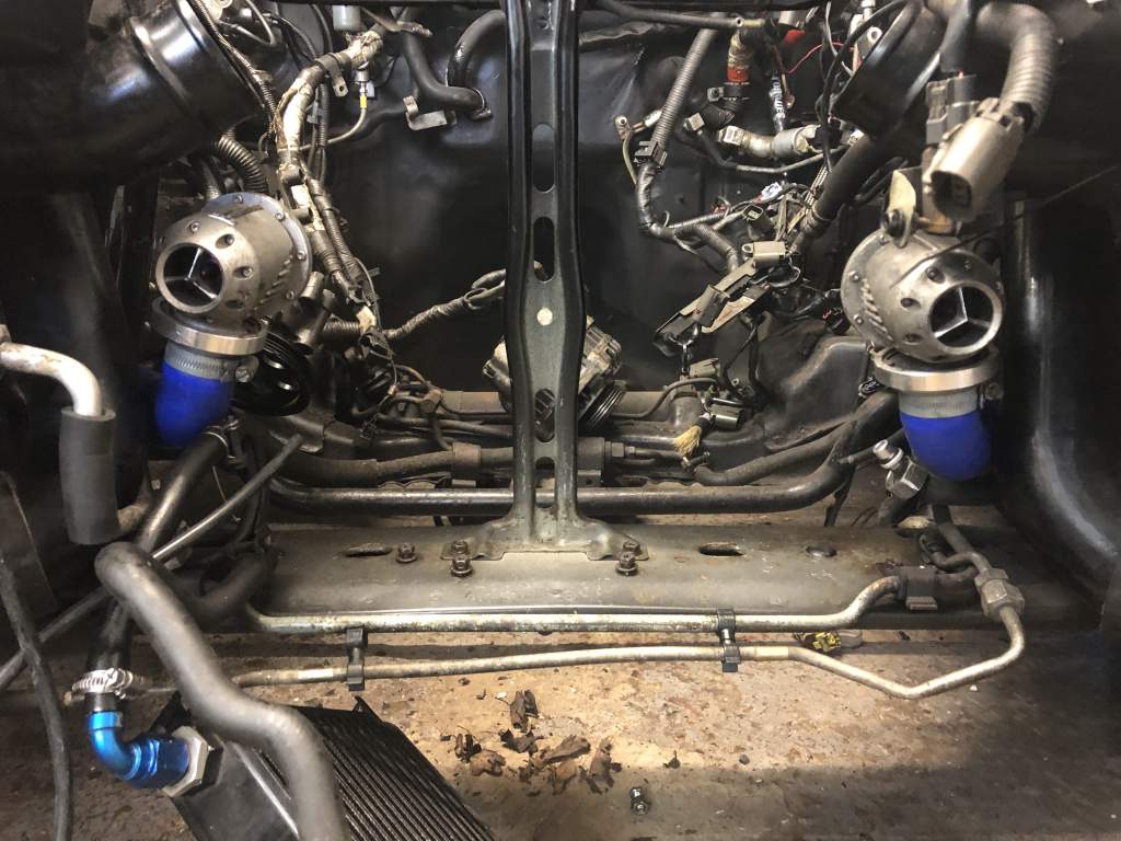

I’ve also decided that I want to improve the fitting of my HKS SSQV’s. When everything is in place, they kind of sit up along side the filters, but they have a habit of flopping around a bit. I’m going to have a bit of a measure and see if there is room for me to weld the bosses directly into the IC piping, where the port that the BOV’s are fed from. If not, I’ll have to try and maybe make a support bracket and some better suited angled silicon piping, just to tidy things up down there.

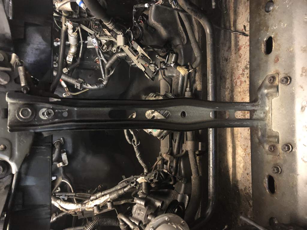

Bit more fettling today.
Test fitted the support bar for the scuttle panel. Now just need to sand back the surface corrosion, treat, prime and repaint.

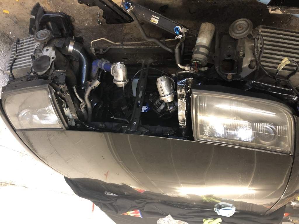

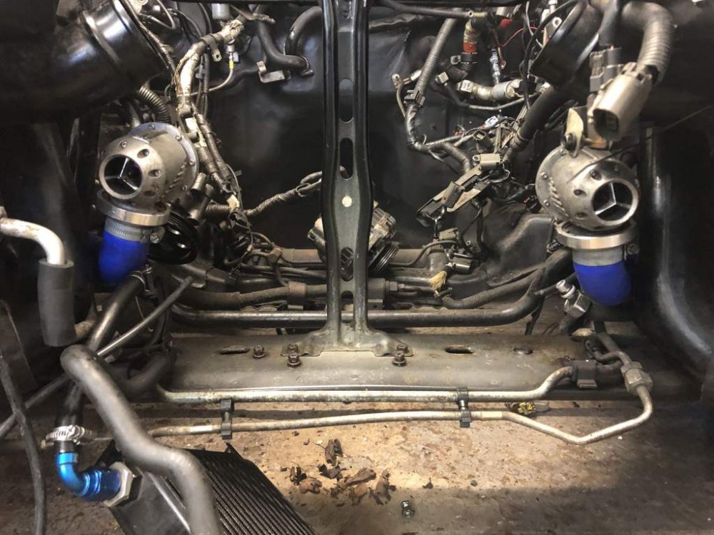

Also had a bit of a faff with the bov’s. I managed to reuse the silicon joiners that were previously fitted, but swapped them around to different angles, so they now sit like this
I refitted the auxiliary fan to make sure nothing fouled. Luckily everything all good on that front. Will have to wait until the AC condensor arrives before I settle on what orientation the BOV’s sit at. I suspect that sitting as they are in the pic, I may be too close to the condensor, so I’ll have to spin them round 90 degrees. I’m also going to order some new black silicon pipes, not a fan of the blue!
