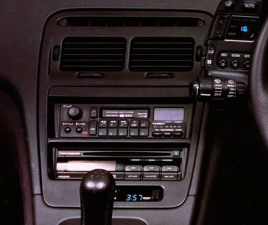

As your car is a series 2 UK spec it will have come with these units as standard:
The air filter box assembly is the same for UK and JDM (16500-40P00).
Thanks for the info guys and a great picture. I think the head units are going to be very hard to find.
[ATTACH=CONFIG]109497[/ATTACH]
Pretty sure this is the same as I have in my red uk zed:) and all works a treat

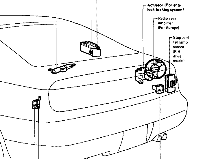

If you are going for the full stock audio system then there is a rear speakers amplifier located in the boot
under the trim panel on the d/s rear wheel arch. Allthough it is probably still there, worth checking that it was
not removed during previous aftermarket audio install. The UK spec stock radio headunit has a built in amplifier
for front speakers and line level outputs to rear amp and speakers.
