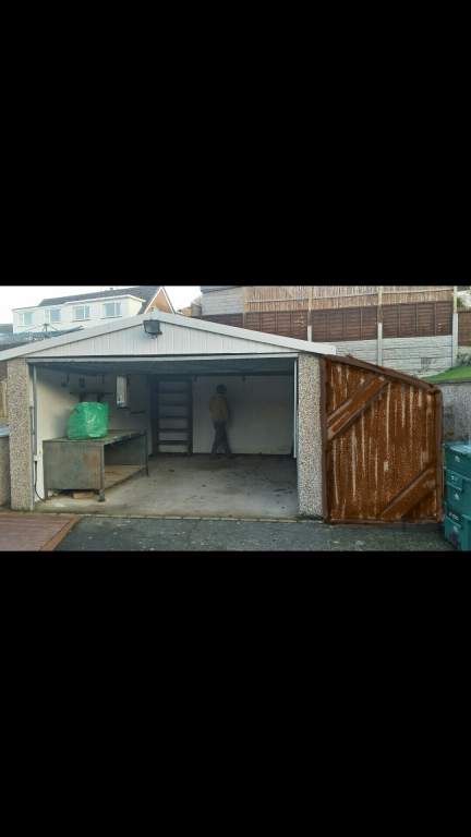

I have bought a house! With a bloody enormous garage 5.23m x 5.26m.

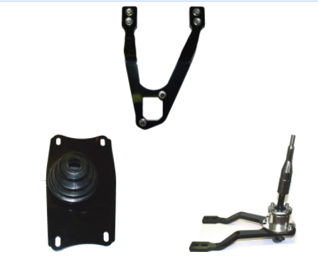

So, the plan is engine out, gearbox away for rebuild or a new 98 spec. I have the full compliment of shifter bits and pieces from Z1

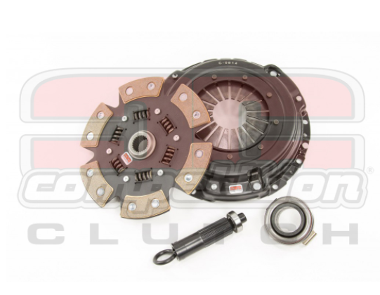

I am going to put a new friction disc in, because my clutch has done about 25'000 miles of enthusiasm and torque (very bloody well i may add)
Awesome product, and it feels like a normal clutch :lol: It is not as grabby as radio presenter from the 80s like people think they are.

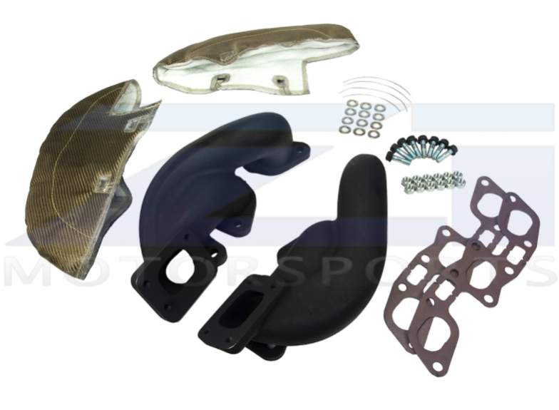

I will then pull the engine and finish my EGR delete which I couldn't physically remove. Clean it, and re-hose and re-loom it (again) as required. Clean up the engine bay and fit some of these...
OPINIONS PLEASE :)

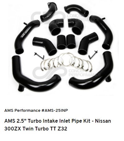

Mondo, I have these...

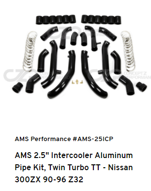

I will probably get these because the lower pipes are still acordion plastic... and I want 'more' potential for boost leaks :lol:

I would like the Ash Spec manifolds and the best divorced downpipes available. But the range on CZP/Z1 isn't as large as it used to be.
What do people advise? (Standard turbos and a Japspeed 2.5 inch downpipe back exhaust)
They look very similar to Z1's there isn't the choice there once was. The Labree units are discontinued by czp/z1 and I want to save on shipping so dont want to go to a 3rd place.
I may very well go for those. Any divorced unit is an upgrade and I could swap them the day the turbos die (hopefully in 2020 something)
I went for the AMS 3" expansion downpipes, Tom. A replica of the Speciality Z ones, but obviously cheaper.
Aside from a small tap from a hammer being required during fitting, I've had no issues whatsoever and they've obviously helped my breathing. :thumbup1:

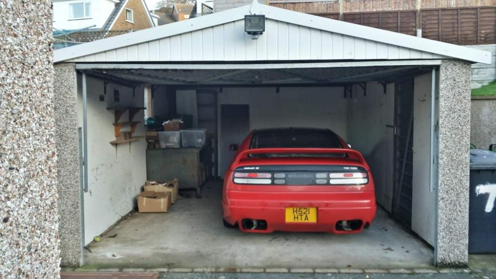

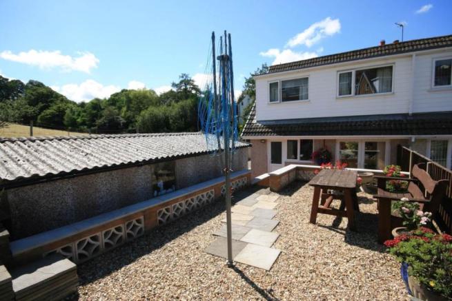

I now have a house!!!
I'm going to build an extension and paint the floor with hangar floor paint
Isn't it lovely :)
It has good electric lighting, that side door and it has a separate detached two storey living building :thumbup1:

Cracking garage aswell!

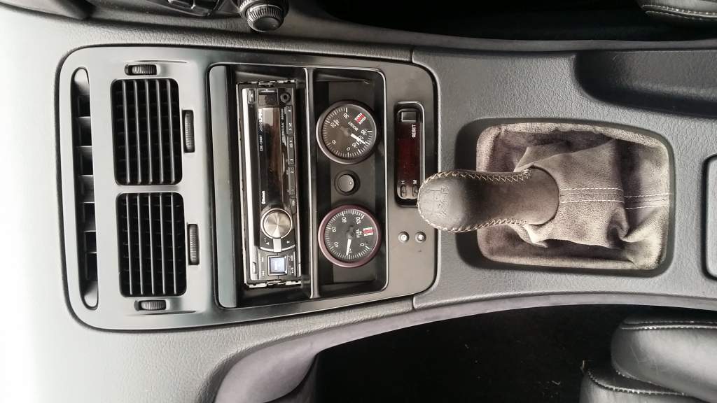

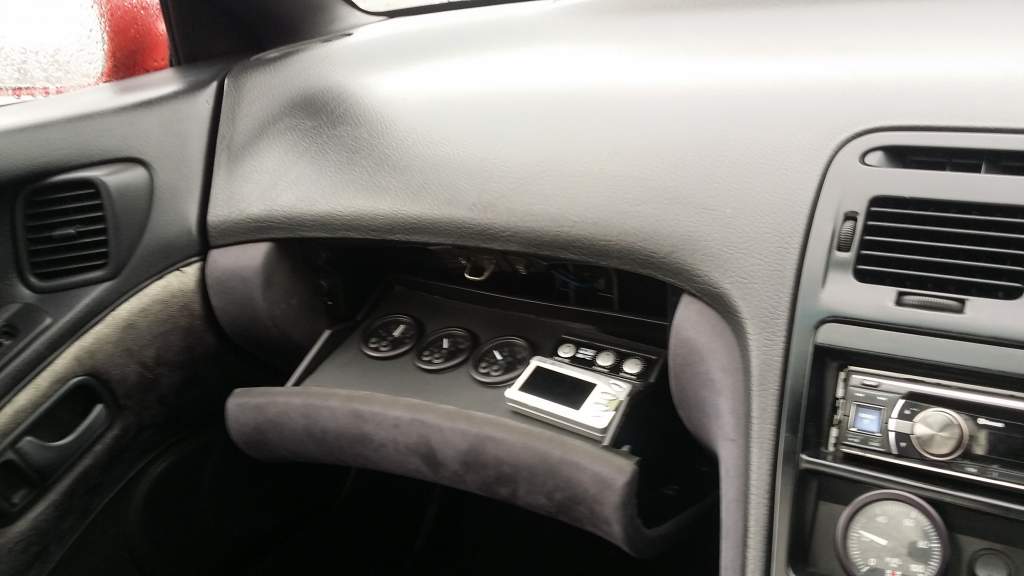

It's time to reveal my glovebox of fantabulous wonderment...
Look at that work of art, made with coat hangers hot glue and a bucket, just made really well by me :)
So the reason I bring it up, is that is my protection system. The gauges are Water temp, Oil temp and Oil Pressure. They go blue when low and red when high. They flash when they are very low or high and when all is well they go white. Low oil px is orange not blue. But even better, they link into the two LEDs that some soldering ninja has put in there!
One is blue, the other is red and when all is in limits they are both out. They are my master caution system, to make me open the engineer's panel ! I mean glove box :biggrin:
And the other two? Fuel pressure against boost. And no, they are not pissed, they are rotated so that at full throttle both needles go straight up and down like a little white 11 to glance at.
The switch between them is the gauge backlight. I love my car :):biggrin::)
