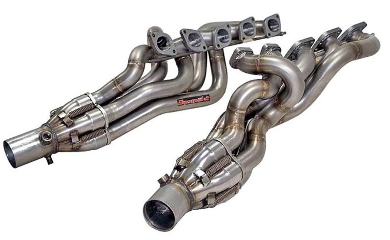

As title really, whilst looking what is available for the M6 exhaust wise came across these babies..... look a tad tricky to fit :ohmy:

Certainly a work of art.

they need mounting on the wall :yes:
But so worth it Jeff...

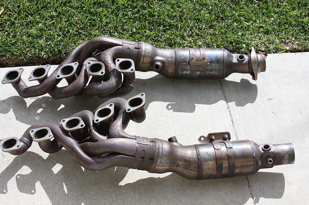

Stock BMW headers >>>

Do you need Dolmio bolognese sauce with that spaghetti?
lol

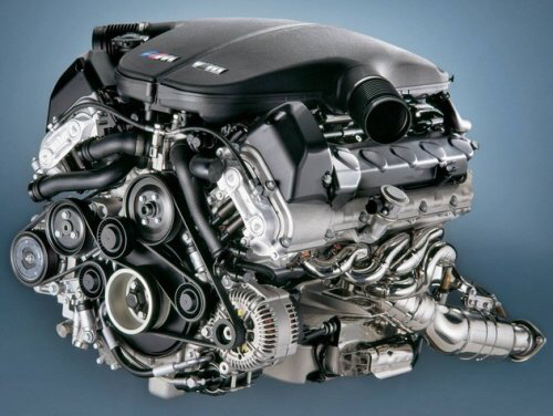

Headers fitted on engine >>> be tight in doing the change in the car..

Whats the Gains Jeff? looking at the BMW headers they look fine to me compared to run of the mill Cast Iron jobbies on most cars

Look good though - and what is the reasoning behind the little springs.....?
As a complete observational guess. I recon theres a pre cat in the stock ones. The runners are longer on the aftermarkets which iirc changes the power band to a more Top end focused delivery. Your right though, the stock ones are a world away from many other cars, the M6 was a bloody expensive car though I spose. Non M badge V8 models are quite affordable now, but not the same thing as the M.
The same as on many bike systems Richard..they hold a slip joint together (none welded) they can expand and move about without the cracking that thin walled stainless steel can bring :)
Cheers Bri - I might have guessed, but I'd never have expected that the joint would not be solid on such a beast of a car.....!!

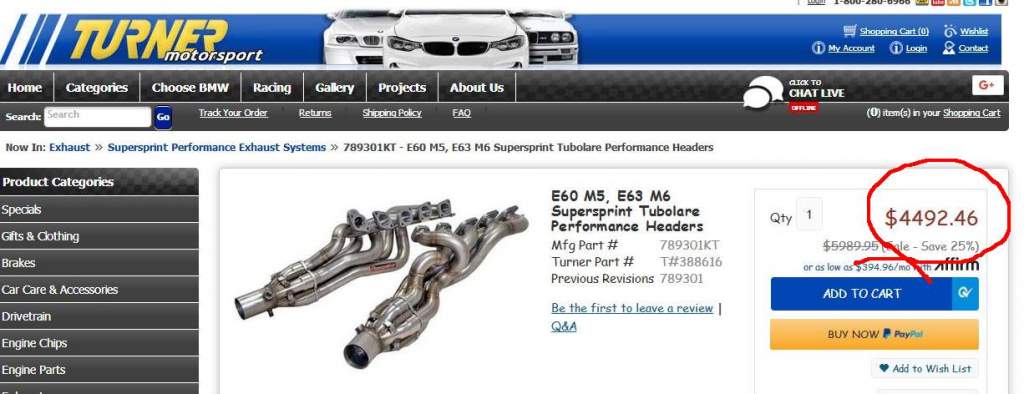

Flipping expensive >>>>

ouch:crying:
