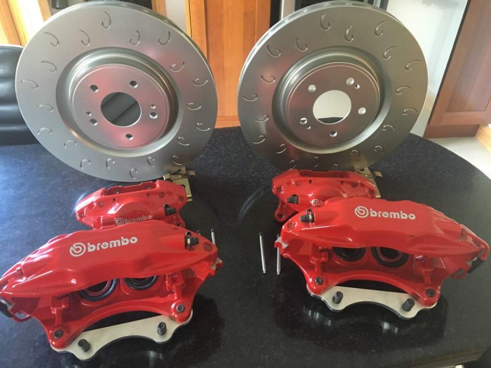

I've got some bought off mondo here, I removed them though.
One of the brackets needs re-doing and need new bolts. Come with Brembo discs that have plenty of life too if you're interested drop me a message mate.
This will give you an idea Lee, the brackets fit onto the calipers and in turn the brackets bolt up to the original mounting points on the hubs, this "relocates" the calipers further back, allowing bigger discs.
These are Evo 8 calipers, they work with 350mm Evo X discs:thumbup1:
