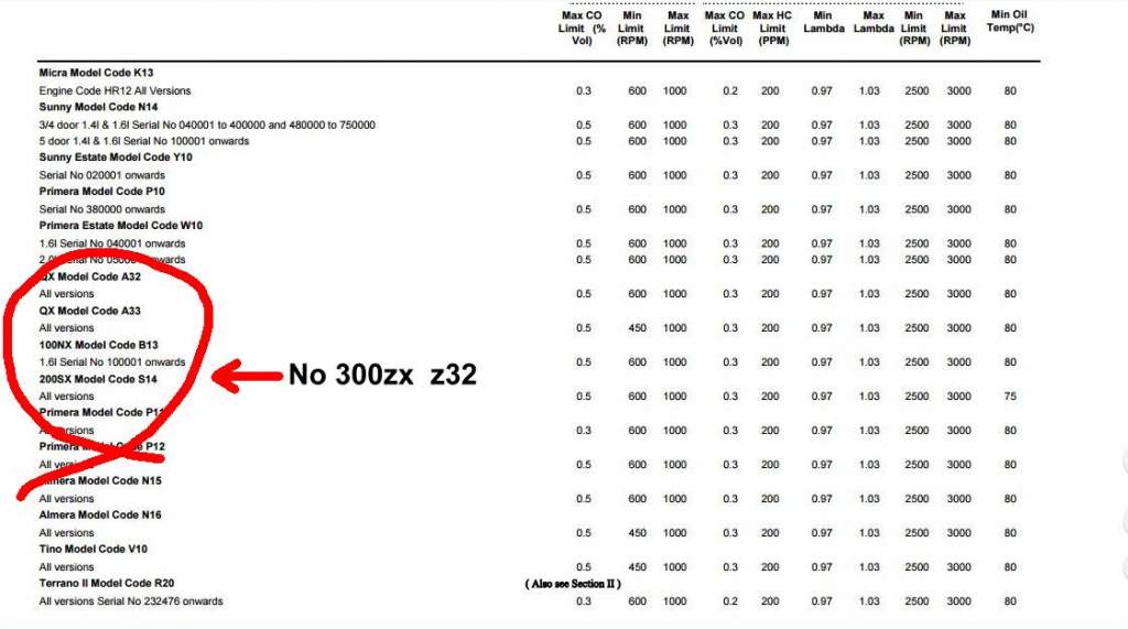

Reply from VOSA when asked to clarify the position, having personally taken hundreds of zeds for MOT testing over the years I can confirm the following seems to be about as accurate as you can get, there is a valid argument to be had when some testers will just do a full cat test if the car is registered after August 1992 without checking the rules ie
"If there is not an exact match in the Emissions book, then the vehicle will be subject to a non-cat emissions test "
we know and can see from the link / picture below the 300zx Z32 no longer appears on the data sheets, be aware that some testers even confuse the z33 350z and it is highly doubt full the average 300zx will pass that test, worth printing off the section from the VOSA site and taking it with you for MOT if you want to decat or even if you have a post August 93 that is running a bit high on emissions ( not unusual for infrequently used cars ) the text in red really is the key point.
VOSA
Spark ignition cars first used on or after 1 August 1992 are subject to a Basic Emissions Test (BET) regardless of whether a catalytic converter is fitted or required. In the event that the BET is failed, it becomes necessary to reference both the MOT Inspection Manual, Section 7.3 and the In Service Exhaust Emission Standards for Road Vehicles publication (Emissions book). The MOT Inspection Manual is available on-line at http://www.motinfo.gov.uk/htdocs/ and the Emissions book at https://www.gov.uk/government/uploads/system/uploads/attachment_data/file/194133/Emissions_17th_Edition.pdf
For vehicles first used between 1 August 1992 and 31 July 1995, if there is an exact match for the vehicle in the Emissions book, then a full cat test must be carried out. Where this is the case, the vehicle must have a catalytic converter fitted or it will fail, regardless of the result of the emissions test.
If there is not an exact match in the Emissions book, then the vehicle will be subject to a non-cat emissions test (two gas test). Where this is the case, the vehicle is not required to have a catalytic converter fitted for MOT purposes, regardless of whether one was originally fitted.
