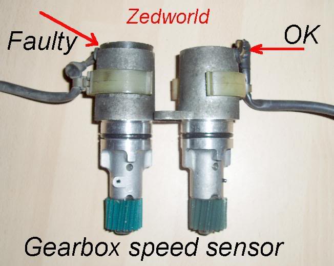

If it's JDM has the speedo been converted to rum in mph ? if so the chip could be faulty or it could be the speed sensor on the gearbox

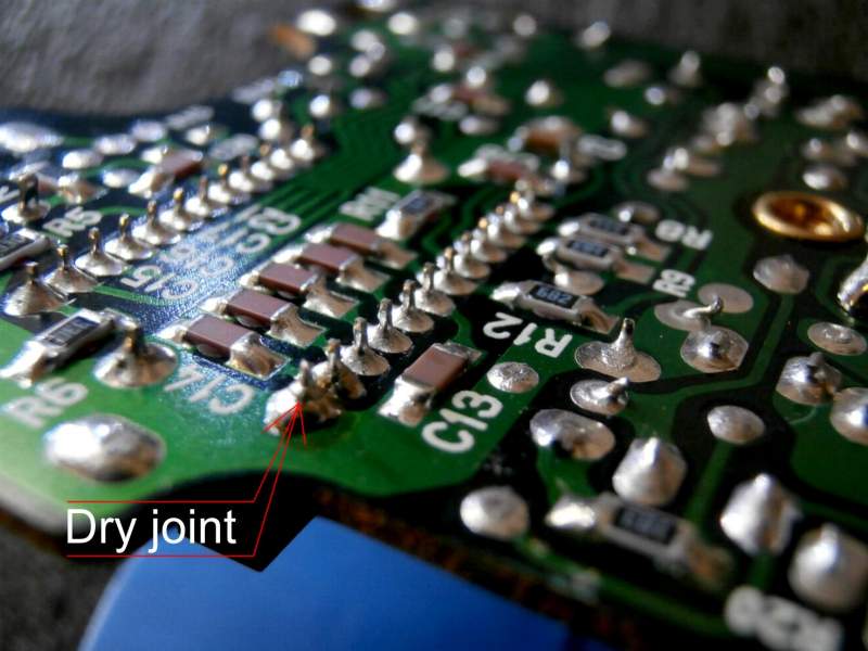

I took the cluster out last night and pulled the speedo needle back to 0 manually then took it for a drive and it came on after 25mph but was jumping then was ok then not registering etc so I am thinking more and more it may be the cluster
Maybe a dry solder joint then

if its either a faulty speed sensor on the gearbox, bad cable if it still happens and if it doesn't happen
after a clock swap then its likely a dry joint on one of the parts of the clock.

Sorry that you're having trouble with the speedo. I had trouble with it a few months before you bought it, but I managed to fix it (or so I thought...) by resoldering all the joints on the back of it. It did work fine again after that! But that's gutting if it's gone again, I'm really sorry! Anyway, I'm pretty sure, based on that experience, that it's the speedo itself at fault, as opposed to the gearbox sender. Maybe my resoldering of the bad joint (none of them were visibly bad) was a bad resoldering... Maybe worth trying it again... if you had the time...
